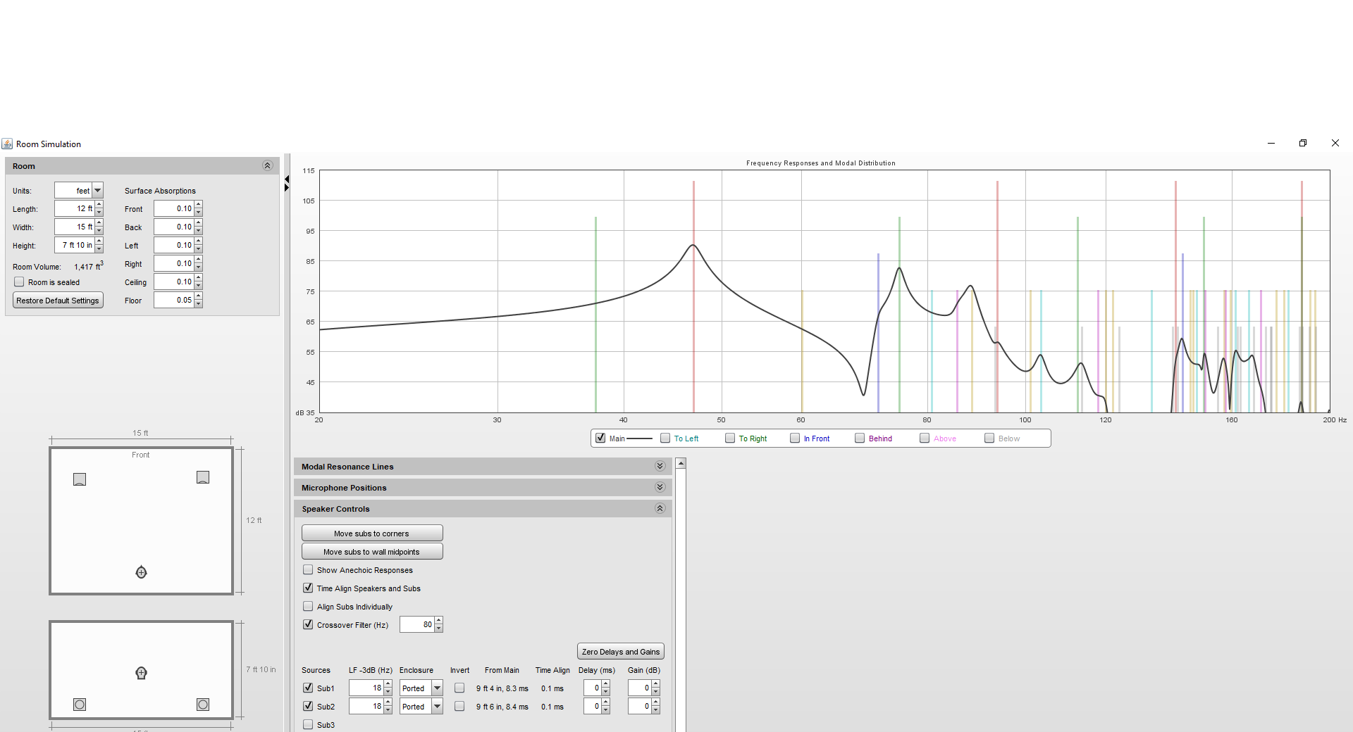

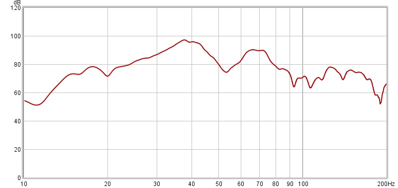

Here are some room simulation and actual measurements! Seems to fit with a little shift considering that the room as a bit of acoustic treatment and couches.

Nice ! Extension into the low teens !
You using a UMIK ? Although they're calibrated down to 10Hz, mine seems to go out from 12Hz downwards, not sure if this inaccurancy of the mic, or low frequency transmission through mic stand / mic itself as opposed to actual acoustic sound pressure measurement.
I'm using the ECM8000 from Berhinger, REW and the Calibration file with a flat system curve calibrated in loopback. I usually place the mic ona small tripod in the headrest of the couch. I'm assuming it is well isolated from the floor but it is possible that there is some resonance with the headrest. I could roun some tests with different materials for isolation. I think my biggest problem is my room, I should turn everything 90 deg. but the door would be behind the seats and they barely fit the width so no space to pass en the sides... 😡

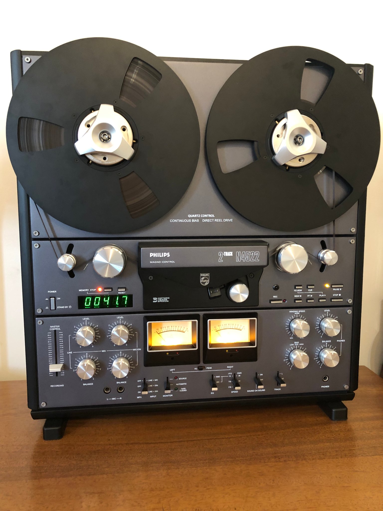

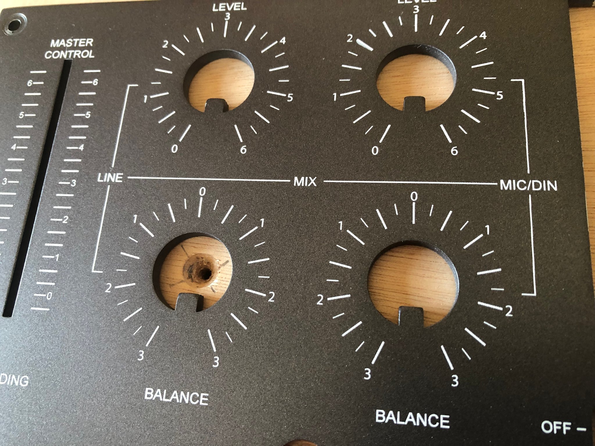

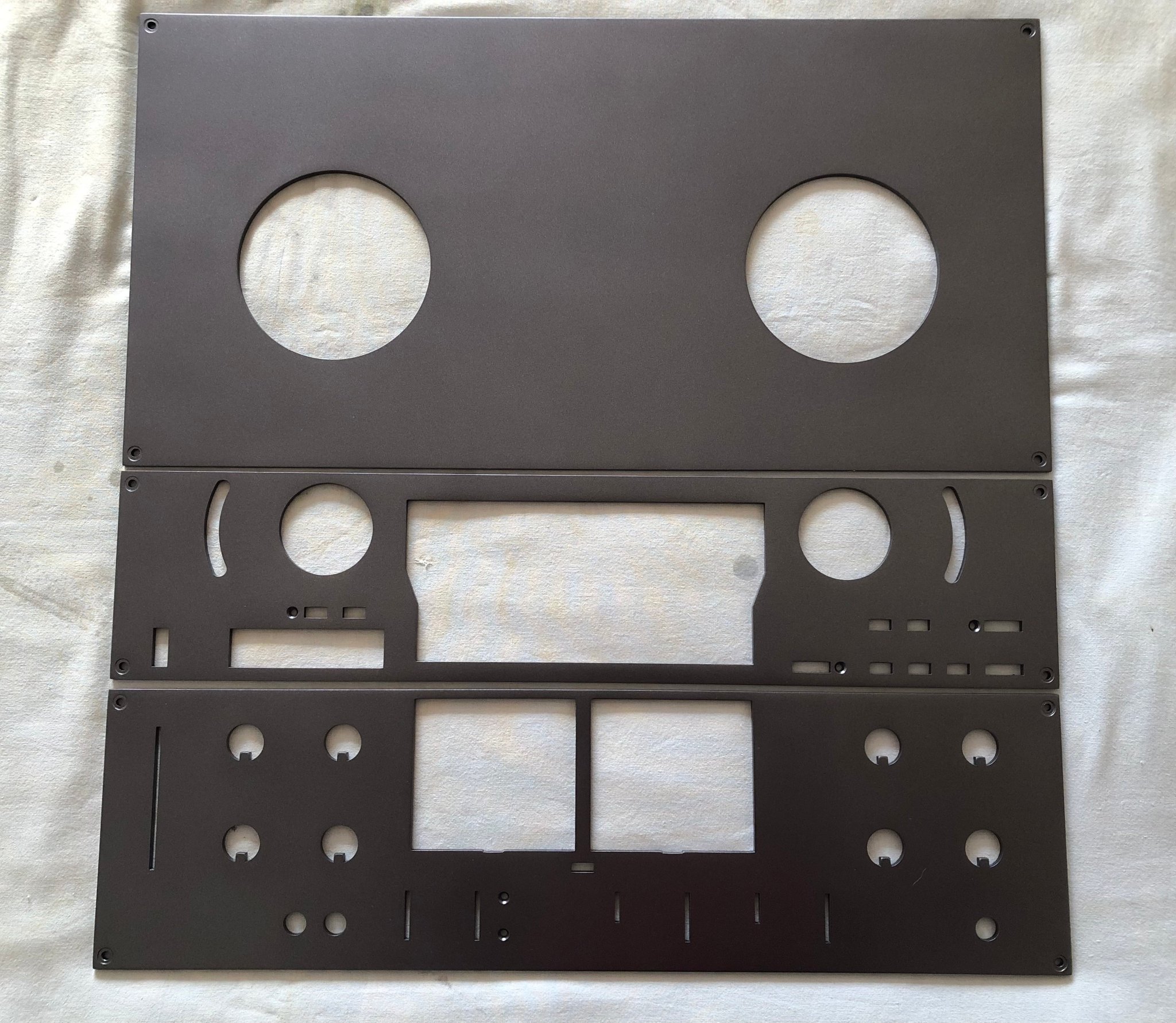

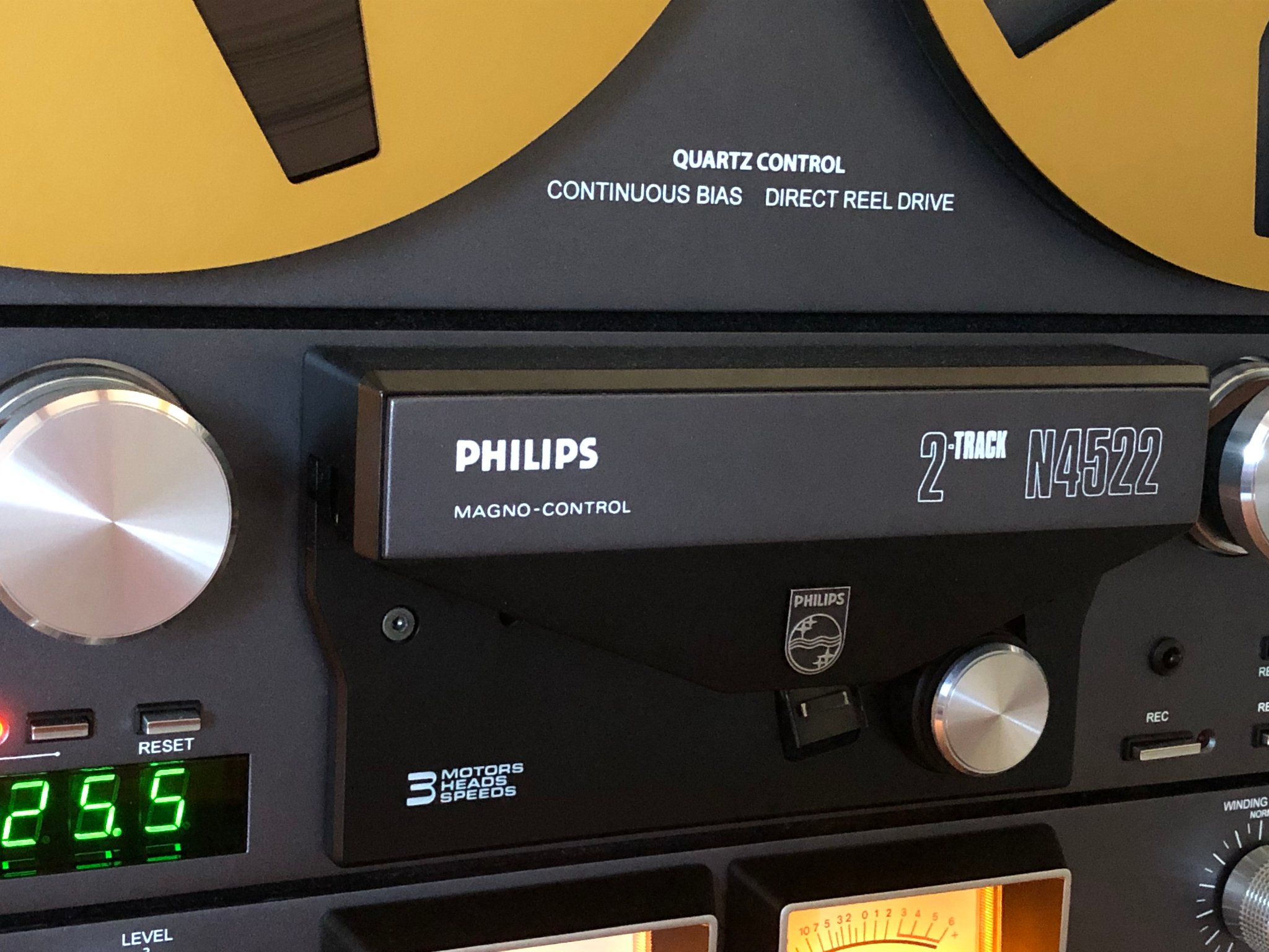

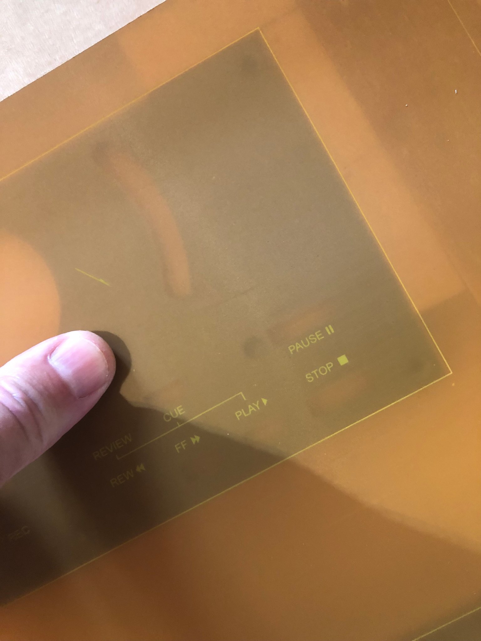

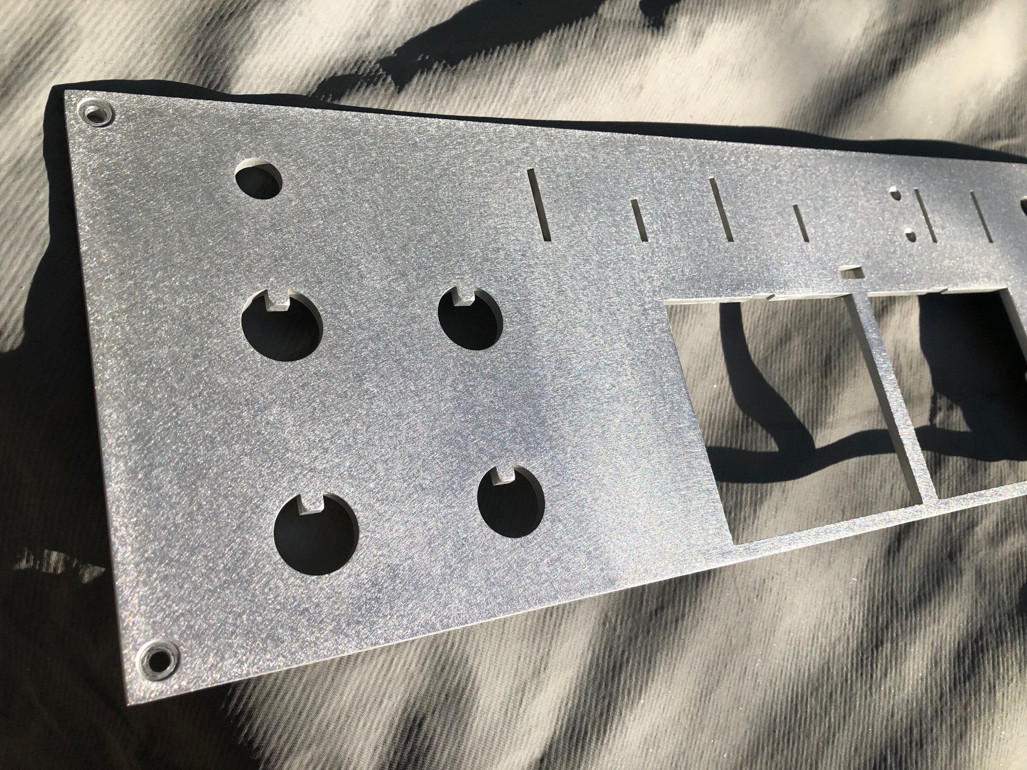

Hi folks,
I have been working in my home theater to replace the Martin Logan Dynamo 1000 sub with diy ones. After a bit of reasearch, I settled onthe Dayton Ultimax UM15-22 which are 15 inch dual voice coil 800W drivers. I have a couple of friends that have pro power amps and I decided to go with a Crown K2 because it has no fan which is great for HT use.
I found a K2 amp in a pawn shop for a good price, but it needed a bit of love so i stripped the electronics and send it for a powder coat. I was not able to take of the face overlay sticker withouth damaging them so I redid the layout and laser engraved some durablack sheets to replace the stickers. After seeing that my friend wanted to do the same so we did the same treatment to his but wil silver stickers. See pictures attached!
Afterwards I ran some simulations with winISD to compare the Sealed vs Ported enclosure. 9cu ft ported tune at 19Hz vs 4.5 cu ft sealed enclosure. It obviously the sealed showed a more promessing response... but what the heck... let's build them both and see how they compare in the real world!
So i did just that and was surprised to see how the results are close to the simulations! The ported enclosure (9 cu ft), although twice the size of the sealed (4.5 cu ft) one, won the contest hands down. The bump arount 45Hz is my room mode that I haven't treated yet...I just need to build a second one and finish them up.
So there it is, hope you enjoy!
