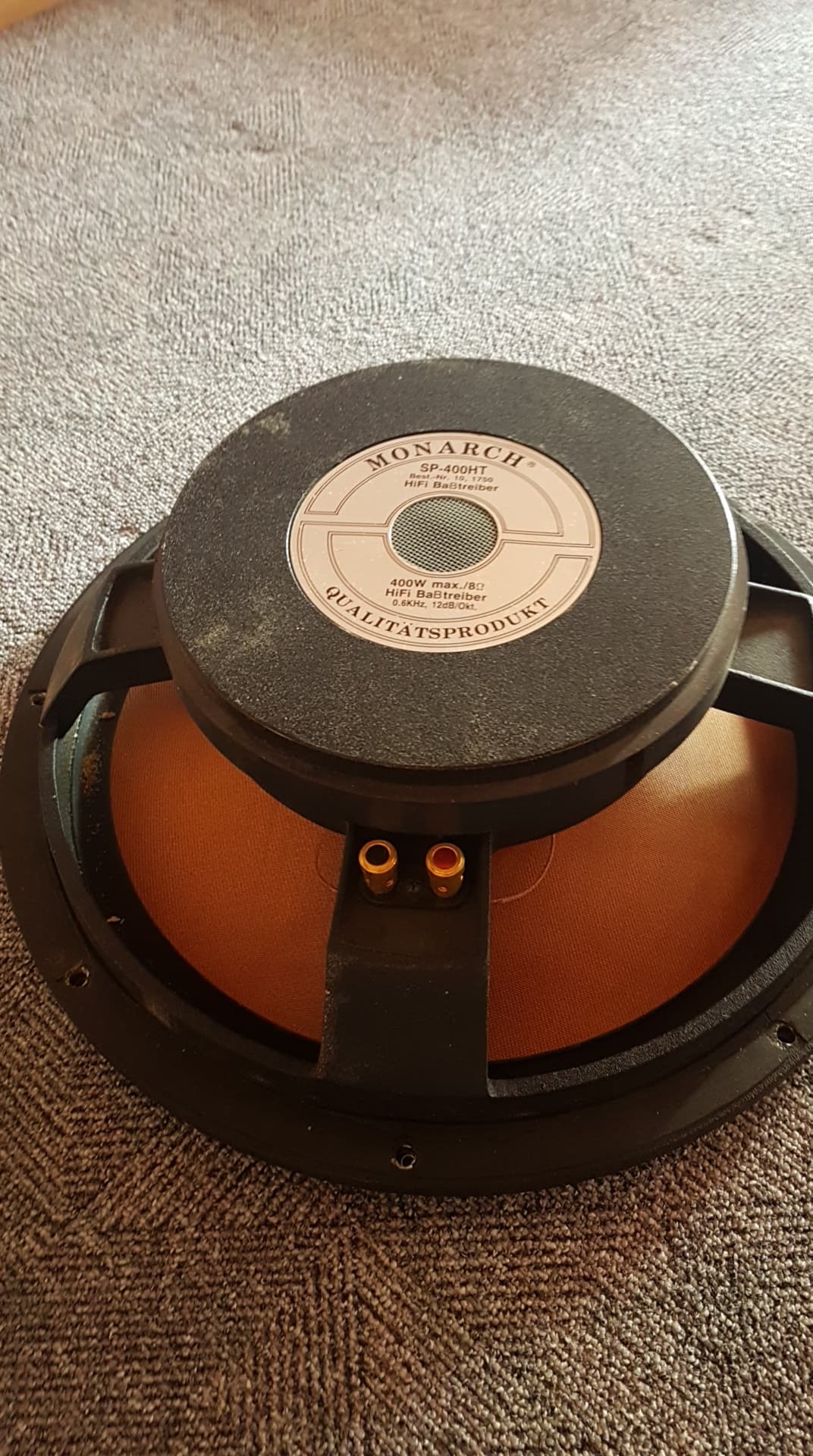

I have a problem in that i am trying to create a sub enclosure for an SP-400HT and can't find a lot of info. The info that i find, i don't know if it is correct, but is as follows:
Impedance: 8 ohm
1 W / 1 m: 98 dB
fs: 21 hz
Vas: 410 l
Qms: 6.55
Qes: 0.25
Qts: 0,24
Re: 6,4 ohm
Sd: 855 cm²
Le: 1,6 mH
Rms: 1,7
Mms: 85 g
B * l: 16.9 Tm
When i give this in winisd, i get an enclosure of around 100L but the -3db is above 50hz 😱
Right now it is in an old enclosure i made when i was a teenager, around 140L and two short big ports, really not optimal, but it was on a serious budget 🙂
But it plays... not bad, and certainly lower than 50hz -3b, it goes down to 30hz pretty easily.
Maybe this is a sub made especially for PA and thus doesn't get really low?
I was wondering if someone with more knowledge here could help me out, thanks in advance! 🙂

The Qts is a little on the low side, but you should be able to use a bigger box and tune lower to get more LF extension.
Going too far results in a peaky alignment, but a gentle slope down before the LF rolloff is okay.

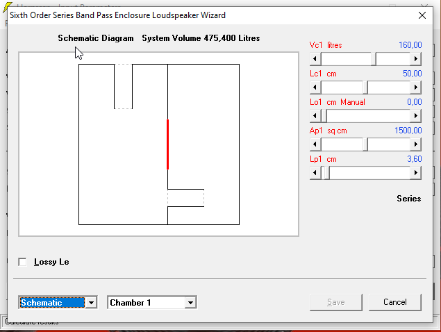

Thanks Chris for your reply, how big would you go on this without making it too "laggy" and inefficient? Size is not really a concern, i have a decent sized room for it.

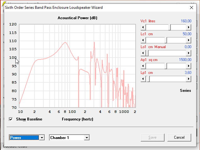

If you got room for a large 6th order bandpass then this would give you 97 dB/w/m response at 20 Hz plus room-gain (which can add upwards of 10 dB under the right conditions). The large midbass peak will compensate for the increasing room gain in the deep part of the bass spectrum, and it will add a good physical punch to all midbass. Great for hometheater explosions and such.
An adventure with 8th order BP
Se Grecs build in the thread linked to above for a possible layout.
Thx Circlomanen,
My experience with bandpass is somewhat limited, but i was under the impression that it is somewhat laggy and, as you said, peaky on a specific frequency, making it somewhat boomy.
But I will certainly look into this 🙂 thanks!
Is it possible to not have this delay when dealing with bandpass? and the reason you don't see many commercial bandpass systems, does this have to do with its size?

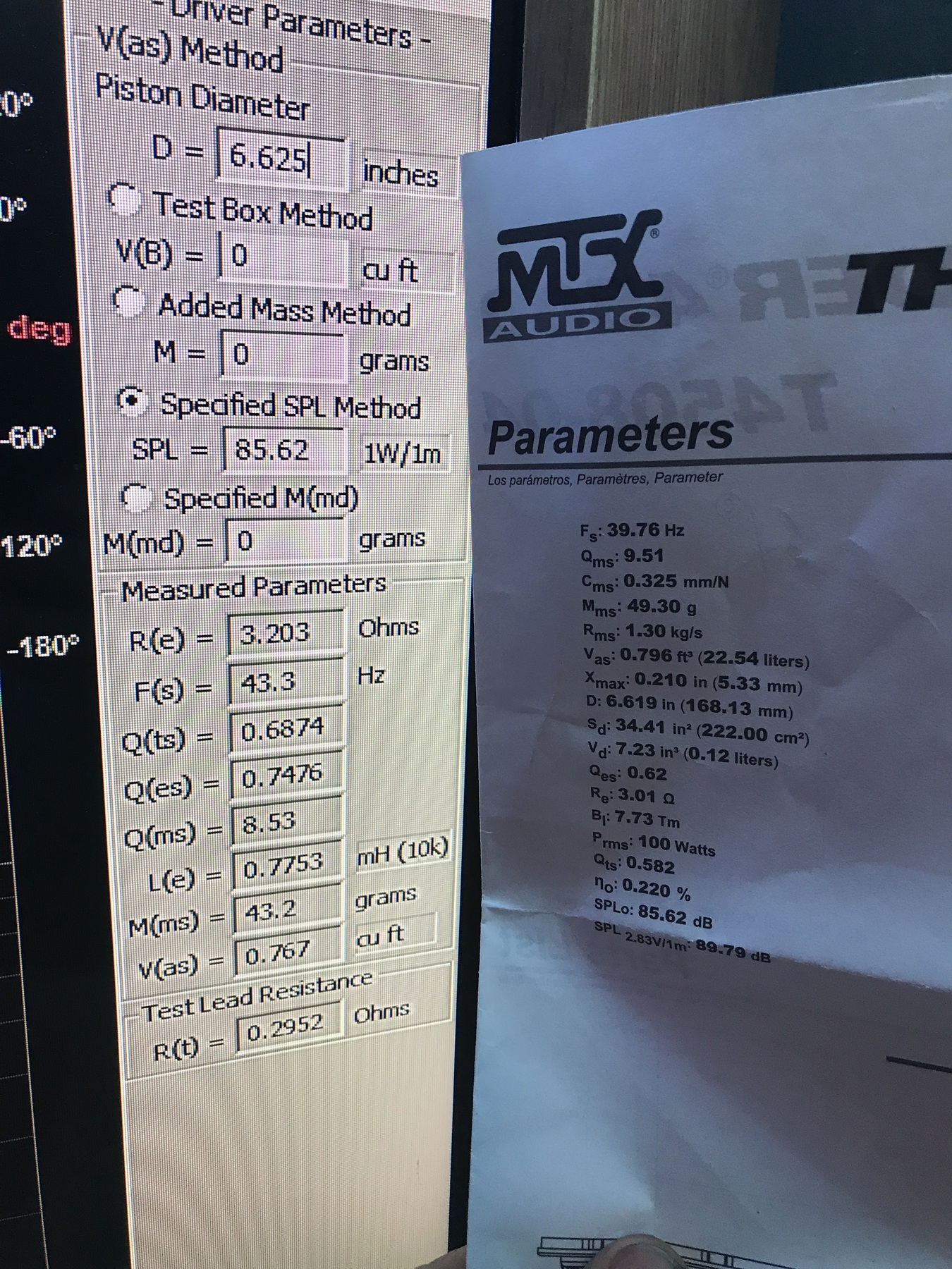

Hi Steven, all
Your numbers, T/S parameters don't make sense. From where did you take them? To light a cone(?) and a very low frequency and BL don't seem correct. Actually there must be a problem with fine measurement of the t/s parameters for a correct alignment and dimensioning.

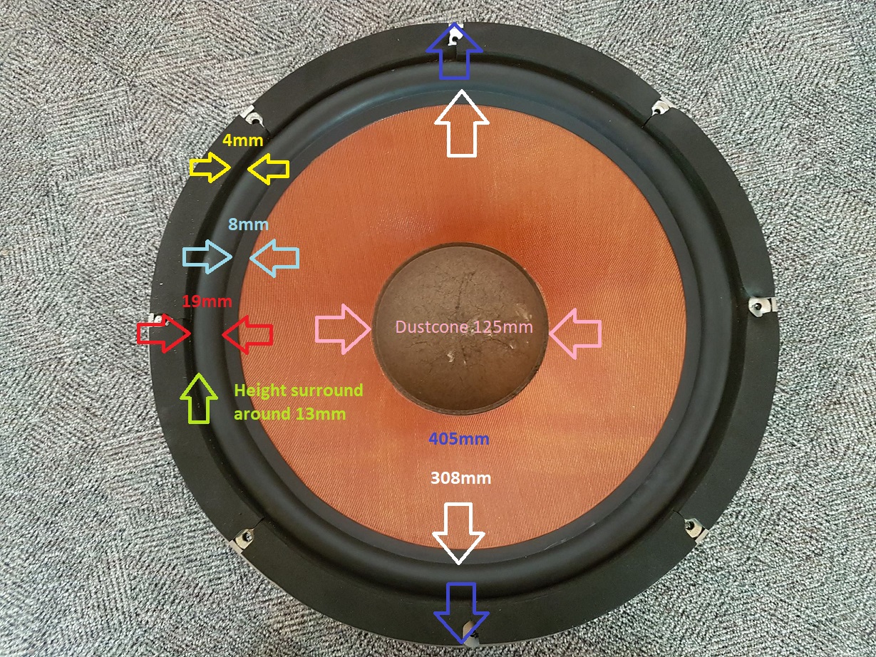

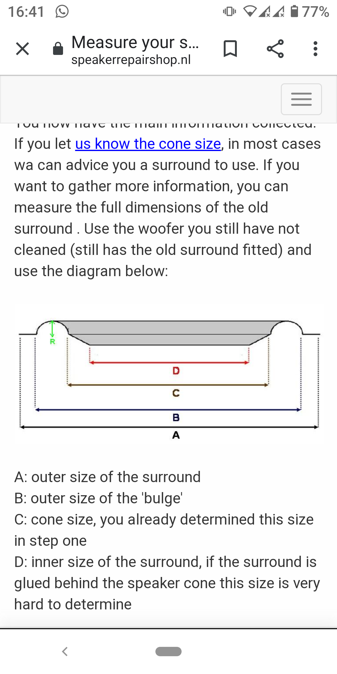

Hi Inductor,

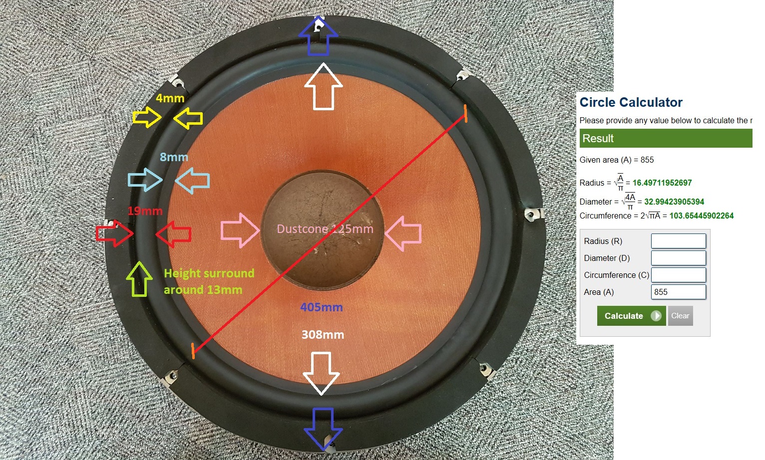

Do you want me to measure the height of the surround? Thats what that R looks like to me.

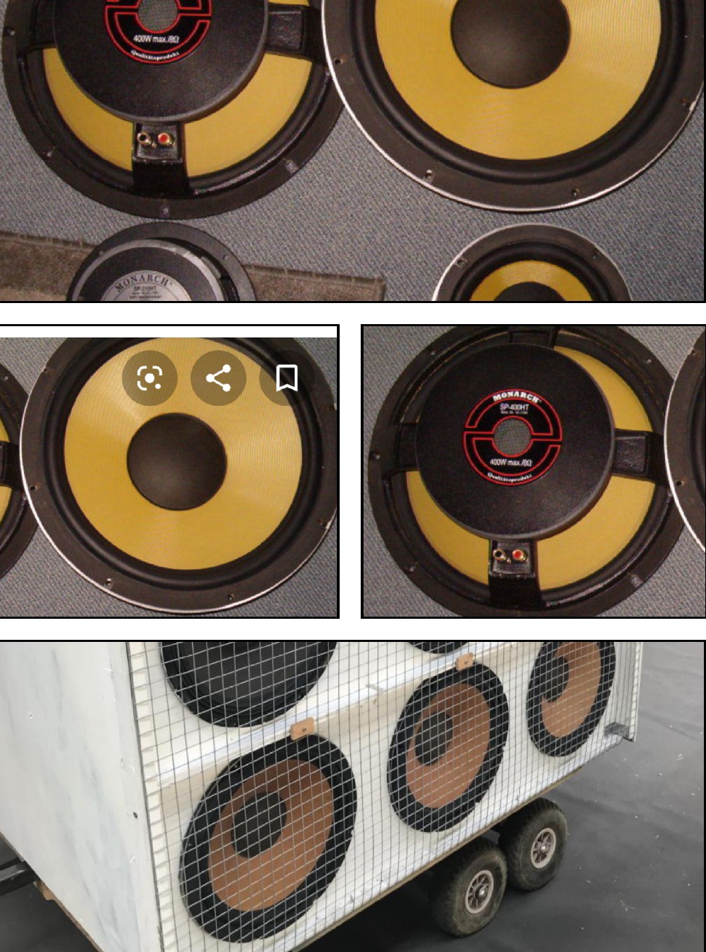

Also, i took them from a german forum somewhere, i might be able to find it again. Also there it appears there are 2 versions of this woofer, the ones in your attachment don't match mine. Mine is more orange, not yellow, and the back is different sticker. I made an attachment with picture.
@BP1Fanatic, yea will do! thanks 🙂 I guess latency doesn't really matter that much for movie content 🙂

Hi Steven, all
Give a fast check on diameter from "R" to "R" middle (green line) of the diaphragm.

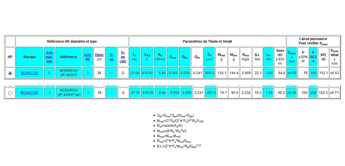

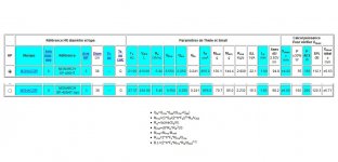

Right you are! 😉
In the same thread as those posted above: Boxenvolumen, Unterschied von 30 Liter was stimmt nun?, Lautsprecher - HIFI-FORUM posts # 7, 8:
From a 1999 Monacor catalog and at least closer to reality based on Mms, BL in that they line up near enough perfect with T/S, though with a very low 760 cm^2 [Sd] [typo?] makes me wonder if it's the same driver, so agree for the need to check [Sd] :
Diameter size in inches 15
Diameter size in centimeters 38.1
Z - Nominal Impedance in Ohms 4
Fs = Free air resonance frequesncy in Hz 39.8
Qts = Total Q Factor of driver 0.3525
Vas = Equivalent acoustic volume in cubic feet 6.3
Vas = Equivalent acoustic volume in liters 130.4
Xmax = peak linear displacement of cone in inches 0.2
Xmax = peak linear displacement of cone in mm 5.08
Pe = Max power in watts 825
Ref = Driver's SPL 1W at 1m in dB 96.9
SPL = The half-space ref Efficiency 96.9
Voice Coil Diameter in inches 2.5
Mounting Depth in inches 6.5
Sd = Piston Area in sq m 0.076
BL = T * M Flux Density, Length Product 16.73
no = The half-space ref effciency 0.0217
Cms = Mechanical suspen Compliance 158.944
Mms = Mech mass of cone & free air load
100.399 Qms = Mechanical Q factor of driver 8.314
Qes = Electrical Q factor of driver 0.3681
Revc = DC Voice coil resistance in Ohms 4.1
Zmax = imped At top of resonance curve in Ohms 96.653
Fo = Free air resonance frequency in Hz 39.841
Magnet weight (oz) 180
Magnet weight (kg) 6.3297
Frequency response range tested from 20 -2000 Hz 20-4000

Thanks Inductor for your time on this 🙂
So in the second piece are the correct numbers you get with my measurements.
Is there anything else i can do to make this more precise, what data can i provide? 🙂

Your measurements should be pretty fine close to the originals it gave me about Sd: 840 cm². The same original numbers should be used by the persons that measured the first time and the second time to give the same results that I doubt so far, then Sd: 855 cm².
After all this is the only measurement we have that was verified and checked...
The second one was an impedance test/measurements and also then T/S parameters.
