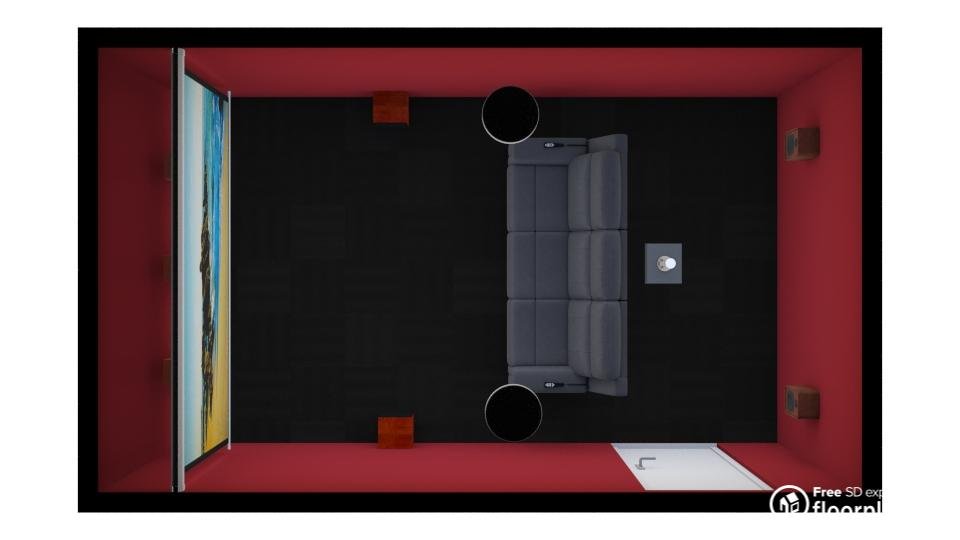

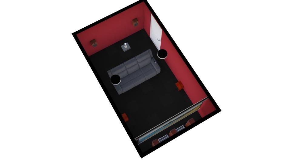

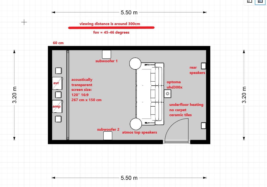

Thanks for your message. I tried to draw a scaled sketch (attached to this message). I am planning to put the electronics behind the AT screen (either at the center or close to near walls, it doesn't affect my viewing experience so no problems there). Ceiling is a hung-type (dont know the term) by gypsum boards; filled with rockwool in between the concrete and gypsum boards (net height is 230cm).
As you guessed, there is a projector (optoma uhd300x) just behind the main seating position. Like yours, mine will be a 5.2.2 atmos system (7 speakers and 2 subwoofers placed around the middle of the room); or perhaps I will use 7.2.
I was using wharfedales but they are not anywhere close to strata minis, both in audio wise (what I hear) and frequency response wise. I have a umik-1 and REW and will utilize it to try the acoustical treatment within the room after setting up the system. Besides, rotschilde speakers are really musical and I enjoy the sound of them immensely. I was thinking to use strata minis and rothschildes in different parts of the house and planning to use visaton combinations or tcdfd drivers in the home theater, but don't know which enclosure to build for home cinema usage.
Among other things, ceramic tiles on the floor would be another problem. I do not want to cover them with a carpet since there is underfloor heating and Ankara is cold in winters.
So, after re-thinking, I believe I am after a design for visaton combinations or tcdfd drivers...
There will be a projector (optoma uhd300x) just behind the main seating position. Audio signalling will be a 5.2.2 atmos system (7 speakers and 2 subwoofers placed around the middle of the room); or perhaps I will use 7.2.
I was using wharfedales but they are not anywhere close to strata minis, both in audio wise (what I hear) and frequency response wise. I have a umik-1 and REW and will utilize it to try the acoustical treatment within the room after setting up the system. Besides, rotschilde speakers are really musical and I enjoy the sound of them immensely. I am thinking to use strata minis and rothschildes in different parts of the house and planning to use visaton combinations or tcdfd drivers in the home theater, but don't know which enclosure to build for home cinema usage.
I would like to get your opinions around what to do for LCR speaker setup.

You could use the visaton full ranges for rear and center. Since you have 7 use 6 of them in pair per speaker (x3) for instance 50x30cm front baffle and 30cm depth giving 45l large boxes plenty of power for the use.
Secondly those subs I don’t know. Look like car subs. I’d find something else and put also them behind the screen with the mains and center.
What what is going to be your mains is the real question to be honest.
What’s your budget. What’s the plan for electronics.
Room layout is a bit tricky too.
In my opinion all speakers should be the same type.
I’d build something similar to 5x Klipsch Heresy + 2x15” sub and you will be happy for the rest of your life.

I still feel like in a room like this 5x identical PA speakers with 12” bass + compression driver with waveguide horns would be your best bet to control the power, simple and effective 2-ways with high SPL and punch. Before I’ll point in any further direction I’d like to know if you plan to build yourself and what is the budget and how much experience do you have with DIY. Also I would consider a different sub. And also the location of the sub. Perhaps on the rear.
The room is complicated and needs some attention. I would have lots of furniture in the rear. A big book shelf or something heavy do stop reflections from the wall of sound from front. Plants, paintings, carpets and rugs all help here. Lots of cushions in the sofa.
