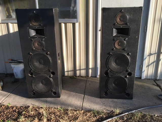

Amplidude, do you have a video or youtube link for these JBL/EV loaded 3 way? Looks interesting. What was your budget for these? Thanks😉

I do have a photo slide on YouTube search for diy 3 way speaker,Amplidude, do you have a video or youtube link for these JBL/EV loaded 3 way? Looks interesting. What was your budget for these? Thanks😉
