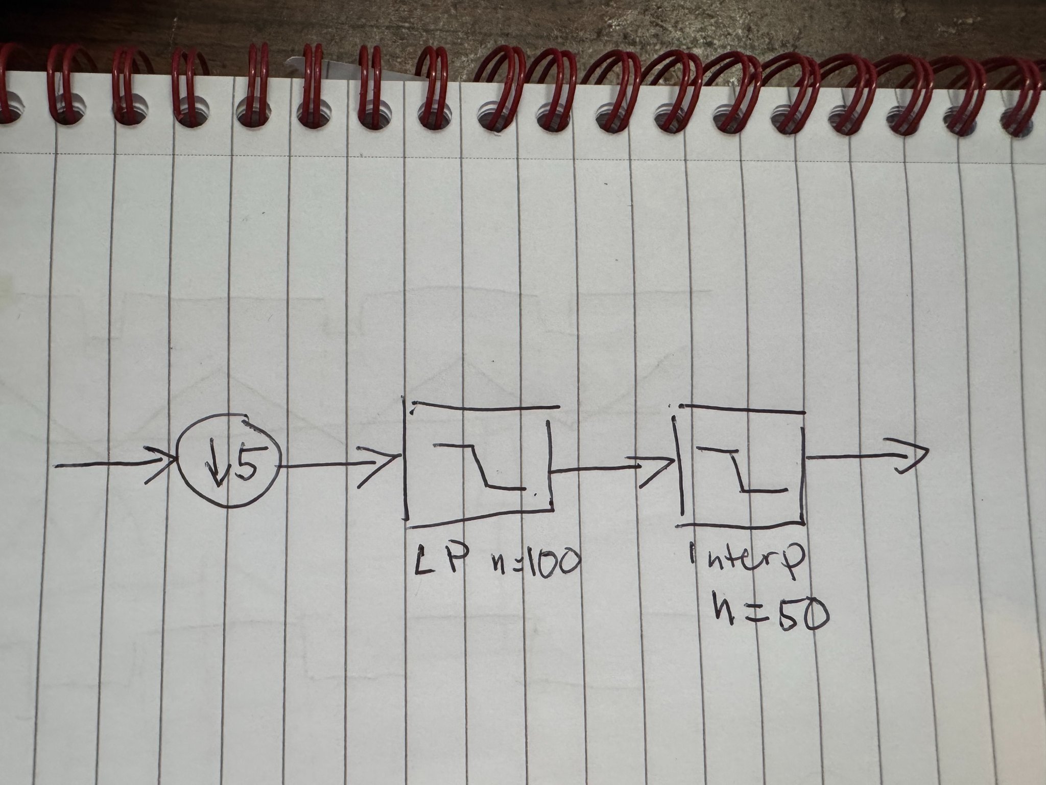

I need some brain gymnastics this weekend, so I was thinking of designing (from scratch, of course) a digital sub filter for the sub woofer I'm currently working on. I have a Teensy4.1 with an audio shield that should be up to the job.
My DSP-fu is a bit rusty, though, so maybe someone can do a sanity check?
Filter. I want to use a FIR due to its linear pass band phase (and therefore constant group delay). Unfortunately, very low frequency LP filters require extremely long FIRs, so I'm going to use the old decimate-filter-interpolate trick. I first decimate by 5, apply my filter, but with a 5 times higher relative cutoff frequency. Then I filter it again to interpolate. I experimented a bit it Octave, and it looks like 100 taps for the first filter and 50 for the second one yields decent results without using too much compute power. I'm not too worried about the aliasing bumps in the stop band, as they sit at about -55dB.
Next I need some kind of phase correction. And correct (no pun intended) me if I'm wrong, but it's really the group delay and not the phase I want to correct. So instead of fiddling with all-pass filters, I should just use a simple digital delay, right?

An IIR (or 2) + adequate EQ to flat (minimum phase should make this time correct) and perhaps some delay... isn't that really a better recipe? 🙂
You tell me! 🙂 A FIR gives a "perfect" phase response and my thinking has always been to use a FIR if you can computationally afford it.
I suppose you want a flat acoustical phase output and not only a perfect electric box (filter) but still a crocked system?
Think system phase response ;-)
That basically means you allow intermodulation products between the signal and the lower sample rate to be about 0.18 % of the desired signal. Most people here would not even allow 0.18 % if it were mere harmonic distortion.
Yeah, it’s probably a bit too much… Let me investigate if I can get it much better with a reasonable FIR. I might have to go the IIR route.
Just to clarify one thing: That's a filter curve, so those frequencies won't be present unless they're present in the content. So there will no new frequencies introduced. Just some of the higher frequency content leaking through the filter at very low levels. So it's quite different from intermodulation products.That basically means you allow intermodulation products between the signal and the lower sample rate to be about 0.18 % of the desired signal. Most people here would not even allow 0.18 % if it were mere harmonic distortion.
You decimate the signal, producing spectral copies around all multiples of the reduced sample rate. When the interpolating filter only suppresses those by 55 dB, you have products at multiples of the lower sample rate plus and minus the signal frequency added to the signal. The system is not time-invariant anymore once you decimate, at least not with imperfect decimation and reconstruction filters.
I mean what you hear is still not phase correct even if a filter in the audio chain happens to be phase correct. Is the net sum that is of importance, not each step in the chain...What do you mean by crooked system?
The phase response is really only important in the passband, and a bit of the transition band. Phase response in the stopband can go totally haywire and you won't care because the amplitude is so low. So perhaps consider IIR with passband phase correction. There are threads here on diyAudio about exactly that.
