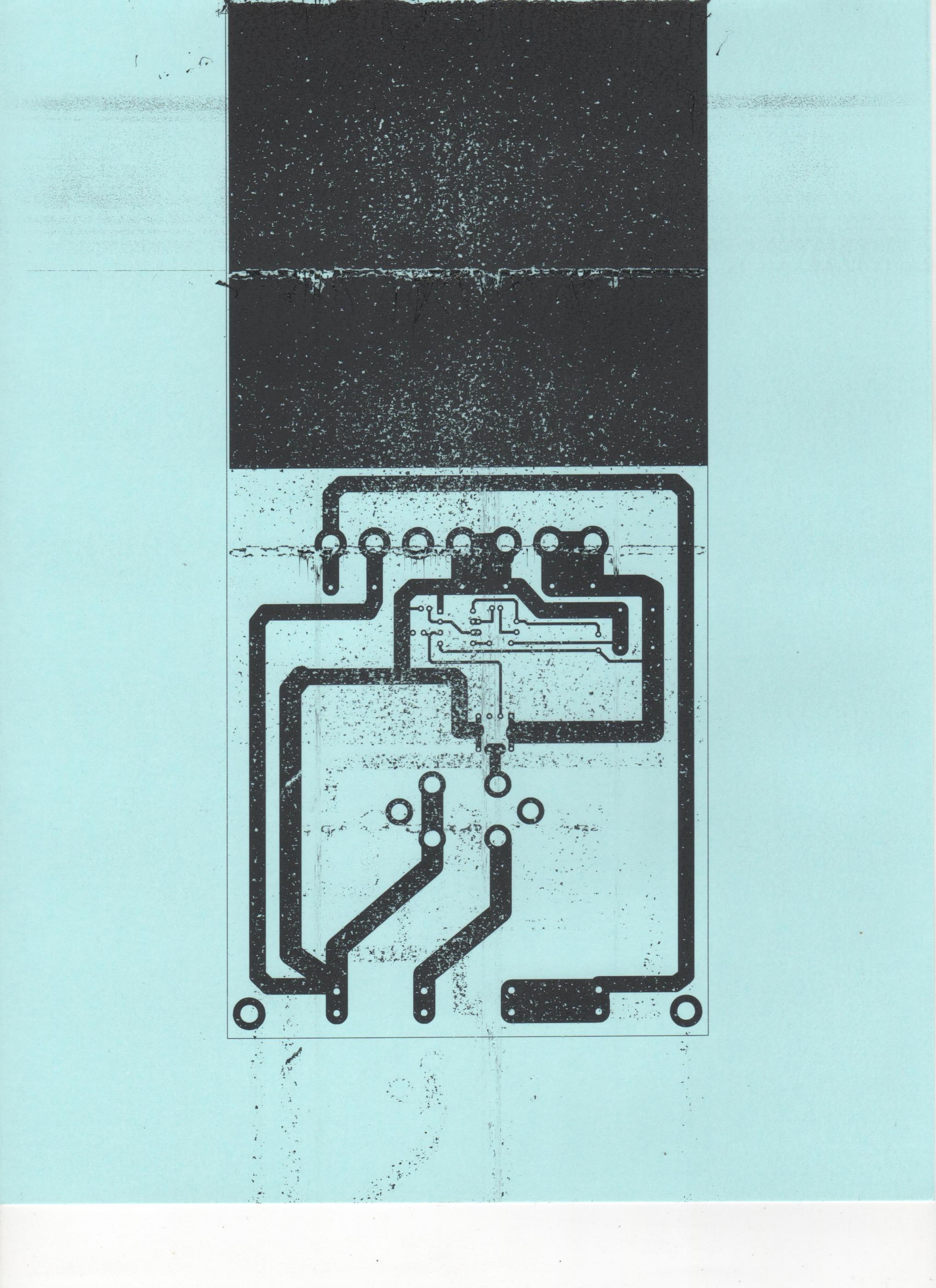

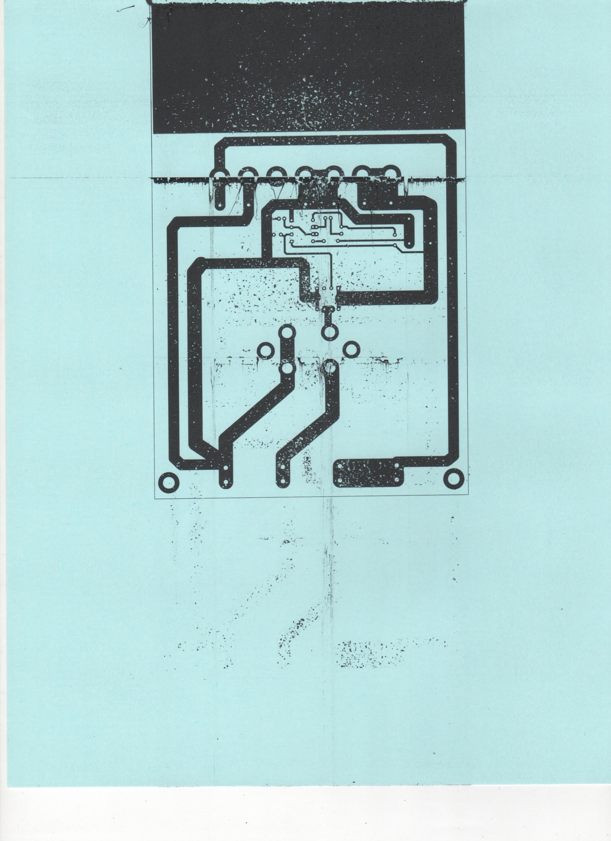

Oh dear another dismal failure
I really thought this might work but NO, another dismal failure.
Now, image 2 was printed on normal 90gsm paper using my Samsung ML1665. The printer is working fine it just doesn't like the TTP (Toner Transfer Paper).

Yeah, the paper is slipping on the rollers. Man, find something quick, I'm tired of using thin magazine sheets 😀
Toner transfer works very well. The problem here seems to be the printer. Wouldn't it be best to try your TTP in a different laser printer first or even try to clean it up a bit? You can get very good resolution with the toner transfer method so I wouldn't give up on it yet.
After many weeks of experimenting I have come to the conclusion that any form of toner transfer is a waste of time. The results are unpredictable and the final product is invariably poor. I've tried many many laser printers, even when using the capable HP Laserjet 600, which will print onto the TTP, the image still wont stick to the copper clad board sucessfully. I've tried numerous laminators which all failed, even ironing it with a domestic iron was a failure.
