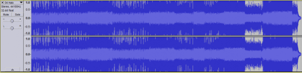

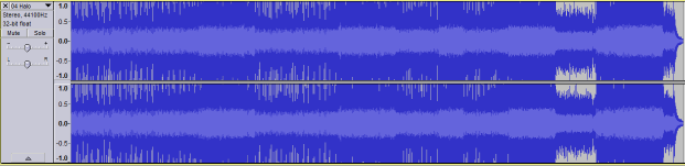

A CD mastered at -9 would be LOUD! They do exist, and are getting more frequent, but they are the ones that so many people complain about being overly compressed -AKA the Loudness Wars. I do have a few heavy metal CDs that are at -10dB.
The whole amp power thing is so goofy. When does it date from - the old AM radio transmitters? Did that get carried over into audio amplifiers?
Rating them in volts RMS would be sooo much better.
FTC amp ratings happened in 1974. The trouble is, marketers will always game the system. Volts RMS is no better than Watts RMS.
Here is from a porcupine tree album deadwing, song halo - looks more like pink noise than music, and the spectrum peaks at roughly -8dB
Porcupine Tree is pretty good for audio quality as far as rock goes, too. In Absentia was mastered a lot better but still, your example is far from the worst of modern music.
