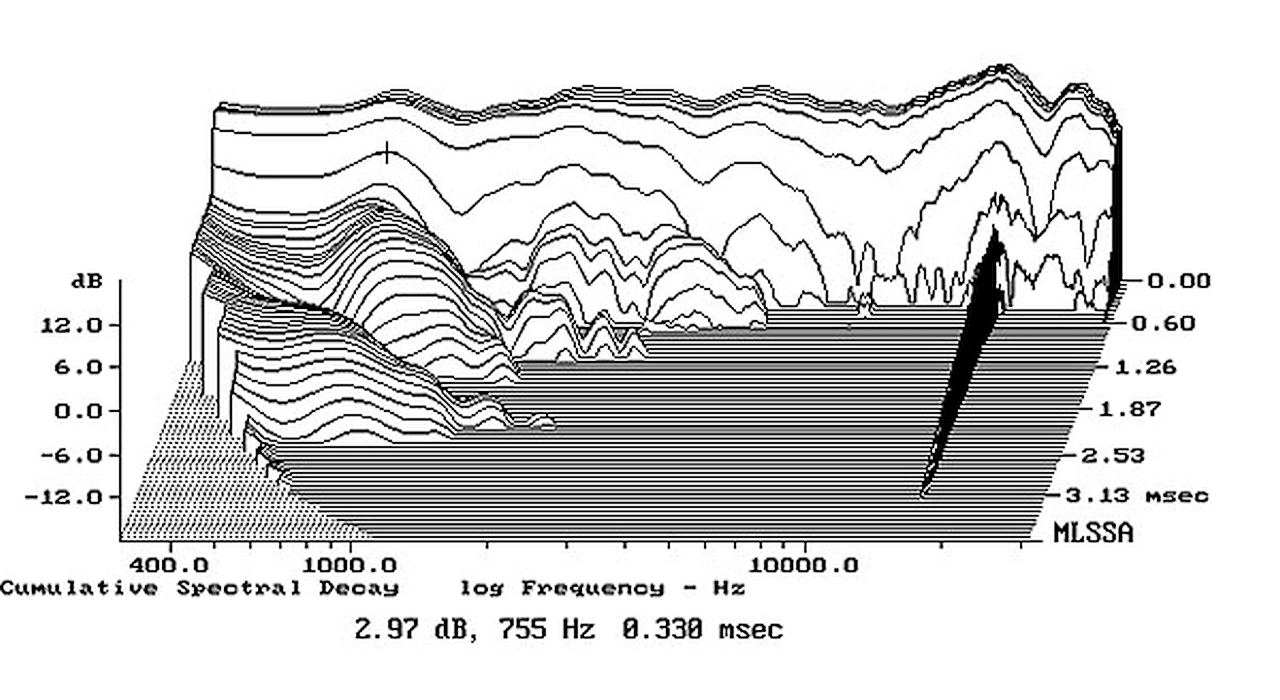

This morning, after uploading an image of the spectral decay of the KEF LS50W I wrote:

@Maty - Danny Richie obviously messed it up in that measurement as CSD from John Atkinson shows a much cleaner picture:
Spectral decay of KEF LS50W is from a PDF of HifiCritic. I could not believe the waterfall. Except to align the frequency response, what improvement is the DSP doing? Well, you can also align the phase optionally.

Danny measurements appear only in the video and comments two and three.
