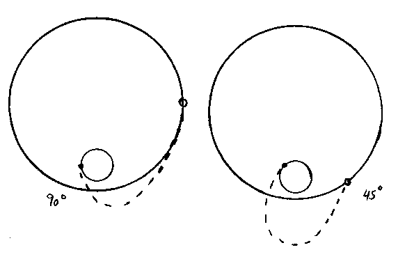

Here's the 1/2 turn again at 45 degrees and 90 degrees. Looks like 45 degrees has a clearance problem getting thru the core.
So far I have kept the rotation speeds of the two ends of the cable synchronous. We COULD allow the rotation speed of the bobbin feeding end to speed up (or phase advance) when the loop gets unwieldy, then slow back down again (phase retard) when max stretchout is needed. (Winding the excess cable around the core momentarily)

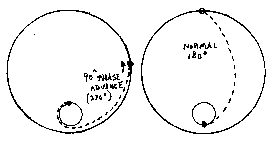

Phase shifting or advancing 1/2 turn version:
Having the shuttle end pull on the cable as Kenpeter suggested may be sufficient to do the same thing for phase advancing. Since it would be pulling on the cable, it would naturally wind up excess cable on the core when excess is available. But it might also snag the cable tightly around the core then too. That could be problematic with a square cornered core cross section. Especially since the wire tension needs to be higher then to pull the wire down tight.

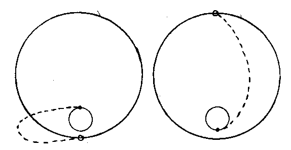

Kenpeter,
Seems to me that the dragged 1/2 turn sleeve is now doing about the same motion as the friction plate/slack accumulator did before with the wire. Ie, the wire is conforming to the same shape during a rotation. So how about putting the sleeve thru a friction plate. The wire would pull thru the sleeve and the sleeve pulls sideways mostly thru the friction plate. That might keep the sleeve off the toroid surface then if it is shortened further. Maybe shorten it by 1/2 a circumference around the toroid cross section.
edit:
duh, on second thought, that probably isn't working, since the wire won't be dragging after leaving the sleeve.
Don
edit:
Don

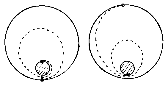

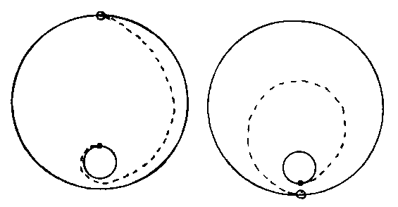

The idea of phase advancing the bobbin feeding end I think is not going to work. The two sleeve ends still have to pass each other during each rotation at some point. The excess sleeve will end up all wound up on the core at that point.
Seems that for the cases of the wire pulling the sleeve around, one will need a sleeve with variable stiffness along its length. It should be stiff near the bobbin end and more flexible toward the toroid end. A constant torque spiral resulting with at least one turn (like in post # 35 I think).
