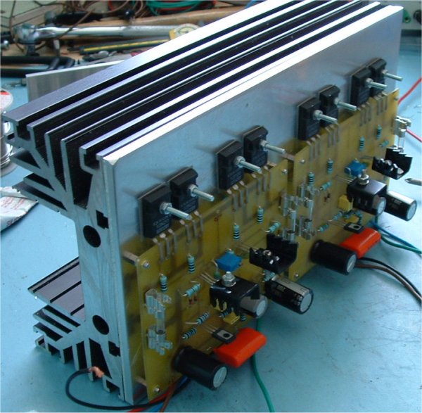

I just want to comment your drivers. This arrangement is very sensitive to vibrations and chocks (not a problem in your case maybe, the amp will be at home and not moved around). Shorten the transistor pins and fixate the heatsinks with glue. Copper pins are rather weak when it comes to bendning back and forth.

Peranders, the amps will be in the horizontal position and the heatsinks are not very heavy so I think it won't be a problem, but point taken.

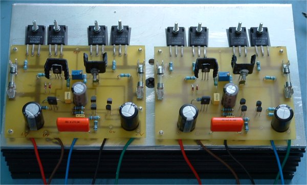

I think this board could be condensed down to a very small size but at the moment it meets my requirements, feel free to modify the layout and post it back.
I haven't lisened to these amps yet, I was doing final scope testing and power testing yesterday when I mistakenly connected the output of my function generaator to the +50v lead instead of the i/p lead a moment later the generator went bang Doh!!

In industrial environments heavy things on long leads is a bigmatth said:Thanks for the comments guys.
"Heavy" is not very heavy in order to get you into trouble but as a genreal rule: keep big caps, heatsinks, transformers etc. tightened to the pcb with screws or glue.
An alternative view (about 180 degrees out):
If you have things that can move wrt each other, you NEED to have some lead length to prevent things from cracking and/or breaking.
Don't shorten the transistor leads, they are necessary to pick up any movement relative to the PCB when heating and cooling.
Jan Didden
Jan Didden
As I said keep all radial parts pins short but axial parts like diodes, caps, resistors must have some "expanding room" especially if they are hot. Don't bend the legs too close to the body or with too small radius. Keep all parts close the pcb unless you have very special reasons for like very hot resistors which needs cooling.janneman said:Don't shorten the transistor leads, they are necessary to pick up any movement relative to the PCB when heating and cooling.
