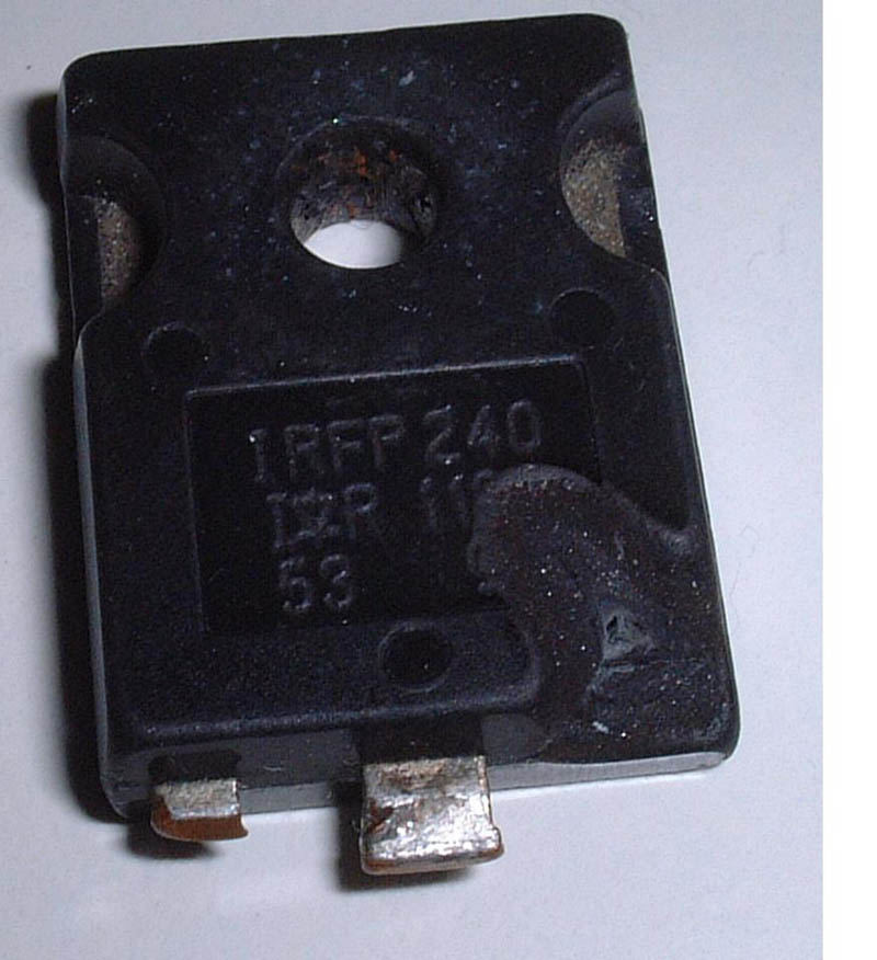

Somehow I managed to swap a irfp9240 for a irfp240 and vice versa... No wonder I was consuming too much current and everything was screwey!!!!
Once again my Variac probably saved my A$$, and a few parts but I won't know until I get them out and test them.
As bugs bunny would say... "WHAT A MA-ROON"

well yuo should get some sleep then.. never power stuff up at night i learned that the hard way see..
This is what happens when working on my blue amps at 4am so excited to get them going and well one blew up: O ) easy fix just replaced both fets and re bias-d till this day they still work. and also till this day i never power things up past 12 at night. L O )
