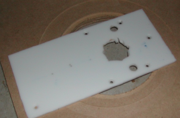

make a circle-cutting jig - a what??? - easy!
I got a strip of perspex about 130mm wide and as long as you like, depending on the radius of your cut. I picked up a scrap out of a shopfitters acrylic bin.
my router has a plastic base plate, held by 5 little bolts - removed this.... use this as a template and transfer these holes to perspex (and coutersink them) - make sure you have cut a hole in the centre of the perspex for the cutting bit to hang through.
Attach this to the router with the bolts - you now basically have a long baseplate.... by drilling holes in the long part of the plate, you can form a kind of compass
ie use a nail in the centre of your proposed circle as a pivot point through a hole in the long end of circle jig, plunge router to required depth and simply guide it around the circular path..... done.
just get a roughish measurement from the outside edge of the cutting bit to your centre hole, cut a rough hole on scrap, then adjust the position of the hole.....
I rout an 18mm square trough to about 5mm depth, then jigsaw out a roughish hole for the driver to sit in..... nicely flush mounted, obviously you can't see the crappy jigsaw hole! You could also rout a deeper trough at the inside diameter instead of jigsawing, but jigsawing is quicker, easier and cleaner!

A picture is worth a thousand words!
5 countersunk holes for router....
big chunked out hole for cutting bit....
two round holes for small circles - drill small hole in actual router base and pivot on this....
One I saw in a book was about a metre long, for table tops...... the circles come out perfectly, my first example one is shown.

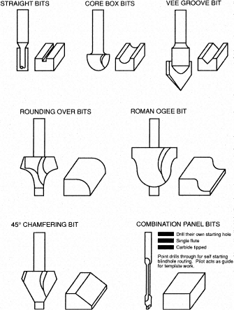

They're not exactly routers. They are router bits. The one that probably would be most useful for cutting circular holes is the one lower right.
i went to ebay to look for routers and found plunge routers... those that look like a u shape... are these correct?
