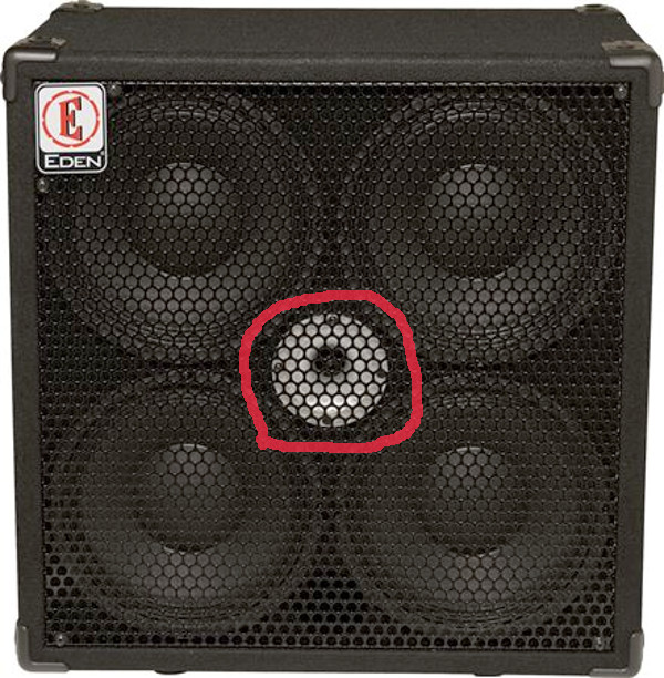

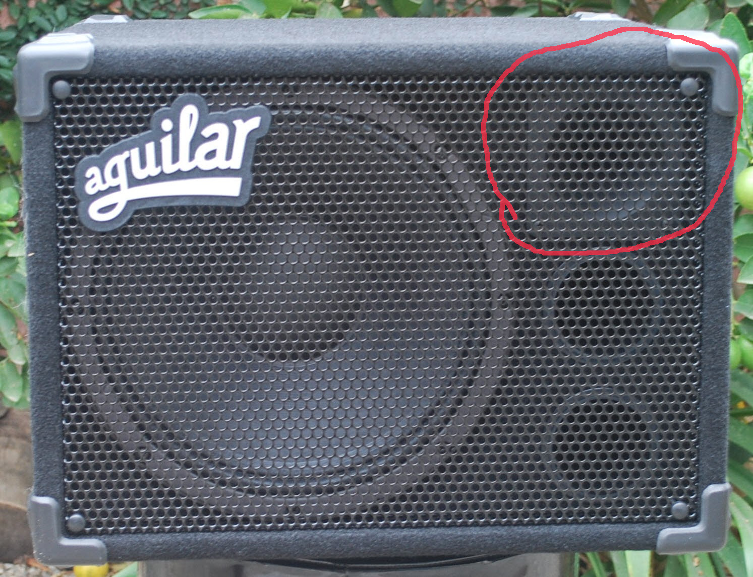

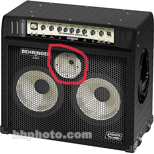

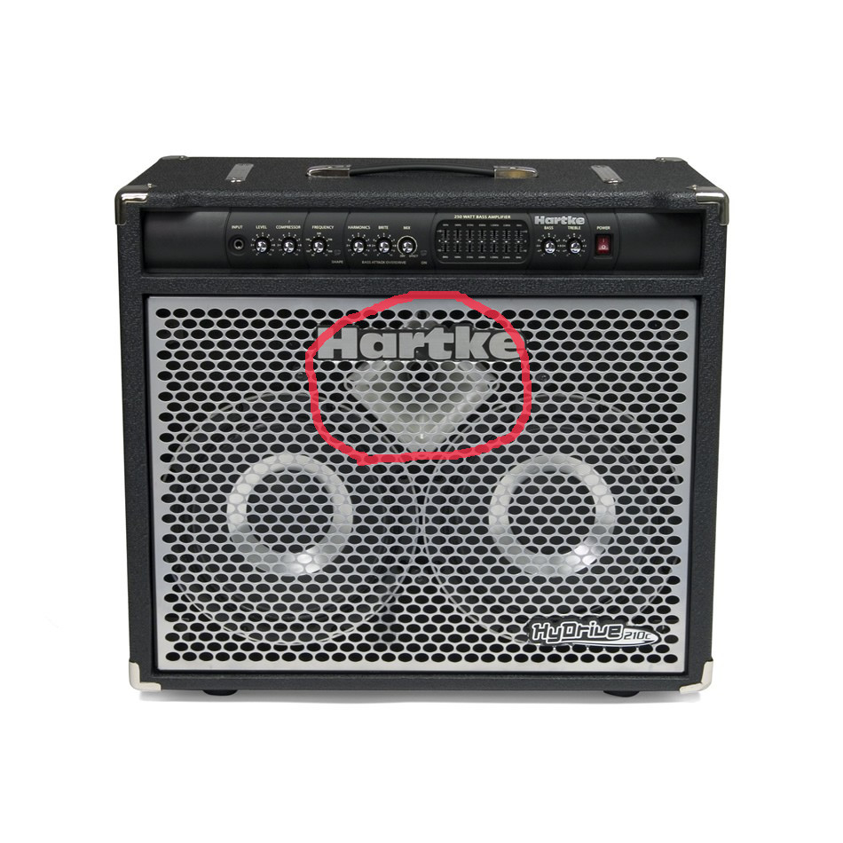

Two questions:The highest note on a bass is ~330 Hz (21st fret on the first string).
Question 1: Why do you suppose so many bass guitar amps actually have tweeters, if 330 Hz bandwidth is all you need? Consider that few tweeters operate below 2 kHz, and many only work above 4 kHz, particularly the little horn tweeters that tend to be used on bass guitar amps.
Question 2: Have you ever actually heard the sound of a bass guitar with everything above 330 Hz filtered out?
Fact: because bass guitar pickups are mounted quite near to one end of the strings, and not in the middle (12th fret location), what comes out of the pickup is mostly harmonics, with comparatively little fundamental.
Fact: Some percussive bass-playing styles (slapping, popping) produce large amounts of treble up to several kHz.
Fact: Even with "old school" playing techniques, a good part of the character that differentiates one bass guitar from another comes from harmonics, fretting and fingering noises, etc, that extend up beyond 1 kHz.
Because of all these factors, I would say your estimate of the inductive reactance of a bass guitar pickup is substantially in error, by a factor of at least three to ten times.

P.S. There is a typo in one of the attached file names - that's an "Eden" EX410 bass cab, not an "Edem". Sorry!
