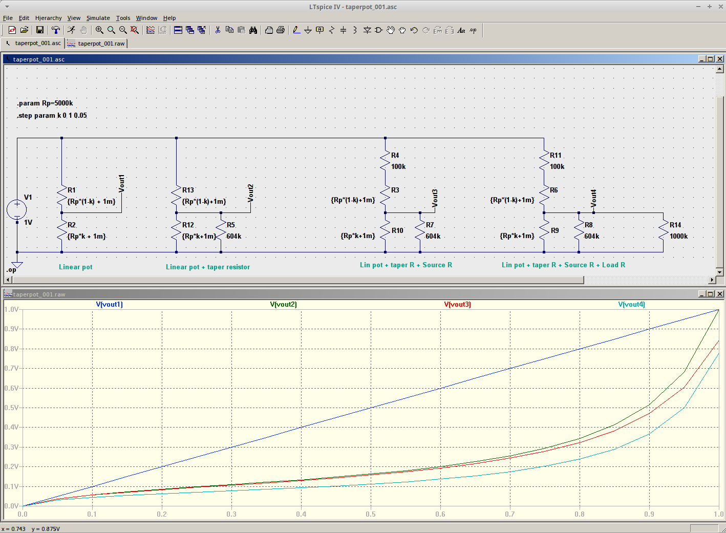

WHY would the resistance "vary wildly" as the knob is turned? That makes no sense to me.That's because the end-to-end resistance of a linear pot with an added taper resistor varies wildly as you turn the knob, and that loads down the source feeding it.-Gnobuddy
It may not be obvious, because intuition is, by itself, not a great tool for solving technical problems. We need mathematics to understand this (and there are many cases where math - and reality - turn out to be counter to intuition).WHY would the resistance "vary wildly" as the knob is turned? That makes no sense to me.
But, obvious or not, it's quite true. This effect (end to end resistance of pot varies with pot setting) happens because, with the taper resistor added, there are now three resistors in a series-parallel network: from end A of the pot to its wiper (B), from wiper (B) to the other end (C), and the additional taper resistor from (B) to (C), in parallel with part of the wiper.
As you turn the pot, the fixed resistor is in parallel with only a part of it (B to C); that means the resistance from (B) to (C) is affected by the taper resistor, and is always less than the B to C resistance of the pot alone, by an amount which depends on pot rotation.
We know that a pot by itself has a fixed resistance from A to C, no matter where you turn the knob, because the A-B resistance and B-C resistance always add up to the same total (the pot's end-to-end resistance). With the taper resistor added, because the B-C resistance is now varying with rotation in a different way, it no longer adds up to a constant when you add the A-B resistance.
The attached screenshot shows an LTSpice simulation of this effect. I used your recommended values (5M pot, 604k taper resistor.) Actually it's for simulations in one:
1) The leftmost circuit is a straightforward linear pot, with matching linear output voltage versus rotation (blue line).
2) 2nd from left, we've added the taper resistor to get the pseudo-log behaviour we wanted (dark green line).
3) 3rd from left, we've now added a 100k source impedance. The red line shows the effect of this - our log curve is a bit different than what we intended, and there is some signal loss even at full pot rotation.
100k may be higher than the actual source impedance of bass pickups at the highest notes a 24-fret bass can reach. I used this high a value because it is big enough to clearly show the effect of the varying (pot+taper resistor) resistance on the output voltage.
4) 4th from left, I've now added a 1M load on the pot, representing the input impedance of the guitar amp on the other end of the guitar cable. The result is the blue-green curve, quite a bit off from our intended (dark green) curve, and there is also a couple of decibels of signal loss even with the pot all the way up (output never makes it to 0.8, never mind 1.0).
Note that I've used a DC simulation to keep the focus on resistive effects only. I suspect that using a high value 5M pot (even with a 604k taper resistor) will also cause treble loss ("tone suck" in crude parlance) due to cable capacitance. We could easily test that hypothesis with one more LTSpice simulation if required.
-Gnobuddy

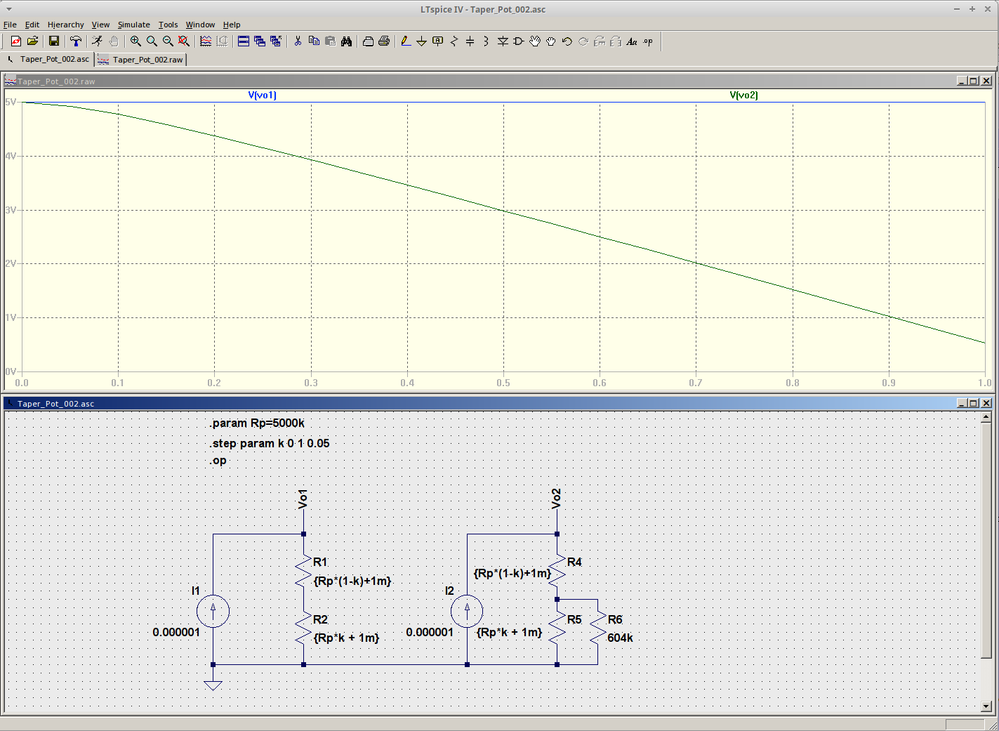

I've shown much more than that, actually. But more on that in a moment. 🙂OK, you've shown that the curve is modified slightly by the source impedance of the pickup (100k is WAY too high) and the load impedance of the amplifier.
As far as source impedance goes, get me the inductance value of the bass pickups in that guitar, and we can calculate the actual value. I've calculated 30k for a regular (non-bass) guitar before; bass pickups probably have higher inductance, therefore higher impedance.
I think you mean "I am not able to see it, can you please explain it to me?" 😀Nowhere is there any evidence of resistance varying "wildly".
So I will. Take a look at the attached image. This time I have a constant current of 1 uA being fed into (a) a 5M linear pot, and (b) a 5M linear pot with your 604k taper resistor added.
By ohm's law, the voltage across a resistor equals current x resistance. Therefore the voltage is directly proportional to the resistance. In this case, I've chosen the current (1 uA) so that it produces 5 volts DC when it flows through a 5M resistor.
Now, if that resistor was lowered to 4M, you would get 4 volts instead. 3M would produce 3 volts. And so on. Clear?
Look at the two graphs. The upper line (blue, Vo1, pot with no taper resistor) stays constant at 5V as the pot is rotated through it's entire range. This confirms that the end-to-end pot resistance stays constant at 5 megohms as we rotate the pot.
Now look at the green line (Vo2, 5M pot with 604k taper resistor). It starts off at 5V, but droops to 0.539 volts - less than one-ninth as much - as you rotate the volume pot from zero to full. This means the end-to-end resistance of the pot with taper resistor, varies wildly as you turn the pot, from 5M all the way down to 0.539 M, about a 90% drop in value, exactly as I described earlier.
This is not a surprise, as that 604k resistor ends up in parallel with the 5M pot when it's turned all the way up. You can calculate the resulting resistance - surprise, it's 0.5389 megohms!
So, I've just shown that when you add that taper resistor, the 5M pot's end-to-end value stops being constant; instead, it falls by almost 90% as you turn the knob from zero to full.
A 90% change in value is wild enough for me. Perhaps for you too. How would you respond if your income were suddenly cut by 90%? That would be pretty wild, huh? 😀
-Gnobuddy
Where on earth did you get that from?A guitar pickup is a constant-current source?? What guitar is that?
The current source is a way to measure resistance, and plot it with LTSpice. There is no pickup in that simulation, only your recommended 5M linear pot + 604k taper resistor.
Your DMM measures resistance in exactly the same way I did in this simulation - by sending a constant current through it, and measuring the resulting voltage drop.
Whether you like it or not, the fact is that adding a taper resistor to a linear pot, in the attempt to turn it into a log pot, causes a huge variation in end-to-end resistance as the pot is turned.
I've already explained, in two or three different ways, how this works. If you still don't understand, you're on your own. I suggest wiring up one of those 5M pots and 604k taper resistors, and measuring the end to end resistance with your DMM as you turn the pot.
It will cost you a few bucks and some of your time, but perhaps that way you will discover the truth for yourself.
Good luck!
-Gnobuddy
