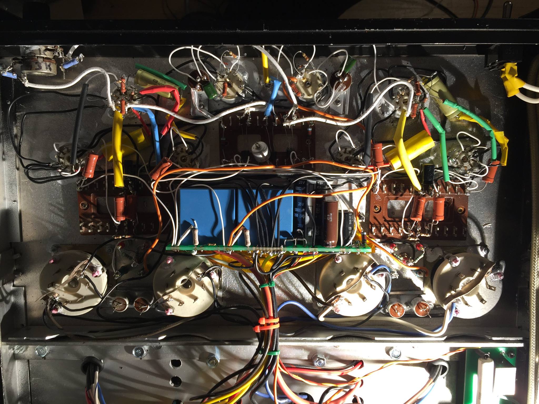

Since no one has mentioned a ground bus, I will promote that method, which is my preferred method of grounding. First a lot of vintage units from the golden age of audio use a ground bus so it is a widely accepted method. I use the mounting bolt of the power transformer or some point close to it for the start of the ground bus. I use at least a 14 awg or larger solid copper wire that is conveniently located across the tube sockets. It usually anchors at the opposite end of the chassis but is insulated at that point. With this method all the resistors and caps are grounded directly to the ground bus. To me it is easier to be sure each component is properly grounded since you can easily examine each solder joint along the ground bus. I have never had any hum issues ever, when using a ground bus. cheers, 808
Here is an example, from my amp prototype.
You see a PCB where all power supplies end, 800V for B+, 400V for driver, 270V for screen grids, +12V for filaments, and -70V for bias. All outputs of all sources are connected such a way so traces from corresponding capacitors are the shortest. It is the "Zero reference point". All power supply currents close in this point, and you see a bunch of black wires going there, including ground wire from chassis and power outlet. As the result the amp is silent as in a grave. The main point is, no high and low current chains share any common wire that can cause coupling through the wire's resistance and inductance. Ground loop in such case don't hurt since they don't carry dirty currents.

I always build with a single bolt grounded star onto the chassis, and this bolt then tied to safety earth. My systems run extremely sensitive speakers of +100db drivers. I do point to point and pay only slight attention to cable routine (they usually look like a spaghetti mess). I run AC heaters but always use tightly twisted pairs.
None of my builds hum in the slightest - not even a tiny trace. Take that how you will but I would never build any project that didn't implement star grounding.
Shoog
I do exactly the same and also have no problems. I put the chassis point close to the mains transformer.

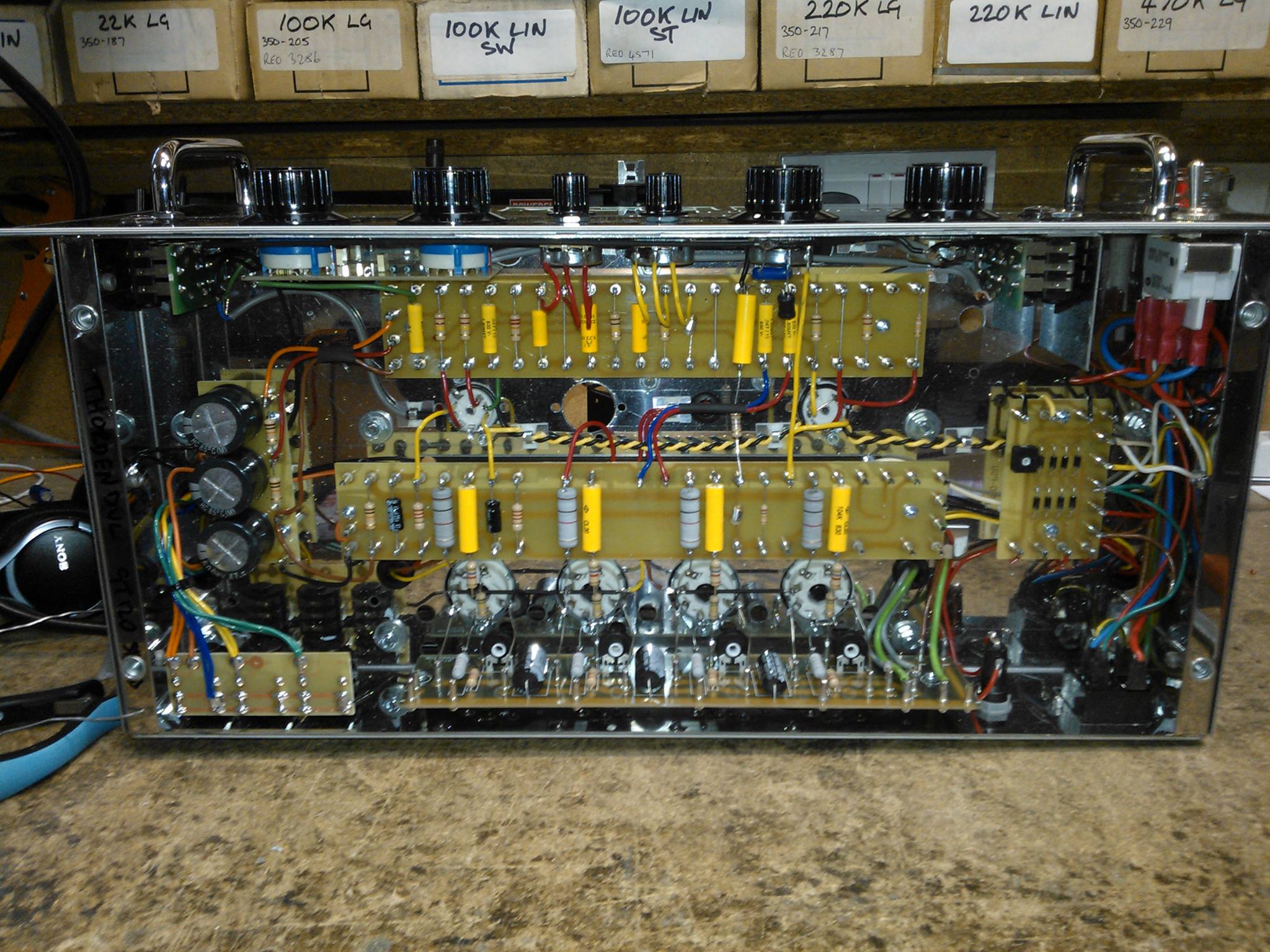

My builds underneath are not a thing of beauty, but they don't hum!

The guitar practice amp i am currently working up started out with a "star". I replaced that with a length of 14ga copper last night as a bus.
Much neater, less power supply noise.
