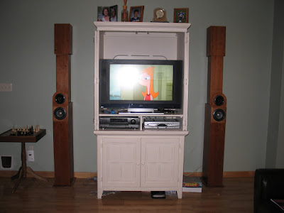

TAMP90 running stereo 4 ohm @ 90-ish wpc will be very nice for the second system (assuming it runs correctly!) so I'm not really looking at doubling that one anymore.
"second system" Tekton Designs OB4.5's
I will be looking very seriously @ the TAMP-300 when it comes out for driving 4 ohm stereo.
"upstairs system"-in-progress
