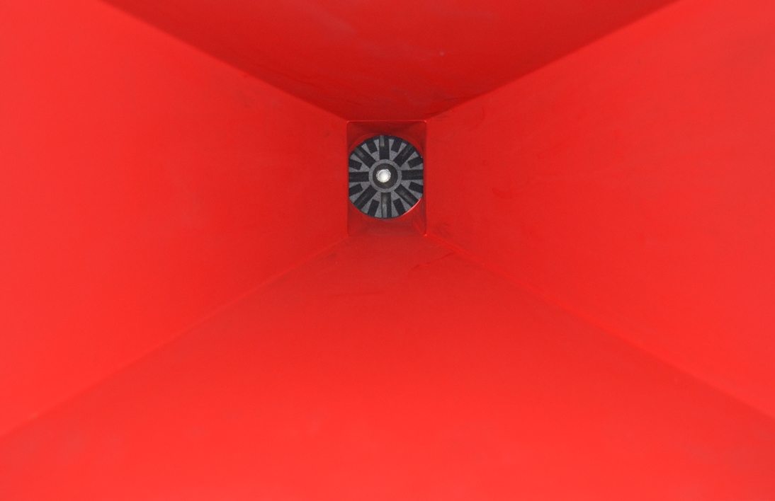

i hornresp´d my 12" 12N820 and its 182cm horn with 6900cm2 opening mouth
bit limits if there should be compact in sentence
i dont know, could be banging ok in inlowsound 135hz horn too

Hey Mr. compact monitor what do you think about this desing?
i could do 250cm length but only like this
been simming one, its conical with little front chamber and 400cm2 mouth
Hello, i'm not sure of the bandwidth of that bass horn - with the 90 degree bend it might not do so good above 400-500 Hz. 250cm horn is more of a bass horn anyways 🙂
2 and 1 pi sims for the bass horn
that would be very interest to hear 🙂

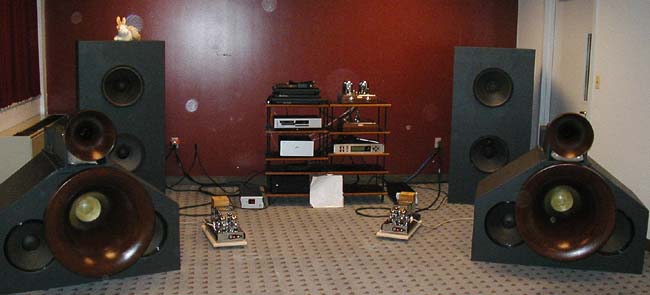

Yes it's not a very pretty horn path. I used to think big midrange horns and folded bass horns were the way to go but now like straight horns over wider bandwidth on the bass/mids.
I have a pair of folded Edgar front horns that works OK to 500 Hz. Problem i find is compression drivers in mid horns used down to 500 usually don't sound best.
It's all a matter of shuffling around the bandpass of different configurations until you hit on what works best for you and your room

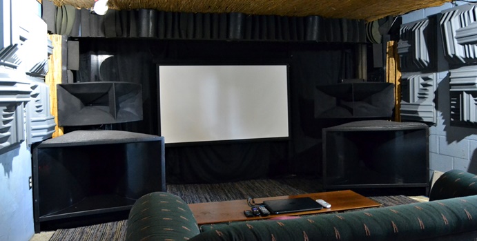

Now a two way with the subs.
With additional room treatments on side walls and behind I'm now utilizing the wide radiation of EV9040 "white whale" from 500-600 hz up with a Radian driver. coherent and high resolution. Tone is really nice.
Those white whales are damn good, I bet that's a fantastic and fun setup you're currently enjoying.
