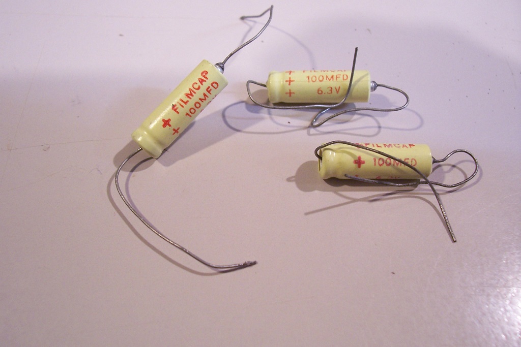

"Film cap" is a known (by me at least) manufacturer of..... film caps
Well, I was (partly) wrong: Filmcap does also E-caps: I found a number of examples in my drawers.
These are 100µ/6V3, and probably date back from the late sixties or early seventies:
attachment.php
They are NOS, and still functional: their ESR @100Hz is 2.4Ω, to be compared with 0.94Ω for a modern, plain-vanilla Multicomp example.
Not bad when you think about it: such an ESR value was quite normal ~50 years ago when it was manufactured, and it didn't drift, leak or dry so it's still OK, though a bit weak by today's standards.
I think they are of British origin: I seem to remember that they were bought in the UK
848489d1590780828-hl-name-cap-help-build-hl-vtg-catalog-database-filmcap-jpg
VERY cool!
Thank you for sharing what you found out. They definitely look 1960's to 1970's (as you had said before).
I think I am going to sell them as FilmCap then, only wish I could find something out about this company. Do you think they are in the UK?
