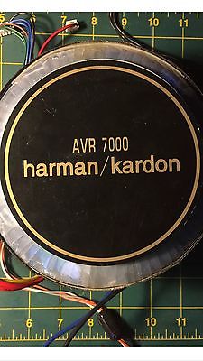

I was recently given a pair of transformers from a Harman Kardon AVR 7000.
I would like to know the VA on these and some suggestions for an amp design. Would they be good for an infinite baffle system? Whatt Wattage are these capable of supplying.

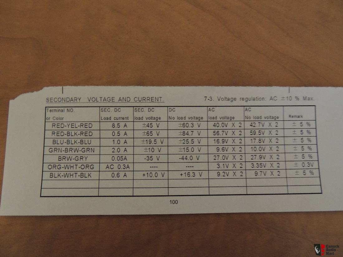

Well, the VA is right in front of you there, V*A. You can reckon on that transferring into wattage available from suitable amplifier
Oh, I see, it says secondary DC, that's odd, use AC load voltage to give you an idea of available power. VA is an AC measurement of power

The main secondary winding is 40+40VAC, 8.5A , so 680VA.
Add the other auxiliary windings and you have a >700VA transformer.
Search for an amplifier which requires raw +/-60V DC or thereabouts as power rails and both will be happy.
You´ll get 180/200 W RMS per channel into 8 ohms, 250/300W RMS into 4.
Infinite baffle? : the amplifier does not know or care about that, all it "sees" is load impedance at the far end of a speaker cable.
So YES, it will drive an infinite baffle prper impedance.
