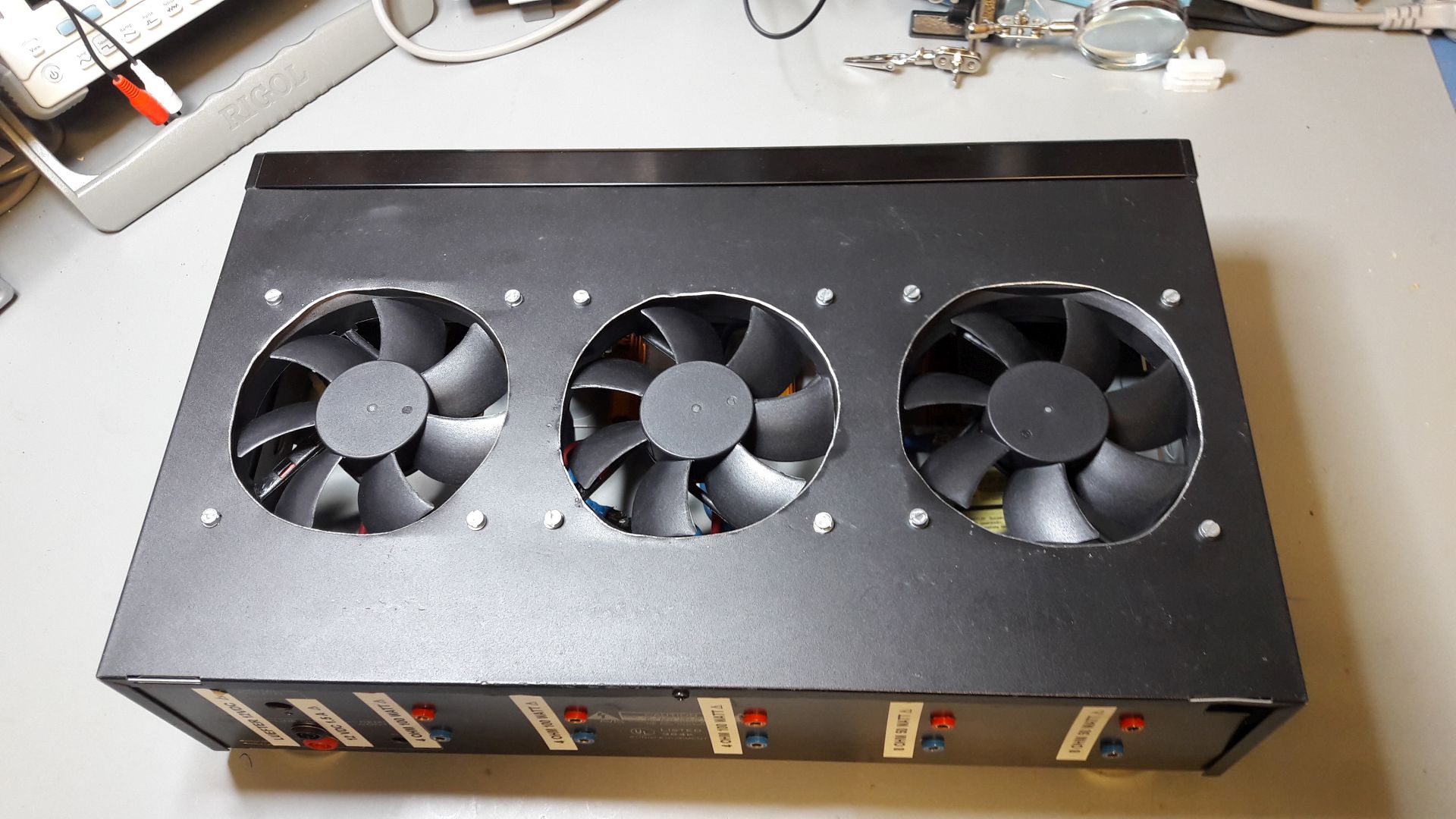

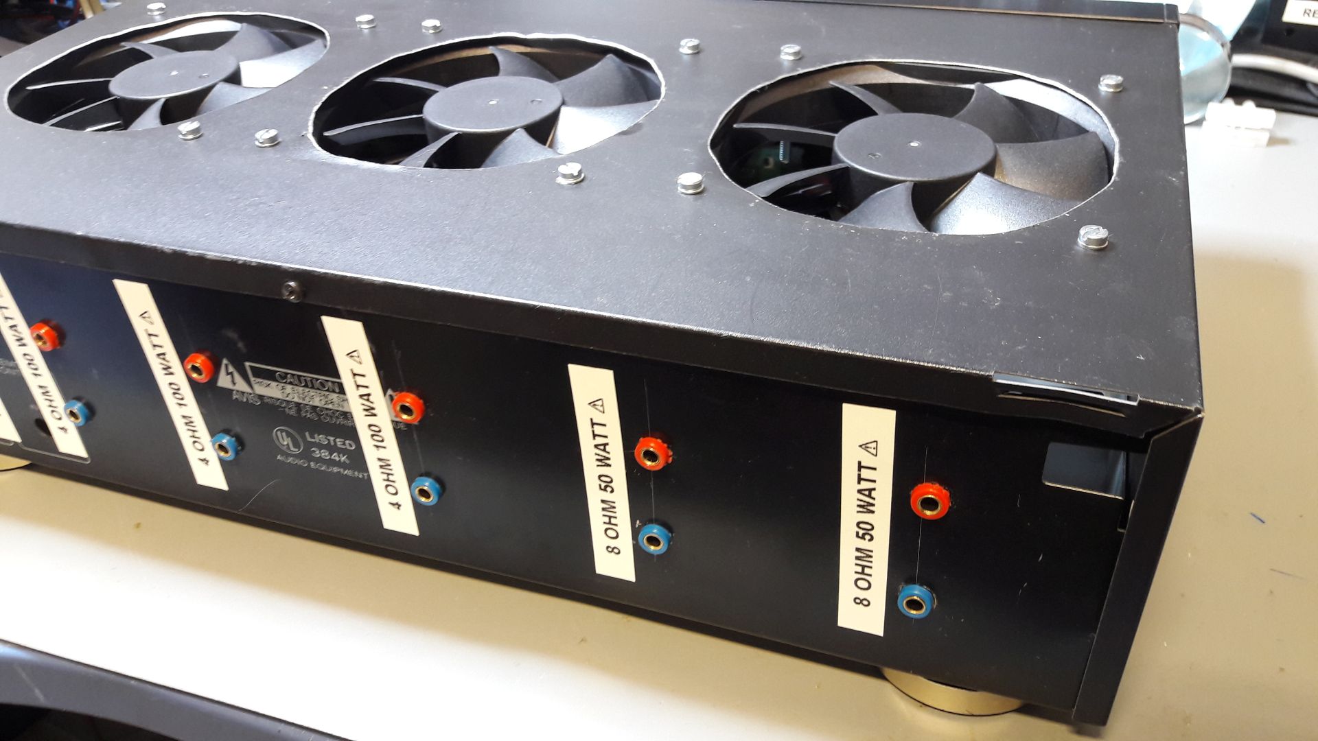

Load Box non inductive ready
hi
actually my test load box is ready:🙂
i used an old case from a 10 euro Teac CDP 3000.
i mount this Resistors 8 ohms /50W in
katur 4 50 W 8 Ohm-LED Laden Widerstande fur LED Blinker Licht oder LED License Plate Beleuchtung oder DRL (Fix Hyper Flash, Warnung cancellor) mit 8 Schnelle Draht Clip: Amazon.de: Auto
because of too less heatsink i have to mount fans. i used this:
Axiallufter 12 V/DC 149.4 m3/h (L x B x H) 120 x 120 x 25 mm ADDA AD1212HB-A70GL
13 euro each
...i tried with 2x 4ohm lines (not directly as neighbor) 30min at max and the buttom plate directly under the resistors gets 69 °c....so it ok.😀
..other pic you will find in the posts before....post 1 pic 2...
so the amps could be tested now !😎
cu
chris

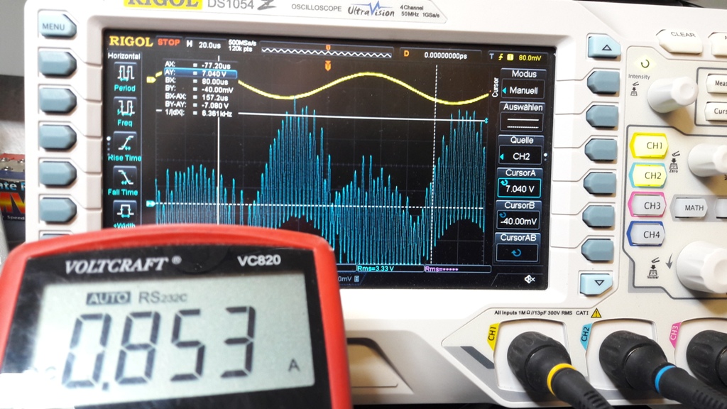

Hello again
I did some tests about OCP of thsi chip set. Is it normal that after OCP happend is some cases you can push the volume up?
As you can see at my yyesterdays night session (really short) i have the situation that at max power ( I =1,8 per channel) the ocp is not allowing to switch up...that ok for my understanding. At the current beloww e.g. I out = 1,3Ampere after OCP is acting you can push the volume up.
generally i found that the ocp is shuting down at about 70% of the set current ...is this calculated.
thanks for your help🙂

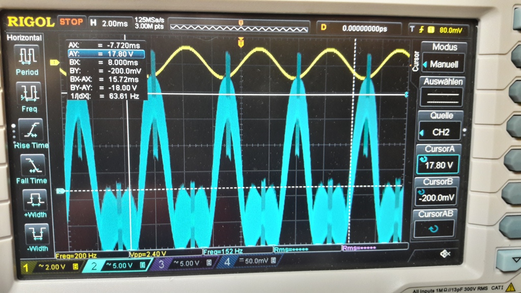

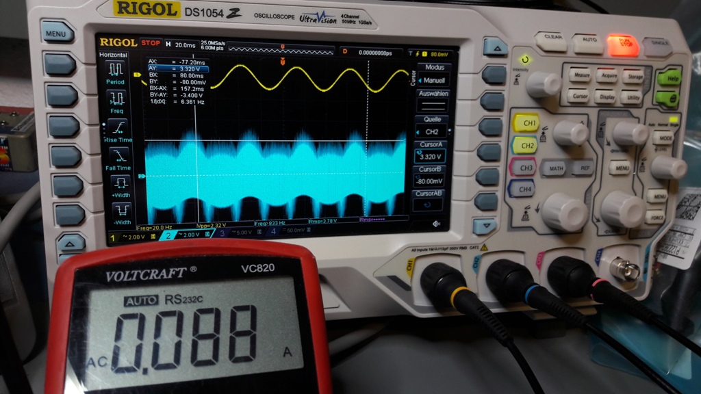

...really the last...
pic 1 how i measure the OUT + Voltage
pic 2 20hz
pic 3 clipping
this documents are the final "protocolls" 😀
...thx
pic 2 20hz
pic 3 clipping
...thx
