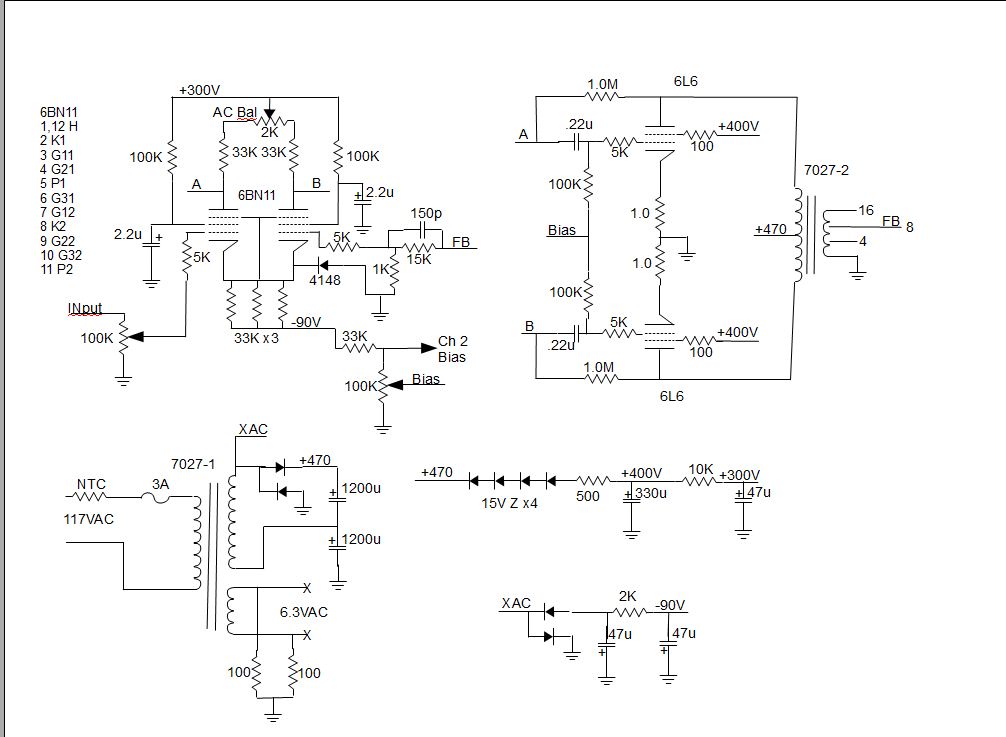

Anyway I am starting to go over the front end now that the power supply and rear panel are completed. My design criteria for the driver is that it should provide at least double the swing required by the drive tubes. The Cit V front end falls far short of that spec, and the components are really old and out of spec. Anyway once I get through with the mods I will post again.
Finished the rebuild. I dremel'd a single sided copper clad to build the power supply. Went Hexfred's and NTC inrush limiter feeding the 1200 uF 250V caps. I noted the lack of 6CG7 driver headroom, so I beefed up the bias supply to a full bridge and used it to pull the driver tail so as to increase current. Finally after some thought I yanked all that out and went with my long tail 6BN11 twin pentode driver. This allowed me to run output tube plate-grid feedback loops and eliminated the stability problems on the low frequency side as well (both drive grids are ground referenced). With the simpler but beefier drive stage the output xfmr is dictating the frequency response which now extends to over 200 kHz with no peaking. With all the extra room I put a screen grid dropping circuit consisting of a few 15V SMA Zeners to get the screens into tube manual operating range.
did you ditch the 12by7 input stage? or just replaced the 6CG7's? and did you operate the 6BN11 pentode or tiode? sorry for the questions....:D
i haven't tried the 6BN11, i have a lot of those purchased at the Rogalskie's for a dollar a pop, i suspect they sound good....can you post schemes? thanks
I am attempting an upload. Usually one needs to put a 30 pf or so cap from the 2nd (the one with the grounded grid) drive tube plate to ground to suppress 1-2 MHz seen on output when the load is disconnected. Thanks for the tip; I had forgotten where I got the 6BN11's from; ordered another 50.

What's the input sensitivity and max ouput swing of your 6BN11 dif amp stage? I'm looking for a driver to swing about 130V rms at each anode of a 6336A (triode in push-pull for a total of 260V rms) for about 20 Watts out - and I have a couple of pairs of 6BN11 with matched sections .... what do you think?
I thought 130VRMS sounded like an awful lot. Running around 250V on the plates you would need a 400V drive B+ and about -130V for the long tail bias; 10K LT resistor. Assuming 30K plate resistors and 50K grid return resistors the plate current is 5 mA and total plate load is about 19K. So the tubes should be able to run 75-80V peak under those conditions. The gain is still very good (those are the conditions I use to drive 6550's) Note that I am running separate SG bias circuits on the 6BN11's. That is a great help in balancing the tube halves. The AC Bal resistor is absolutely necessary as well.
The sound...well all I can say is that the stability of the circuit is quite clearly heard. Note also that I am not having to throttle the front end frequency response as on the original 5-20; the OPTs are thus able to breathe freely. And a a buck a pop the 6BN11's are a great buy indeed.
