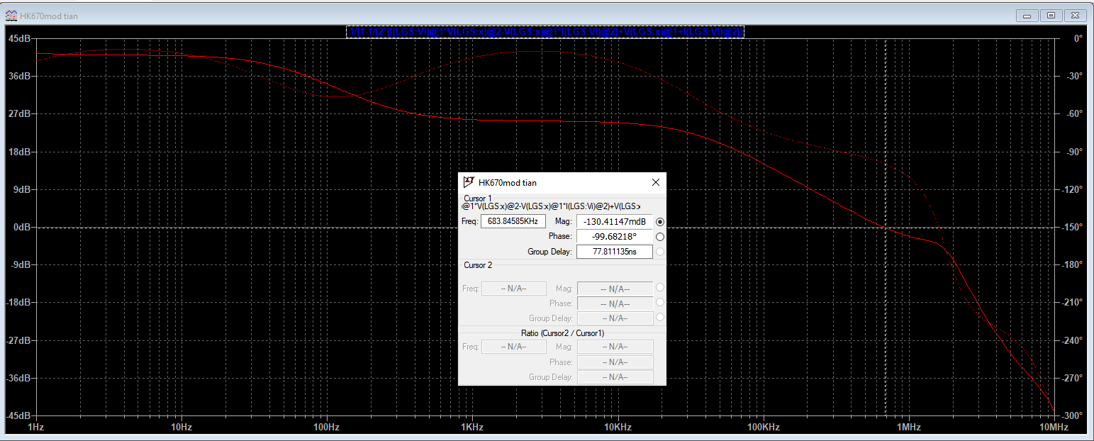

So, plan is to make some mods to this amp, and just in case somebody in interested, I thought I would share the sim. I could not find C6 (in sim) on the boards, and I can't really see why it would be needed (quite a large value too). Had to substitute some (video)transistors that I could not find models for, so stability sim is not very reliable, but I use it as a reference point for what was stable.

Main change is increased front end gain and adding a nested feedback from the VAS. I increased loop gain by replacing the LTP degen resistors (180 to 1ohm), and the compensation cap C4 was increased to 5.6p to compensate (a little bit high, but safe). Square wave is rounded in the corners. Nested feedback is in parallel with C4, consisting of 0.68n & 860k in series. The idea is to increase global loop gain for bass, and keep it abt the same as before for mid/treble. Thus firming up bass and keeping the same 'sweet' character of the mid/treble as the amp had before. All credits for this to Hugh (AKSA). There are for sure different opinions on this approach, but that is up to every man do decide for himself. It works for me.

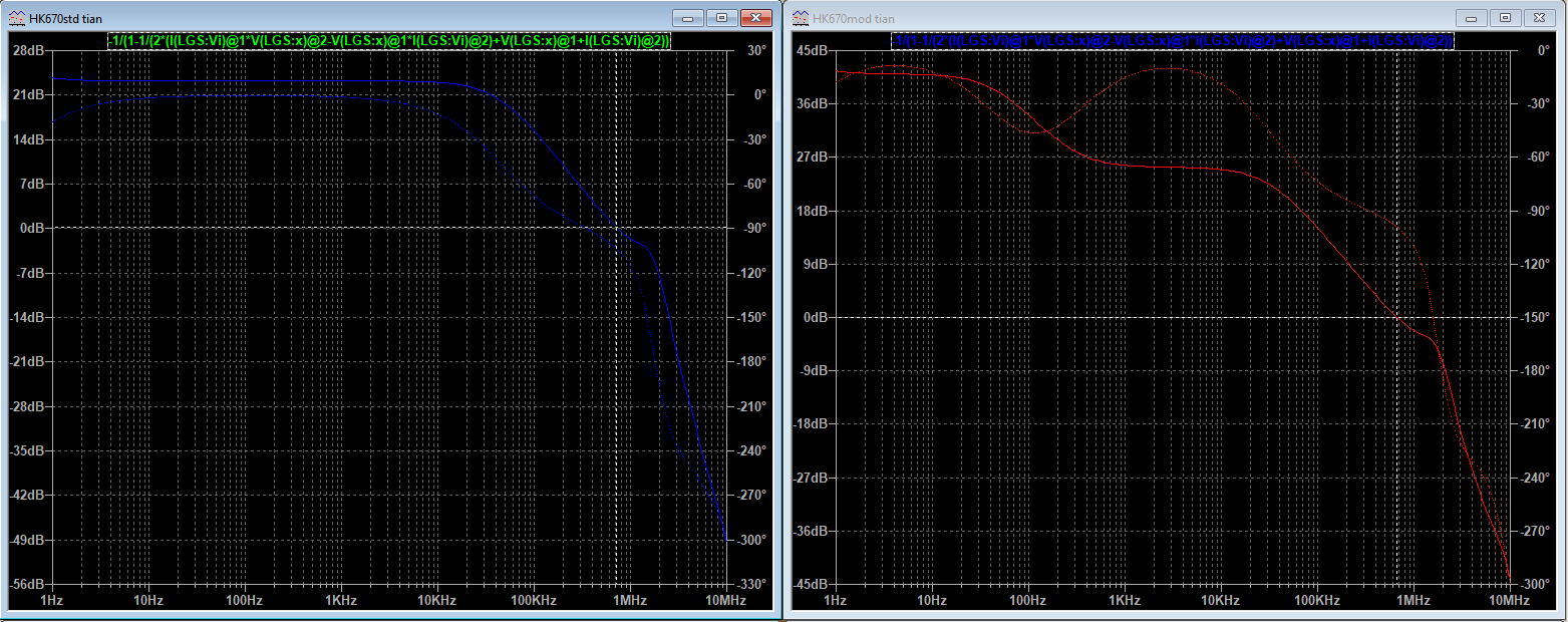

For muting I have seen good and bad in old Japanese. Better ones adding less THD were in Nakamichi for example. Using 25V Vebo high reverse Hfe Toshiba with threshold diodes. I tried to run your sim file by the way but I get an error message "missing schematic(s) of the hierarchy: lg_single".
Ok, I must have forgotten that.. Unzip this to the same folder, or you can remove LGS from the sim if you're not running loop gain sims.

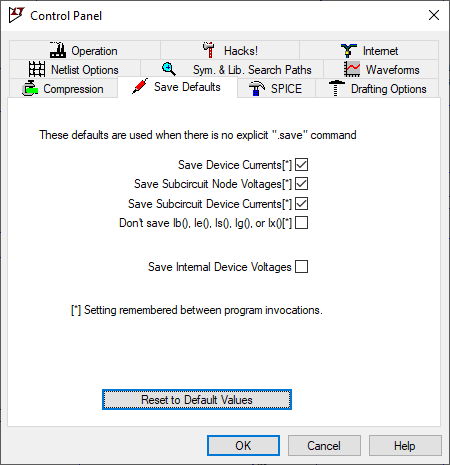

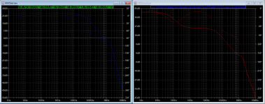

The rest runs and I see smoother closed loop gain curves but when I add trace the blue Tian expression I get Unknown current requested: I(LGS:Vi)

Now we are good.Try checking these settings:
Good!
Just remember that the stability sim is not accurate for stability since some models are not correct. I used the 0dB 'crossing' (unity gain is the correct term I think) as a measure to increase the capacitance of the compensation cap after the mod. Compared it to the standard setup and made sure it was not crossing higher in frequency after the mod.
