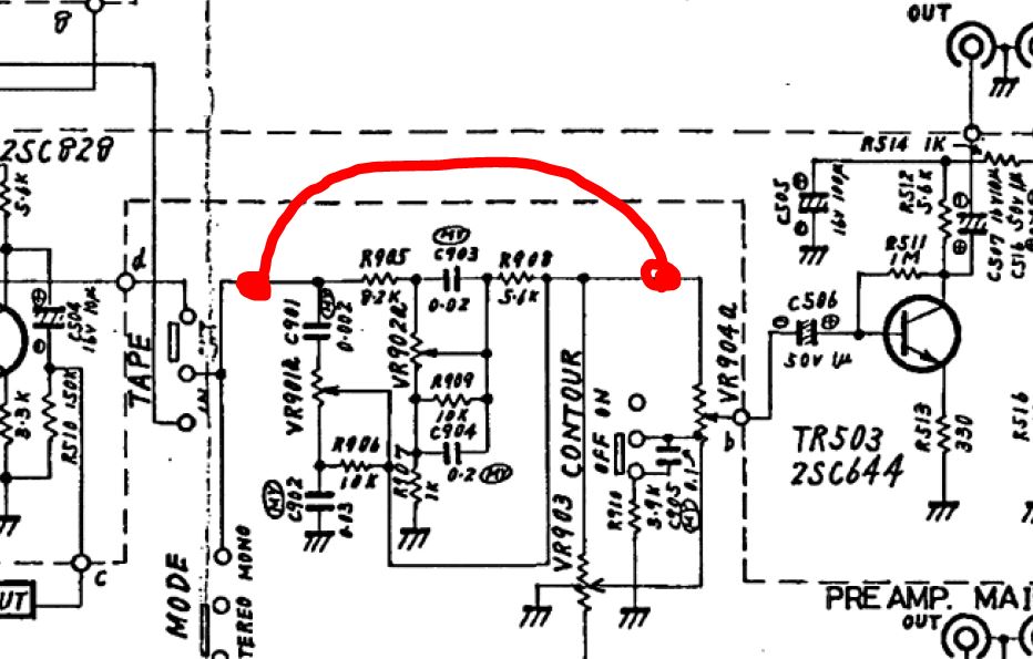

OK So the new plastic Alps pot is in. Didn't fix the problem Argh. Will do some more tests today.
To recap (the thread; amp's fully recapped I've isolated the problem to be at least upstream of the power amps: cross-wiring the preamp/amp in/outs switches which speaker is louder. I thought I'd found the signal balanced before the volume pot and different after, but I'm going to have to recheck that.
The imbalance sounds strongly in the lower frequencies but I believe in overall amplitude as well. One of my earlier scope tests reflected this as well.
The other thing is I get some distortion when I hit the halfway mark on volume. Going to run the preamp into another power amp this a.m. to see if that's also an upstream thing. Running KLH 5's with it right now.

Schematic here...http://www.markmalmberg.com/330A/schematic.pdf
I have traced the problem to the tone board. Approx. in the center of the drawing, look for the word CONTOUR, VR903 is the balance pot. The signals at either end of the balance pot are off-balance. The signals at the TAPE (source/monitor) switch are same.
Any best guesses within that area?

So you need to prove it. Try bypassing the tone stage on both channels. If the problem really is in that area then its just a case of checking the pots and passives.
Good idea and done. Jumpered from TAPE switch to ends of balance pot, signal was equal on both sides and balance pot worked properly. Tempting to leave the balance controls bypassed
Any pointers for checking the components of the tone board? Should I just compare resistances R vs L? I don't think any of the caps are electrolytics (all electrolytics have been replaced).
Although it now appears the problem is indeed in the tone control section one other component is a suspect. That is the coupling cap that drives the stage. C502 or C602. Have you replaced those ? The lower impedance of driving the tone control would show up a problem in that cap.

C502/602 look in the schem like electrolytics and I replaced all the electrolytics in the amp but I'll double check for those. Thx...
Wow, that turned out much simpler than I expected. After so much work chasing this down, I should feel pretty dumb but I actually feel educated
Measured the resistance on each of the four tone pots, treble/bass L/R. 3 of the 4 were 50K, one of the bass pots only measured 30K. Thought about it a minute or two, re-cleaned it (not so easy to get at) and it now measures 50K like the others. I guess some sort of conductive film or dirt must have been in there? I'd have expected higher rather than lower resistance. Anyway, both channels now equal.
