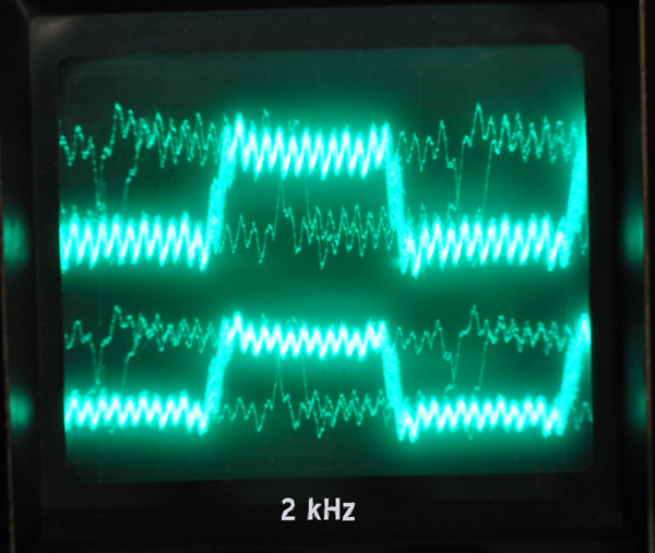

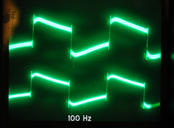

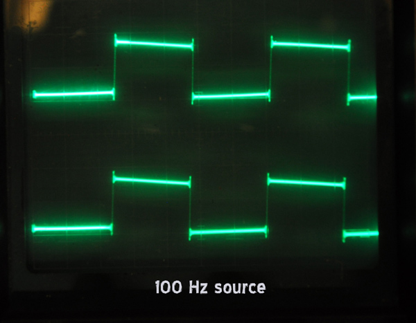

Looks lousy on both channels, and the signal from the phone is nothing to write home about either, garbage in, 2x garbage out more or less. I'll get some photos going. Distortion on both channels but also on the source... Also had a hard time getting the scope to lock onto the output of the amp. Didn't get started yet tracing through the amp, just had time to look at the speaker outputs (with 8 ohm dummy loads).
The 100HZ as a source is OK for testing. The amp should pass that unchanged apart from amplitude.
Not quite sure what the two traces are connected to in each of the shots as both look pretty much identical.
Sorry, those are L & R channels. The phone output is stereo. I tried connecting just one of the rca's and setting the amp to mono so I could look at the exact same signal going through both channels. For some reason that signal was not as clean as if I switched it back to stereo with both rca's plugged in. Anyway, yeah that's just L & R speaker outputs, with 8-Ohm Dale wirewounds. Probably should have both rca's in and switched to mono...
The only comments I would make are that there seems to be a slight amplitude difference between L and R. The top trace "looks" larger in those shots. So you need to make sure that the scope is correctly calibrated first. If both channels of the scope are connected to the same point then the traces should be able to be superimposed over each other with absolutely no difference showing. When you are sure that is OK then check the balance control setting on the amp.
I don't see anything in all those traces that shows a different frequency response in left vs right channels.
Yeah not sure about the scope, although when I was using just one probe and checking back and forth between ouputs with one probe, I was able to see one channel being slightly higher output than the other. This was just looking at sine waves. I checked across a wide frequency range and noted a greater difference in amplitude at lower frequencies. I'd like to re-do that test as I seemed to get different results doing it a couple of times in a row. So I know that either my setup is sloppy, the amp might have an intermittent or unstable problem, or both.
