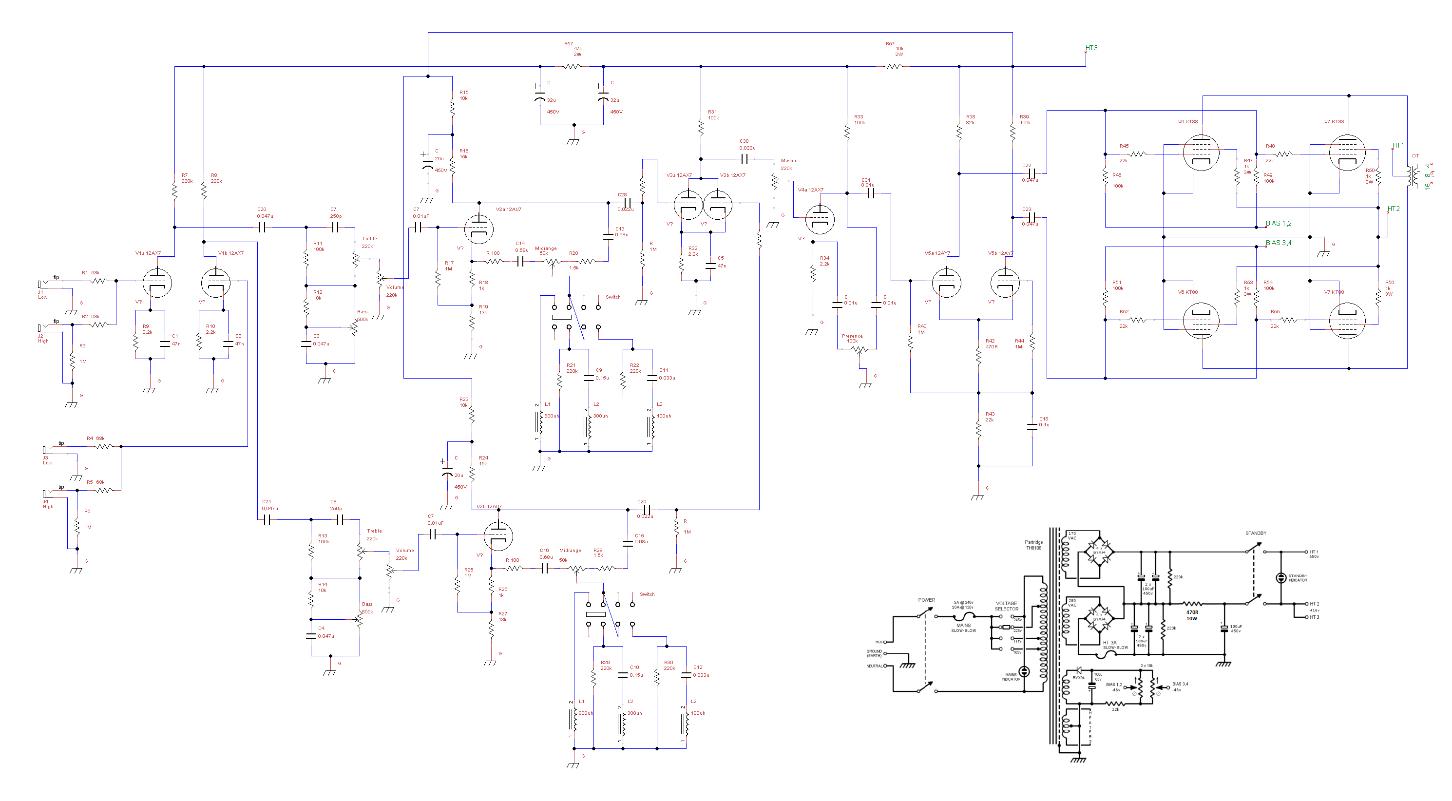

Here I come again asking for help for this Hiwatt replica that I build few months ago. There are the two threads that I received plenty of feedback to finalize the amp.
http://www.diyaudio.com/forums/instruments-and-amps/315831-clone-hybrid-hiwatt-ampeg-4.html
http://www.diyaudio.com/forums/instruments-and-amps/323230-issues-hybrid-hiwatt-ampeg.html
Few months ago I received the amplifier back because for some reason it starts to make a PUK PUK PUK noise. I added a video that shows the noise.
After looking for more info on the internet, I found out that it could be motor boating due to a defective decoupling cap on the power supply. I changed one of the two 100+100 uF cap. Maybe I need to change the second
I not sure if anyone can advise me what could I do.

By OPT I meant output transformer. If you have a multimeter, you can do a continuity check of the output windings - look at the schematic to see where to test. Although a damaged transformer coil is more likely to present as a hard fault rather than intermittent.

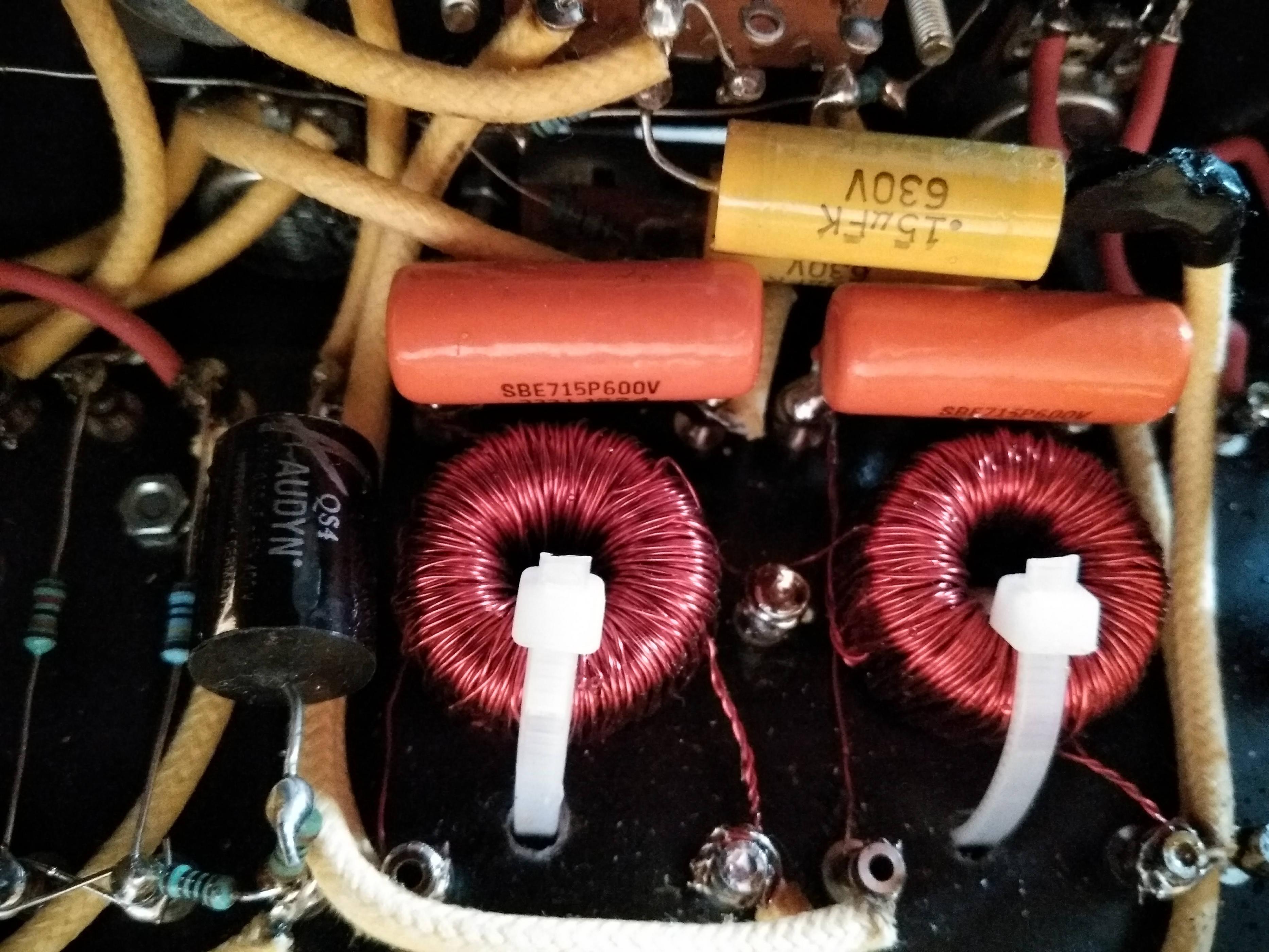

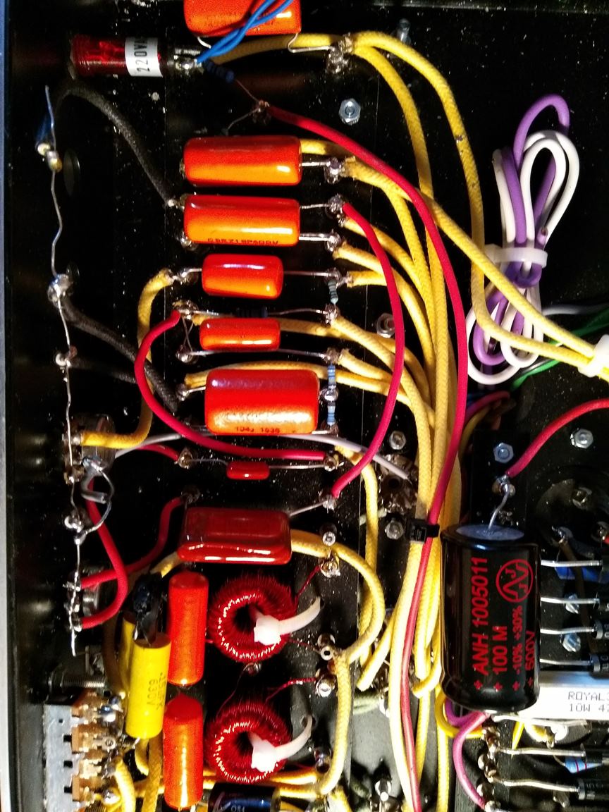

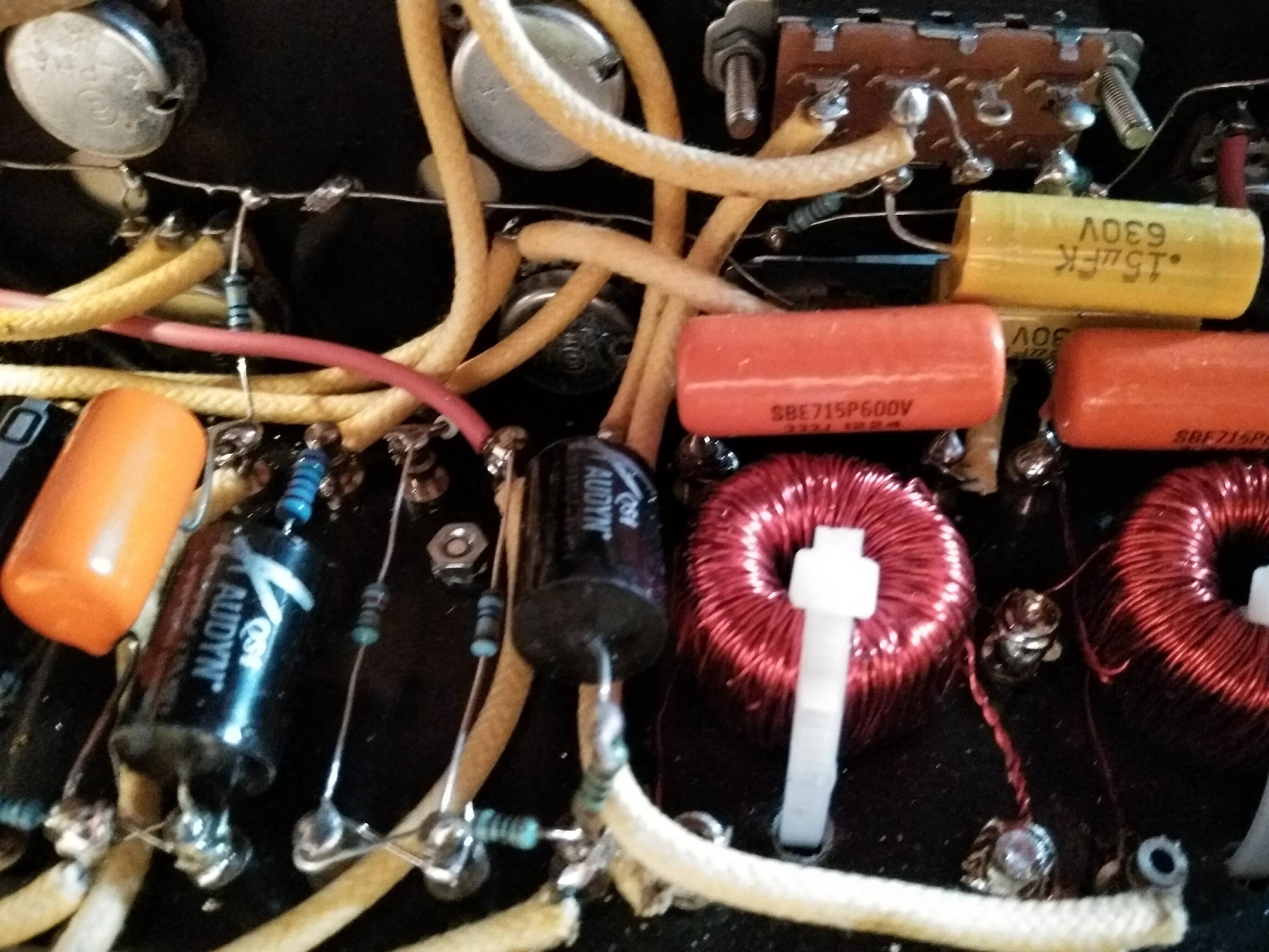

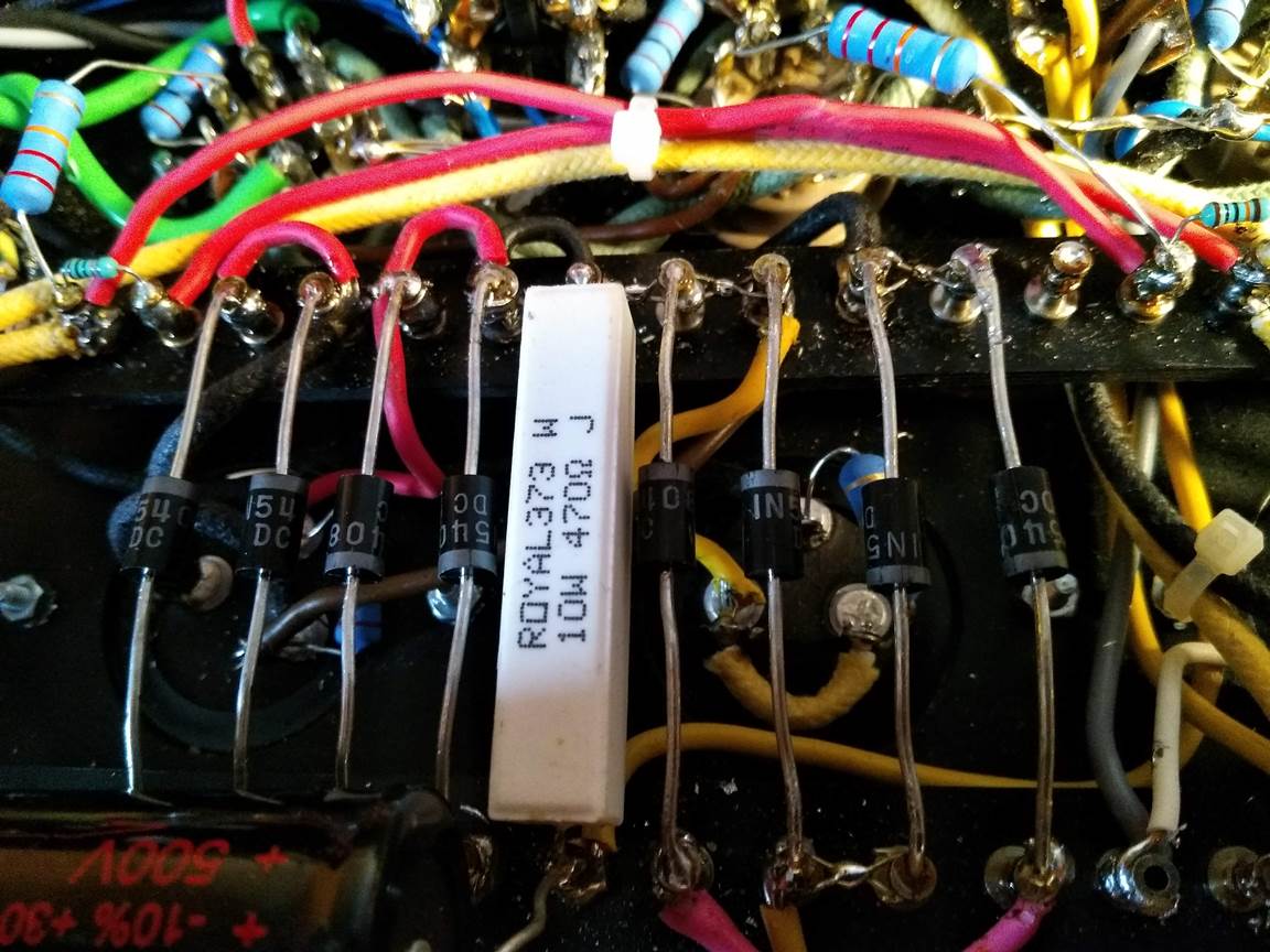

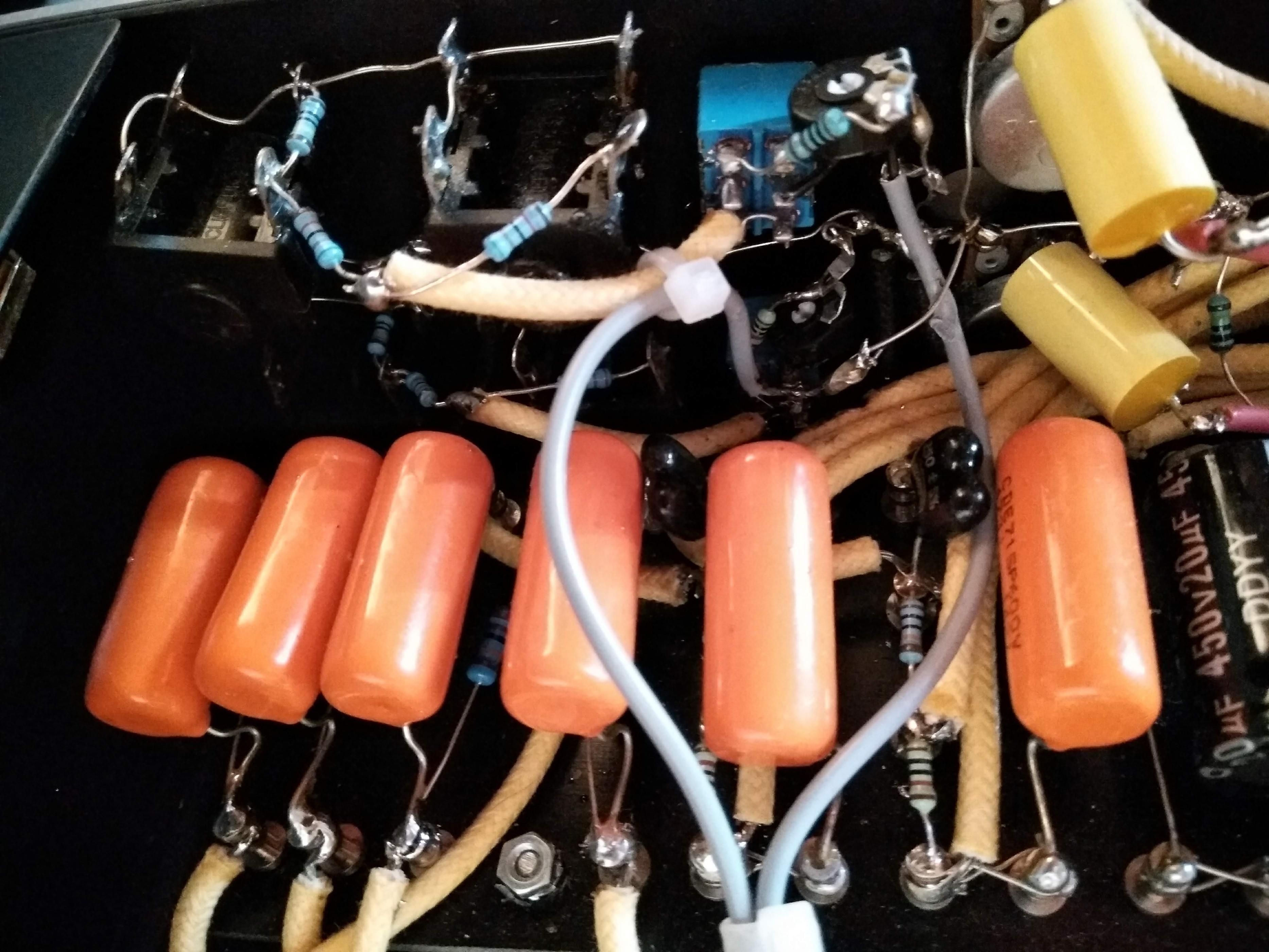

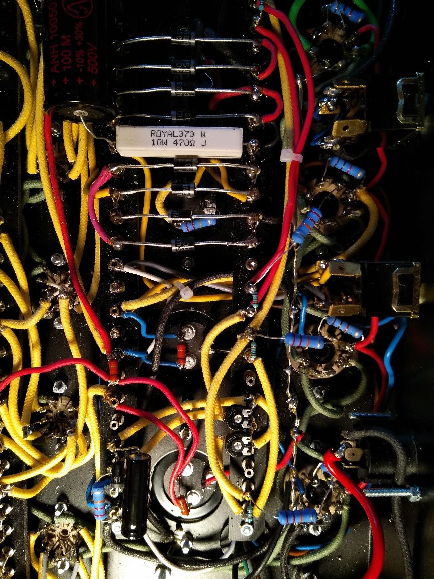

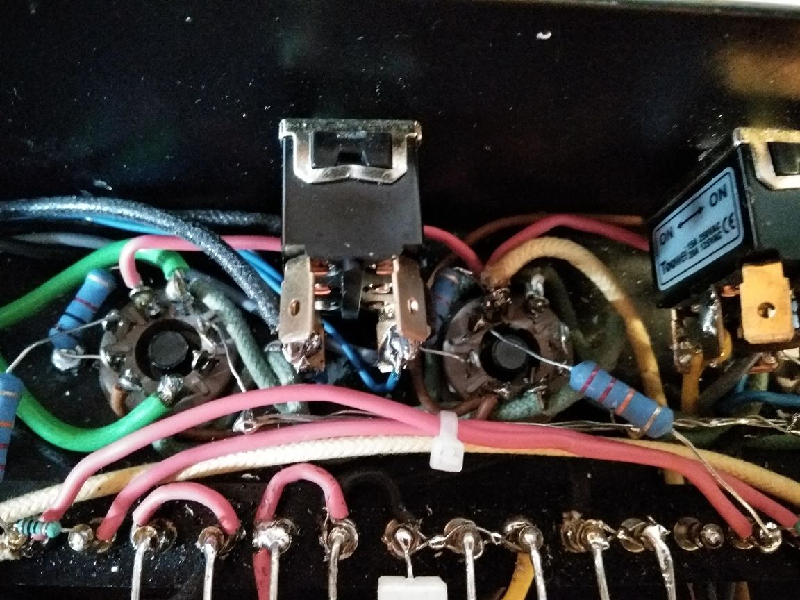

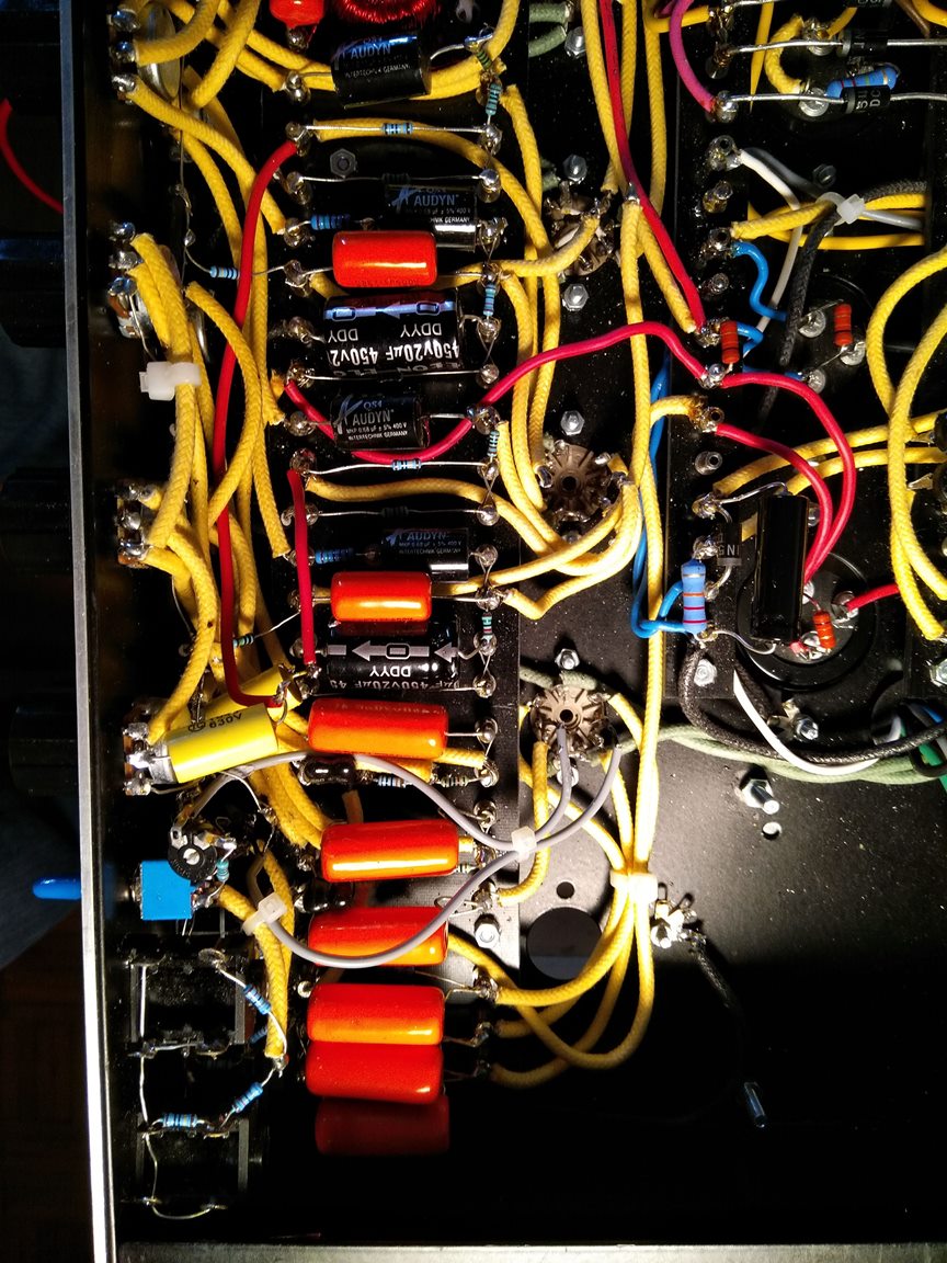

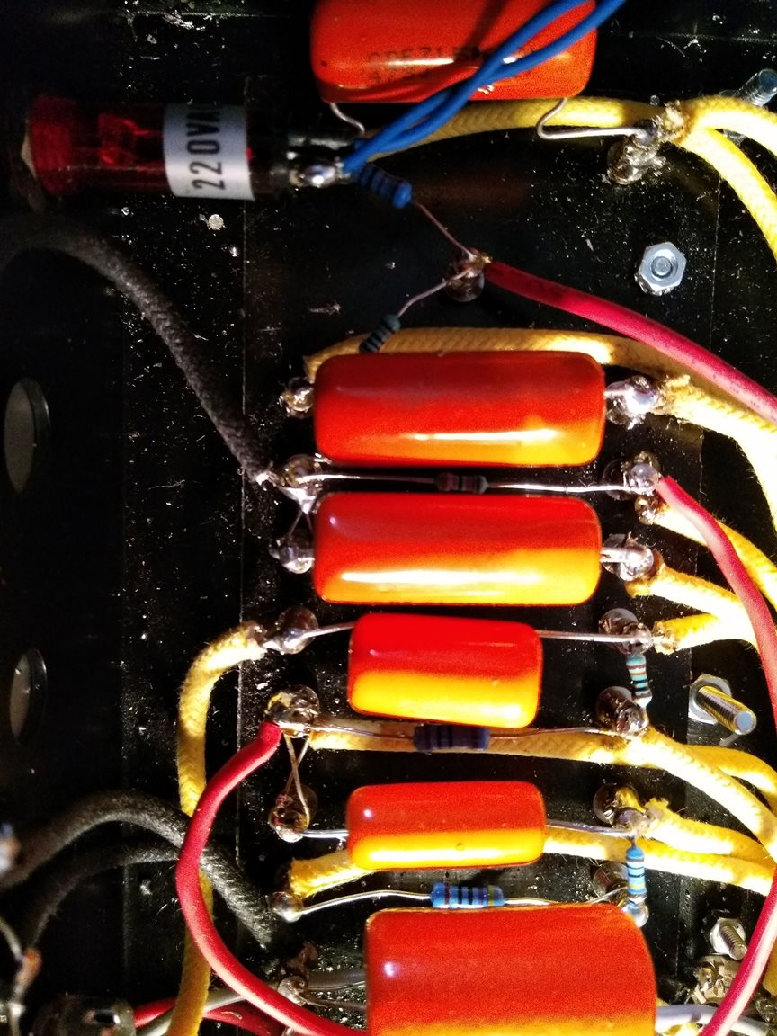

I'll check the solder joints. I'll also attach a picture so you can see how is done inside.

Do you think you could have a look to the pictures that I attached?

I noticed. I reduced the size of the images
