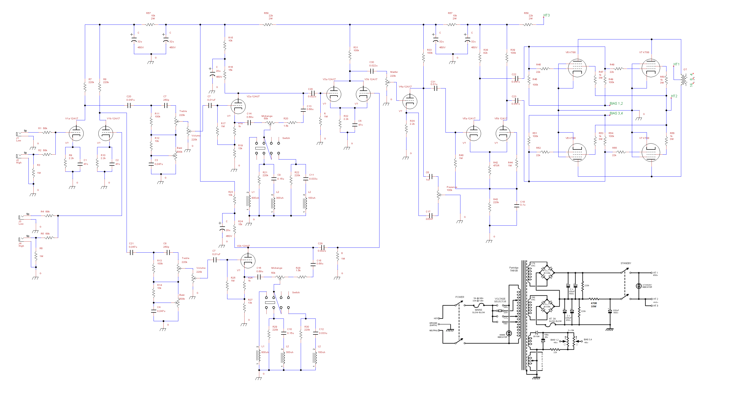

I am building an sort of hybrid 200W Hiwatt amplifier including the midrange circuit from Ampeg SVT. The amp has two channels with Hi/Low. You can see the circuit attached
I just assembled the whole amplifier, and for some reason I have two issues
.- There is an oscillation, like something like a chopper sound, which appears when the volume/treble/master increases. Also, when I play with the midrange rocker switch, the same chopper sound appears
.- There is a dependency between the volume at each channel. I was expecting as I introduced a valve V3 to isolate both channel.
Apart from that, the sound is very clean and there is almost no hum.
Does anyone has an idea about how to solve this?

I see that the wipers of your volume controls are connected directly to the grids of the 12AU7 which are floating above ground potential.
Suppose you run into trouble here, as the position of the volume pots have influence on the bias of the 12AU7s? Guess you would have to add decoupling capacitors.

btw, in your schematic, the KT88s' control and suppressor grid connections are swapped. As the amp basically seems to work in reality this seems to be just a drawing error.

Thank for your comment. Indeed, I thought the same while I was doing the design. However, the original Hiwatt circuit connect the Master directly to the next pre-amp stage.
Actually, C20 and C21 are the ones which are decoupling from HT to the 12AU7 grid.
I disconnected the circuit of the midrange, and the chopper-like oscillation is gone. I suppose there is something wrong there. Also, for some reason the Presence does not affect the audio signal at all
About the KT88, the schematic is not correct. I need to check that, but in the real circuit all is fine.
Do you have any other suggestion?

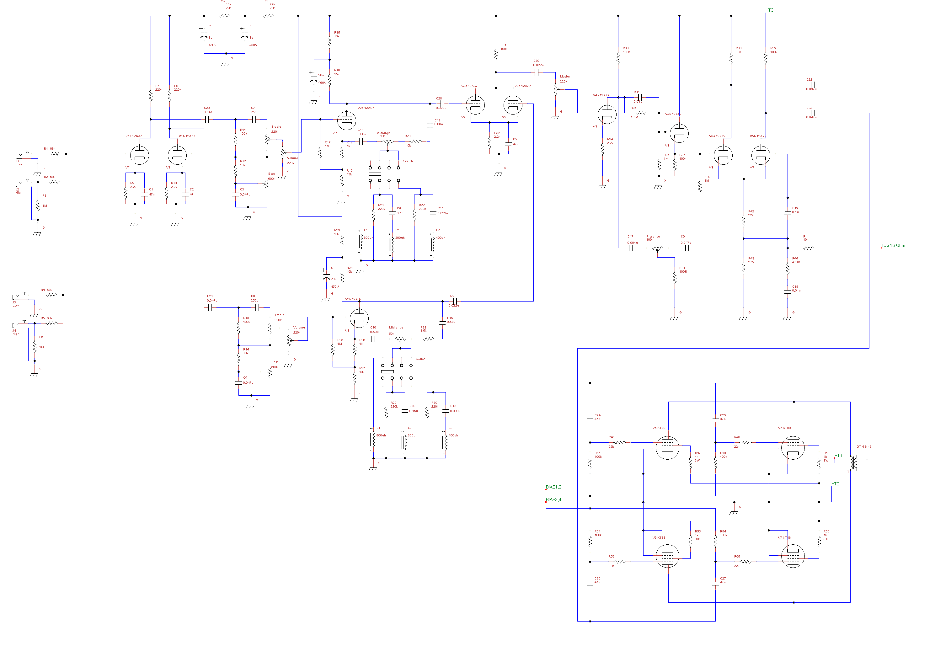

Hi blackwhaleamp,
it is as I told you.
Unlike in the Hiwatt, the grid of your 12AU7 is floating above ground because auf the 13k cathode resistor. When turning the volume control down you pull it to ground. Got me?
Take a multimeter and check it by yourself. You need to decouple the grid(s).
Alternatively, you could decouple the whole tone stack including the volume control from ground, but I see no advantage in doing that.
You need to fix this mistake, chances are your filter section works as expected then.
and one more thing: The grids of your V3 have no grid resistors. (1M from grid to ground). Add them.

No yet, I will work on it this week. In some other forum some guy told me that the power supply is not properly balance. As a consequence, there might be motorboating induced on the amp. If this is the case, the is the reason of the put-put-put sound.

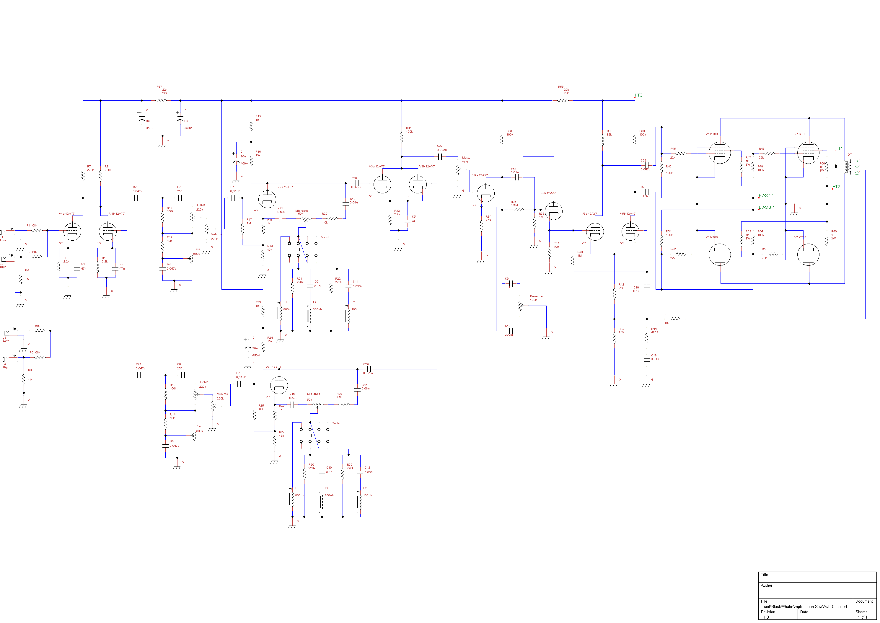

I edited the circuit, this is the configuration that I will try

Yes, looks better now regarding the input of the EQ stage. But the the schematic still lacks the grounding resistors on both grids of V3. I strongly advise you to put them there. With unterminated grids, V3 may be pushed into an undefined operating state.
Adding additional filter stages to the HV supply is certainly a good idea too, but check the plate voltages on the EQ and filter stages afterwards. If the sound suffers from too little headroom you can try to make the filter resistors smaller. Not sure if eg. R58 is necessary, you could try with and without an decide by the plate voltages you reach on the input and EQ driver tubes.

I rearranged the circuit as the one attached. So, the motorboating (aka put-put-put) is gone 🙂. However, I still have some issues
1.- The amplifier is not as loud as it should. I am not sure if I am missing one additional pre-amp stage, or simple there is another thing wrong with the amp
2.- After the modifications, the pre-amp was not working. So, I connected the scope to C28 and C30 and suddenly it works 😕. So now the midrange circuit works (with some noise)
3.- The PRESENCE is subtle, almost unnoticeable.
This really does not come as a surprise. By connecting the scope you discharge the grids of V2 - which have no grid leak resistors. Believe me, they are necessary.
Valves must not be operated with "open" grids. As you have connected them directly to the decoupling capacitors, they build up charge during operation. The data sheets specify maximum values for the resistors (usually 1M for preamp triodes, you will be fine with this. At the moment you are at infinite Ohms).

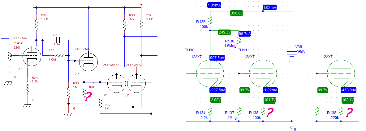

Just discovered:
The problem may have been that you used a 100k cathode resistor instead of 220k. As the PI is directly biased by this resistor it probably did not work properly.
Anyway, with a standard long-tailed pair you can't go wrong, although I would consider using a 12AT7 here.

Do you mean his R37? 100K here works fine.
I checked it, because we know the Fender 5F6a CF runs on the edge of grid-current and its overload distortion is part of the "sound". But this scheme has the 1.5Meg+1Meg divider in front of the CF. CF grid is down near 100V, and it can easily pull 100K or 220K.

Hi PRR,
you're right of course, it does not make much difference. The determining parts are the voltage dividing resistors at the input of the CF. My bad.
But I think the CF's DC output is way too high. About 100 Volts with 350V supply which should not be too far away from reality! No wonder the PI won't work properly. And not the best idea for the cathode isolation. Change the grid resistor to maybe 220k and things look different.
In the Hiwatt schematic both 12AX7s run on a rather low voltage (with a 100k filter resistor in their HV supply), on the clone probably on much more (especially V4a), with a direct effect on the DC output of the CF. Later designs of the Hiwatt pre dropped the separate filtering for both triodes and lowered the input voltage of the CF instead (which only serves as a voltage source there) by changing the grid resistor to 220k.
But it is certainly ok if it works now.
....I think the CF's DC output is way too high.....
Ah! You are right. Taking 350V supply, 102V at CF output, 24K in longtail, and 100K for plates, there is only 33V across the one driver, 68V across the other. (They may self-equalize better than that; it is so jammed-up that I don't care to calculate exactly.)
Tail resistor could be 39K or so for better conditions. The OP could actually observe what is going on and ask for data-based comments.

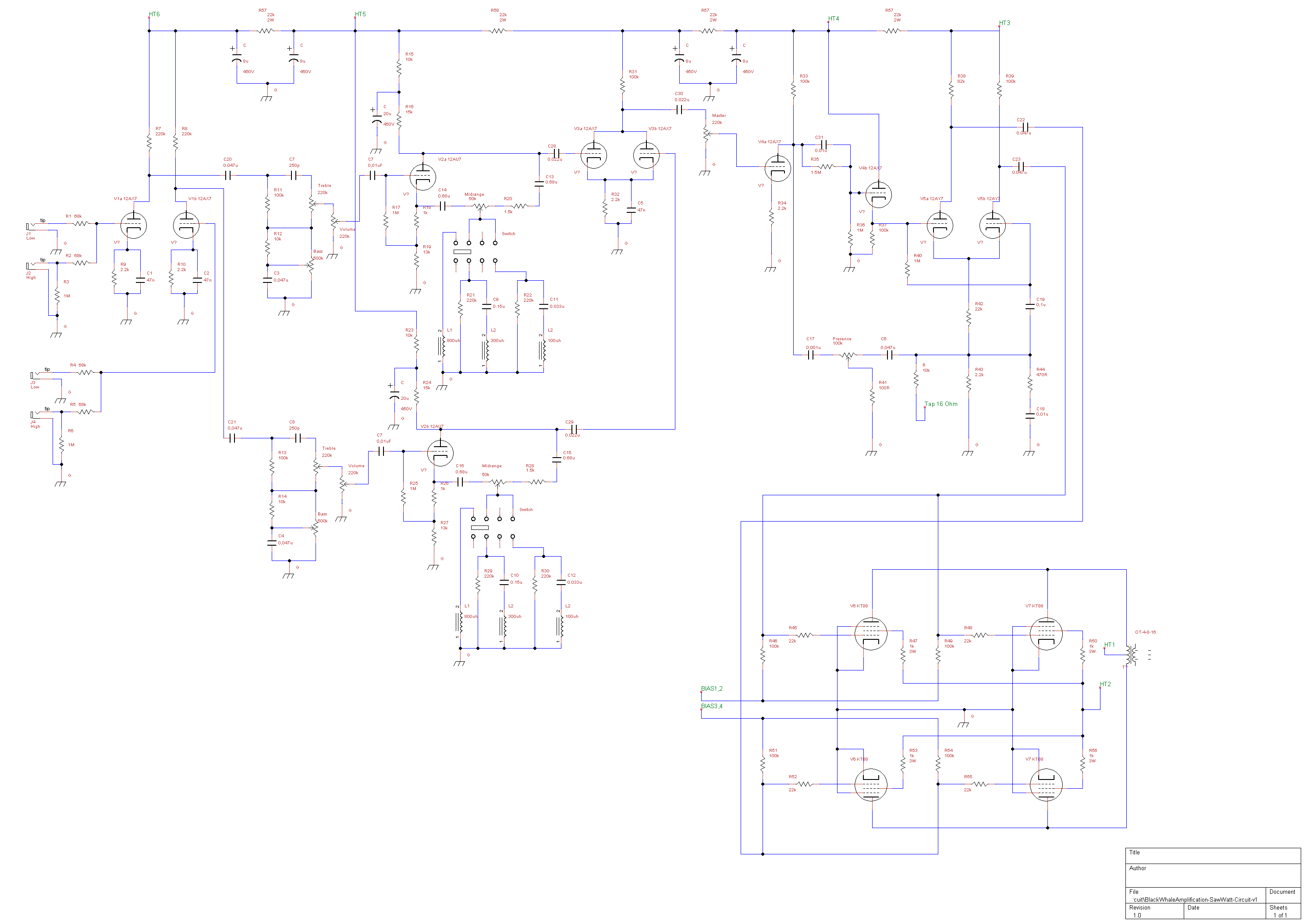

I tested the amplifier with more details, and now there is an issue that still pop up. When the amp is switch ON for at least 10min, there is an oscillation PLUK-PLUK-PLUK coming up. I changed the position of every knob to see if there is a correlation between that, and the oscillation. However, there is not.
I also add another filter stage at the power supply, just to check if that could help somehow. No luck so far.
I attached the latest version of the circuit to this post. I appreciate any help that you could get me
