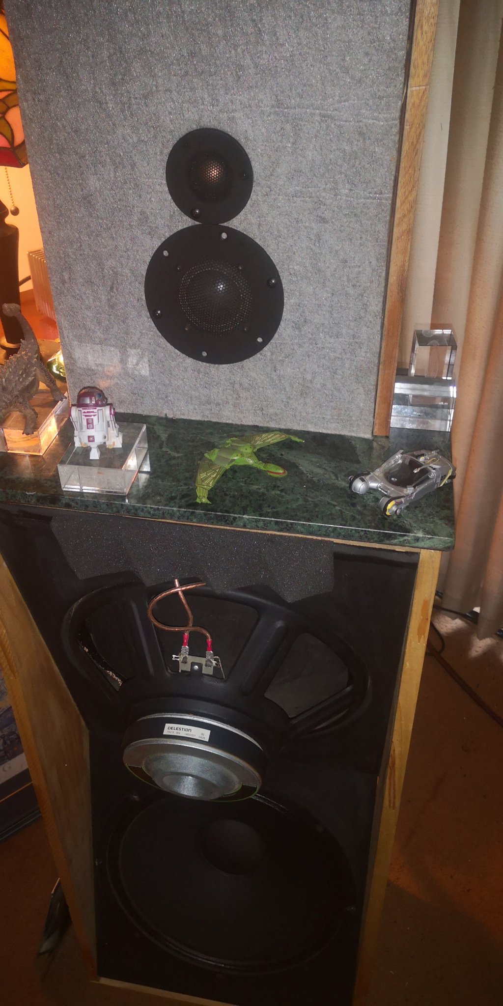

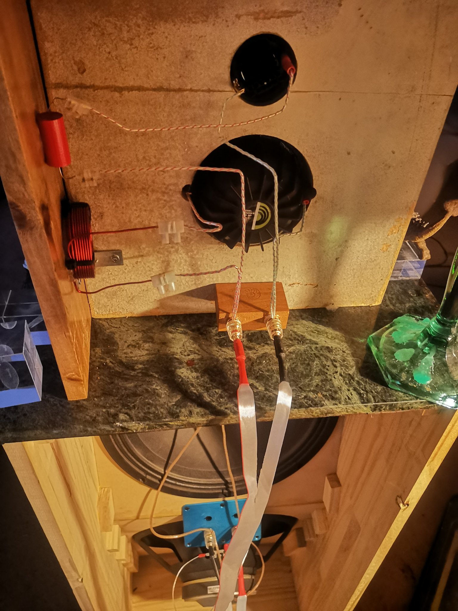

I already have a 3-way using:
Audiopur (I think) ribbon
Dayton RS52an-8
Dayton RS270S-8
It sounds pretty good. I copied Zaphs x-over with a few tweets:
http://www.zaphaudio.com/ZDT3.5.html
Music is good (via TV). Voices on TV are okay, but not great.
BTW I listened to Usher 9950 and 8948a off of my computer I bought from Joe D himself, very poor setup though and Bose 301.
The 301 sounded better to me personally (lol?). That's why I think I might like just 3 inch with SS 22W. Fountek EX88 or EX89 would be my first choice in 3 inch drivers though. I can always change it later, I guess. Fountek drivers seem to be scarce in the US. I try to build speakers for longevity, build quality and easy of driver replacement, also. I mount, finish and construct my speakers in my own way, if it matters.

My main issue with the RS52 combos is that I have to do a lot of attenuation, more than most people, to suit my personal taste.
Right now I have an L-Pad I'm using for the audiopur ribbon tweeter and it is maxed out.
Also I have an L-pad for the RS52.
Woofer in the pic is a Dayton RS270S-08.
The speaker sounds pretty good to me. Few little things I don't like.

If you have to pad down the tw and the dome mid it means that the woofer is too much! It really is gigantic in comparison... I wouldn't go over 7" in diameter... And that applies to every type of speaker at home.
Going smaller allows for 87-88 dB depending on woofer's choice, etc. 🙄
