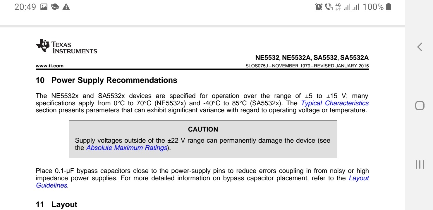

If you are going the regulator route... no heatsinks needed. The current is far to low to cause them to run hot.
Actually I was surprised to find the opposite.

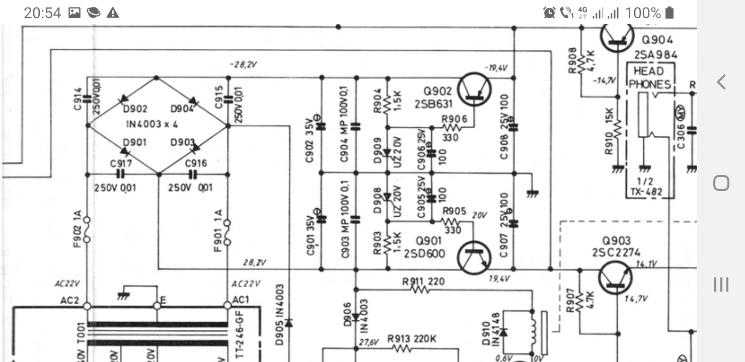

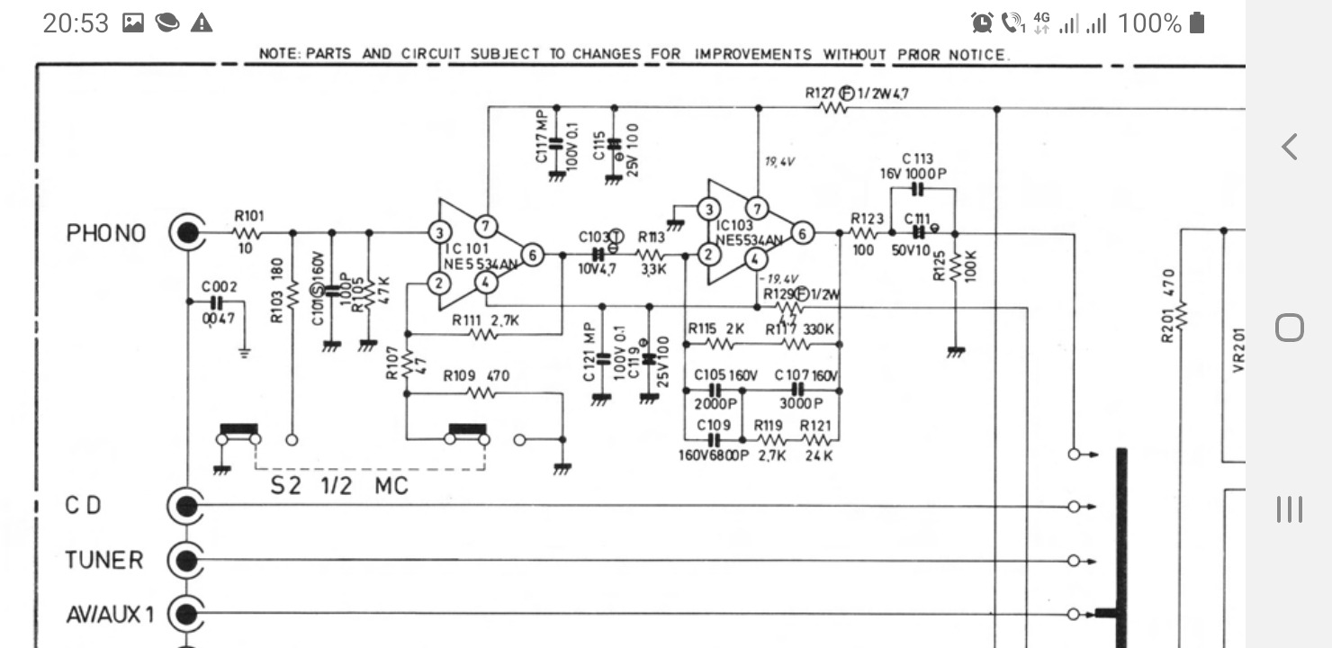

The highest voltage supply design I saw for ne5534 ( which is only half the ne5532 )and has also half the idle current running through it so two ne5534 would dissipate twice as one ne5532 , was in Rotel RC850 +-19.4 V and the people aren't too happy with its sound although it's quite sophisticated and uses 2 stages with one inverted.

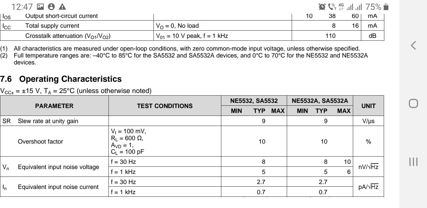

At +-18v supply with a minimum idle current of 8mA for ne5532 , it dissipates 288mW only by doing nothing...and TI says explicitely that the idle current can be twice of that.The dip case can only do away with about 5...600mWatts, so the +-11...15v supply usually found in ne5532 designs has a reason, unless its the SA smd version which can dissipate almost twice the power of ne5534, but that it's rarely found .I have some...never used them yet...
2 x NE5534 would make the ballgame easier at 4min ...8max mA compared to 8...16mA for ne5532.
I don't advertise the use of heatsinks on opamps for fun cause it's no real fun in it...The military versions use ceramic case for a reason.
It amazed me for years why people reported so much different result for ne5534 applications, until I noticed that the more modern smd version actually exhibits better results not because of the superior parameters, but because the case runs colder being usually in close contact(even glued) to the pcb, often having a groundplane attached and the case is also thinner transmiting the heat easier to the pcb .
When reworking older designs you don't modify the existing pcb...so you can only do away with the heat by using heatsinks...

I was talking about the dissipation in the ne5532 op amps with a differential voltage of 36V x an idle current of 8mA (minimum current), not the regulators or series resistors.
