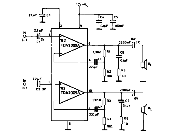

I have build my own amplifier with TDA2009A, its quite same with the datasheet information. Well..... now i used a breadboard to do the job, it produce a hissing sound even i don't connect to anything (also when i connect or play anything).
So its quite sure that it is a amplifier noise, is there any way to remove that noise ?

all amplifiers produces hiss. Some produces hiss at a very low level and so you cannot hear it. How close are you to the speakers? At normal listening distance do you hear the hiss?. How efficient are you speakers, the more efficient, the more hiss. Does your amplifier use an input resistor? what value is it? If it is high this can produce some hiss. Is the gain of your amplifier high? The higher the gain the more hiss. Can you get by with less gain? If you short the input of the amplifier does it still produce a lot of hiss? Does your amplifier have a volume control at its input ? Post your schematic.

My input are direct connect to amplifier IC through capacitor only. no resistor between.
The last speaker have gain of 55db, and this have 36db, but the hissing is kinda at the same level and not much different.

between the input pin, and ground try a 10kohm resistor, also as sreten says the gain of your amplifier is very high try replacing those 18 ohm resistors R2, R4 with 36 ohm resistors. You might even try 72 ohm risitors for R2 and R4( or closest value). This will still give you lots of gain about 18. Most computers will output at least 1 volt. This chip is rated at 10 watts per channel. So even 1/2 volt * 18 will drive your amplifier to clipping. Lowering the gain should reduce the hiss somewhat,

There is a "noise cancelling" active headphone that probably has some effect on motor noises and gunshots and firecrackers. Shorting the input to ground will prove whether the hiss source is the amp you built (hiss still there) or is the amp gain amplifying the hiss from the source (computer?) ie hiss gone. Usually turning down the output of the preamp and having high gain on the power amp maximizes hiss.

R1 = 1300
R2 = 68
G = 20.log(1+R1/R2) = 26.1 dB
I would try 47 ohm (29.1 dB)

Hissing can also be HF/RF oscillation, which these old TDA series amp ic's are notorious for.
Personally i'd throw away these TDA pieces of **** and get some LM1875 or even better LM3886, with these you can never go wrong.
