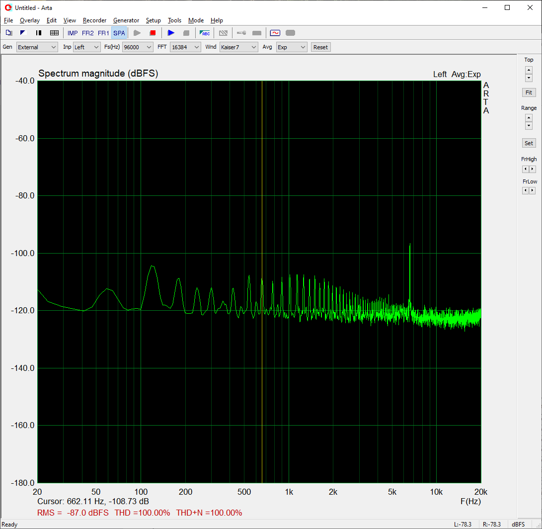

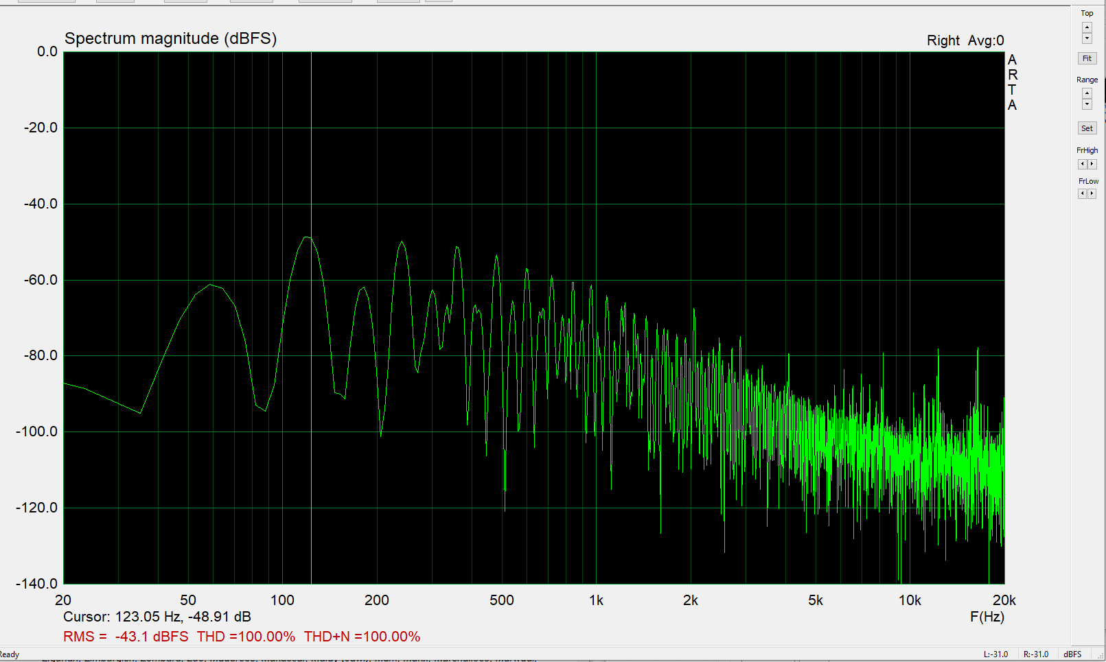

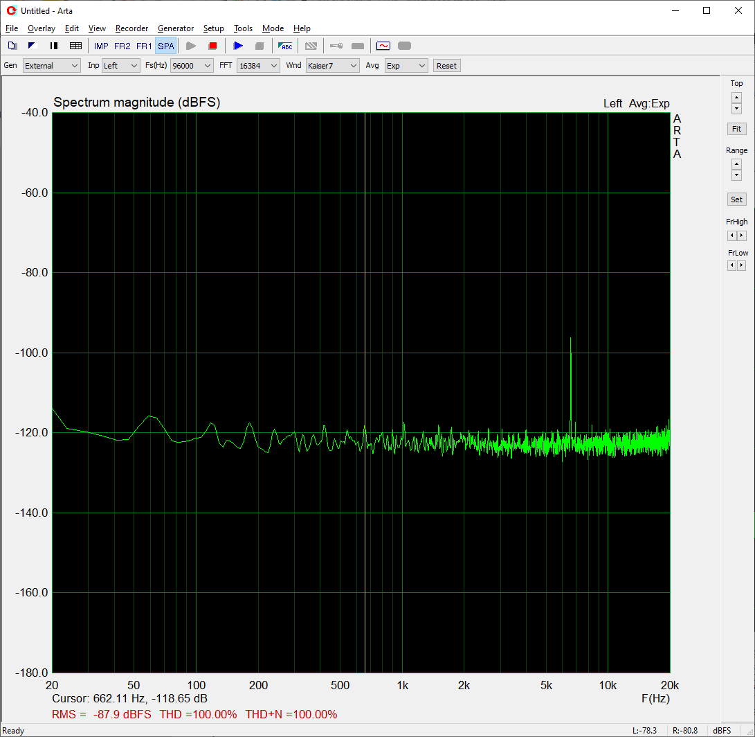

I was able to adjust the DSP/DAC and view the frequency response via soundcard input but did not reduce the hiss.
However, I have now observed via the frequency response on the pre-out that perhaps the hiss I am hearing is actually 60 hz hum and harmonics.
Pre-out signal with Direct Mode on:
Pre-out signal with Direct Mode off:
(I think the spike at ~6.5khz is related to the sound card itself)

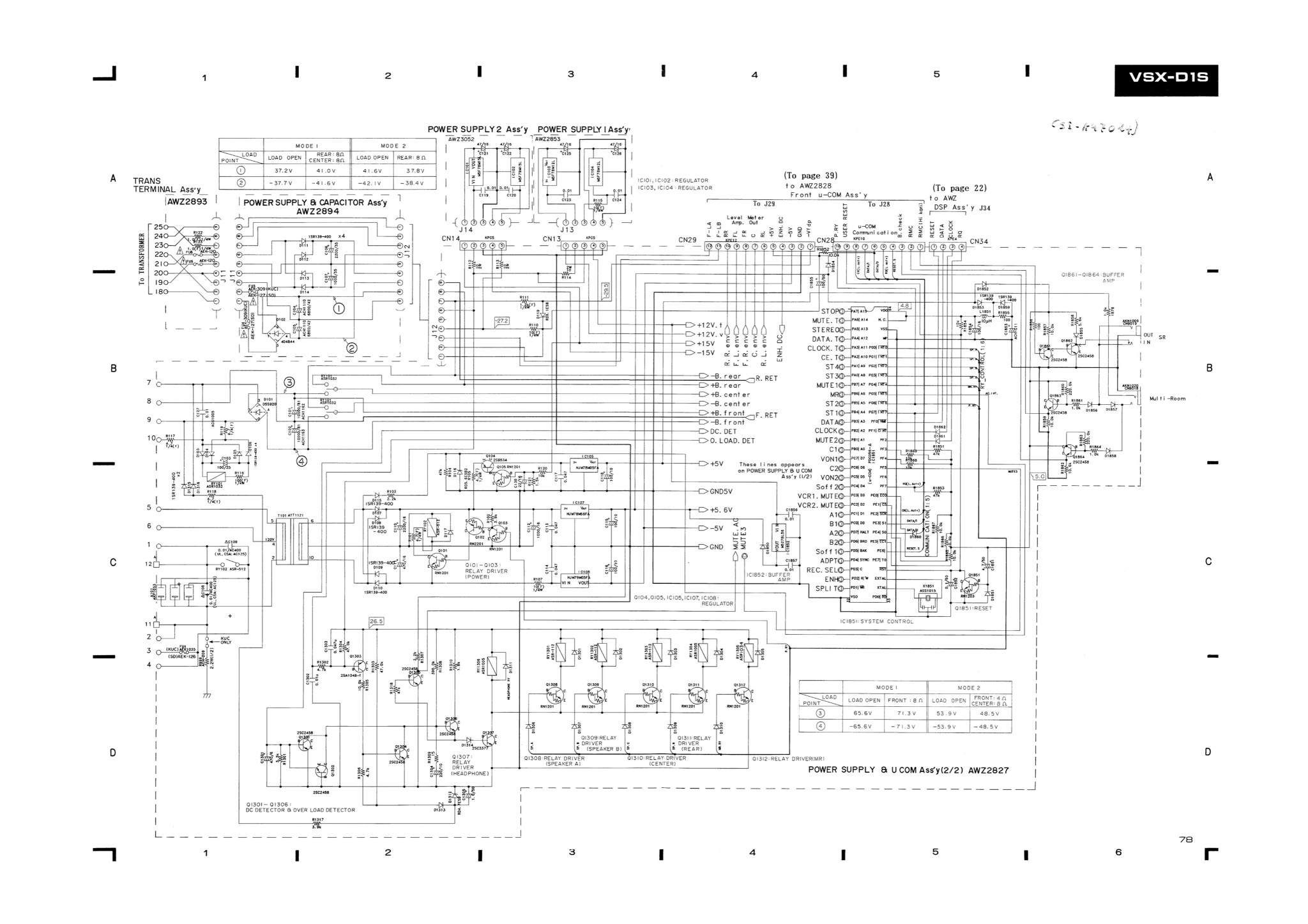

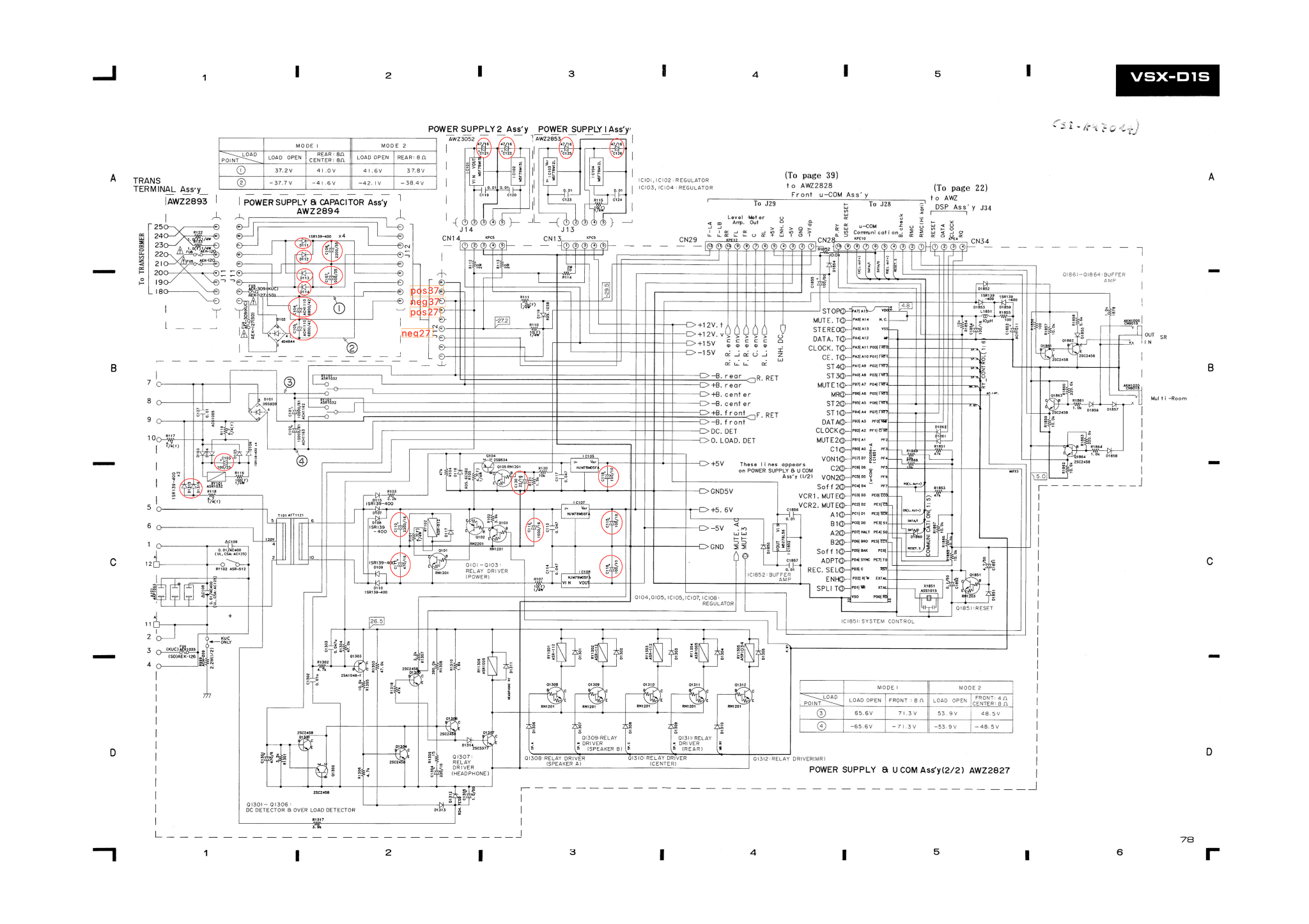

Thinking that it is power supply related, I replaced as many related electrolytics caps as I could (circled red in the power supply schematic excerpts below)
However, that still does not fix the issue.

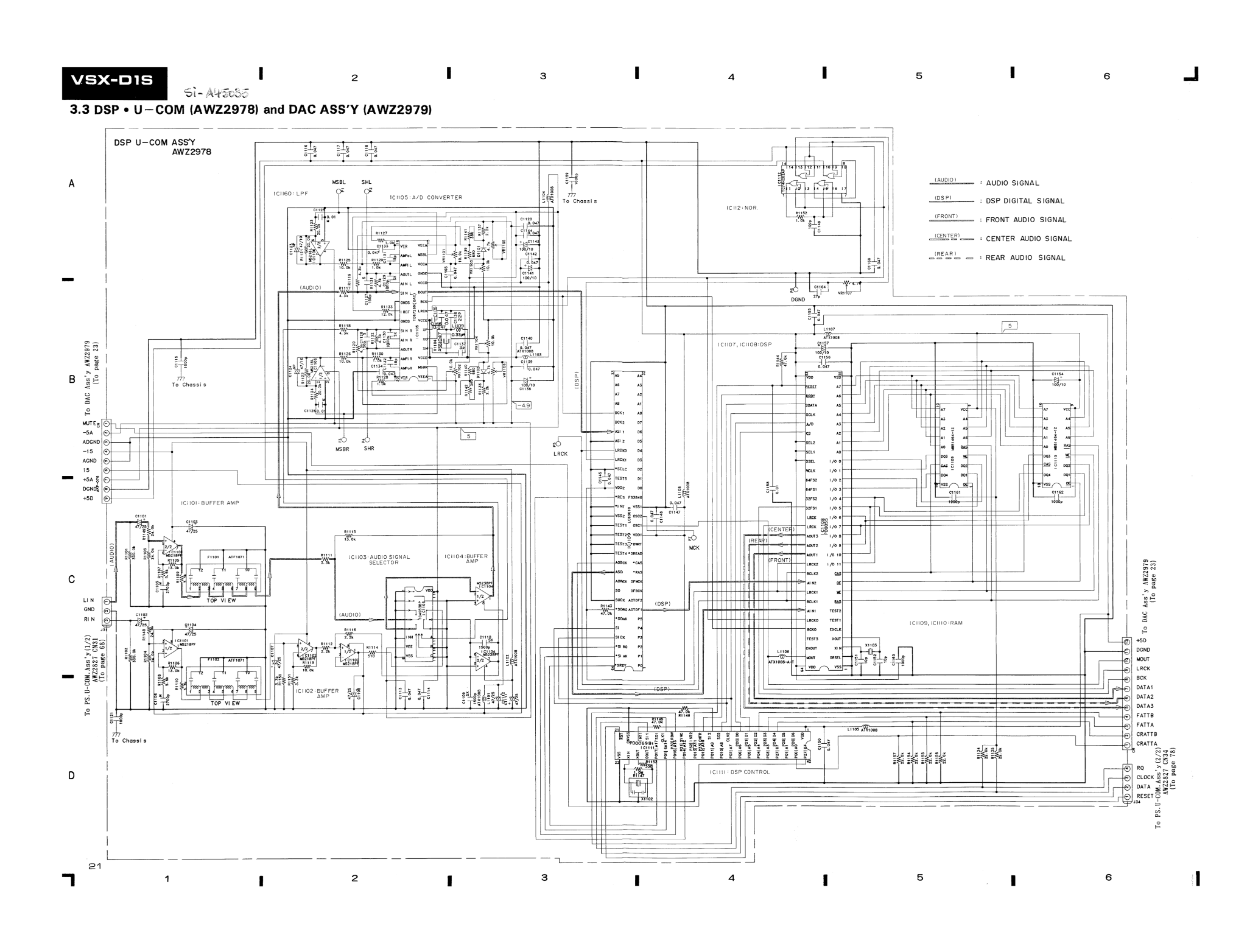

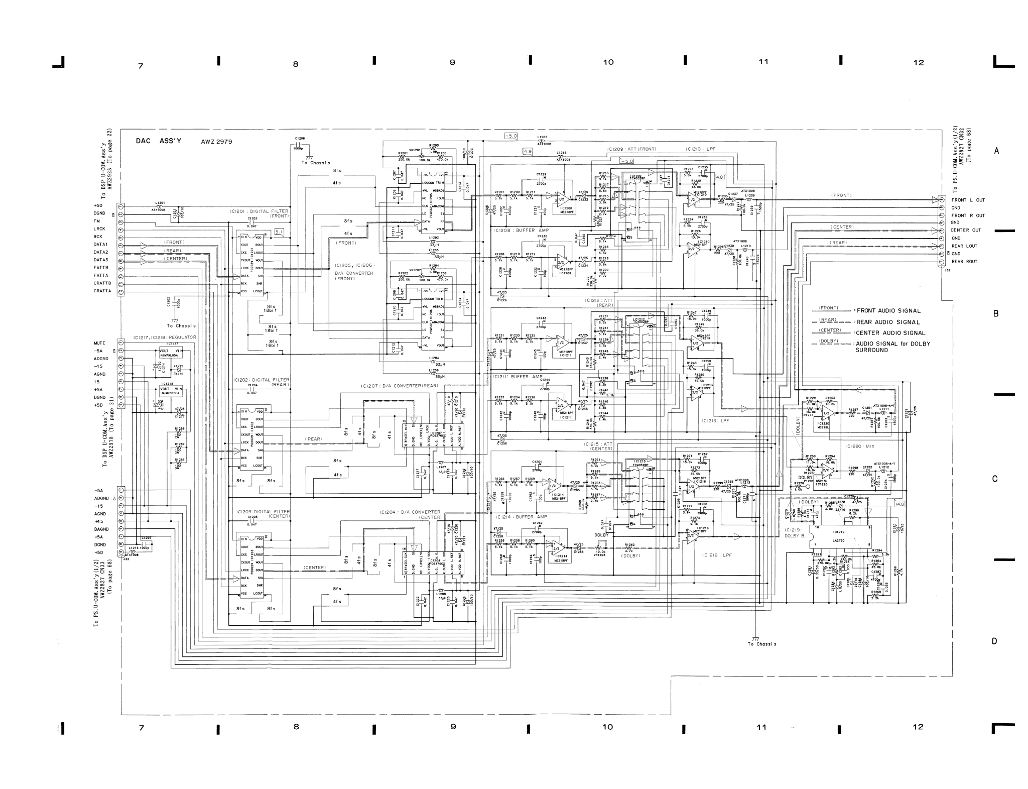

The DSP/DAC board uses +5, -5, +15V, -15V for various devices and I see that the +15 and -15 are used for many of the buffers.

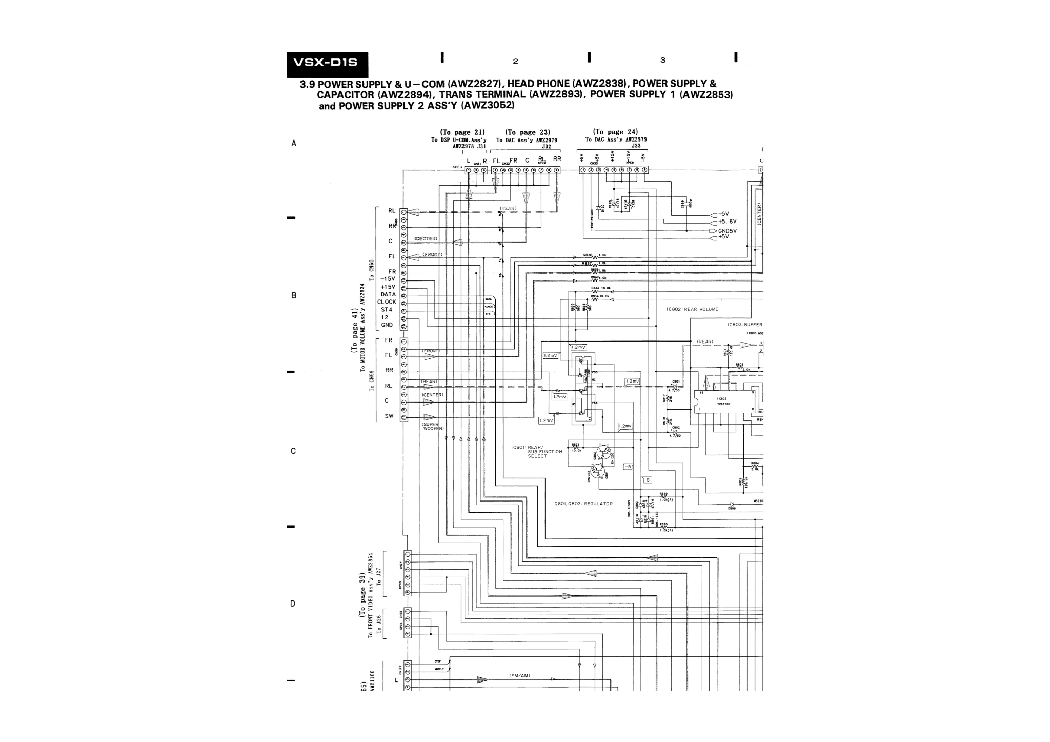

DSP/DAC schematics:
The +15 and -15 used for the DSP/DAC board seem to be formed from the "pos27" and "neg27" lines (power supply schematics).
"pos37" and "neg37" I believe is used for the main speaker output, and is therefore used whether Direct Mode is on or off.

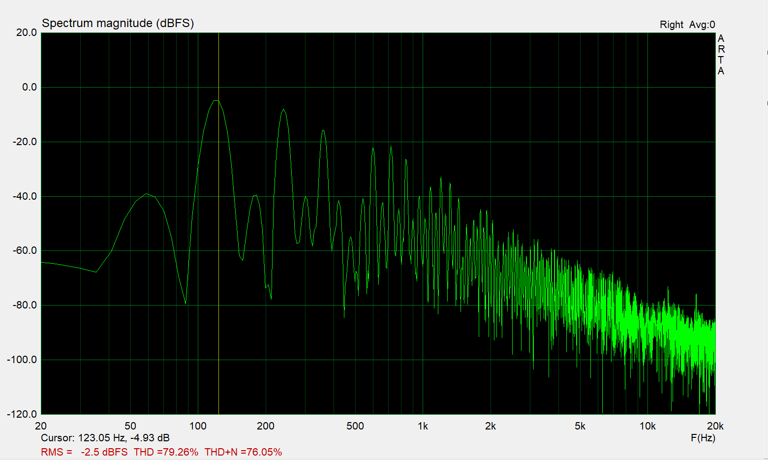

To investigate, I built a DC blocking circuit so I could use the sound card input to see if 60hz and harmonics are on the power supply rails.
From the power schematics above, the frequency response for the following points are:
"pos27":
"neg27":
"pos37":
"neg37":
Questions:
1) Does the pre-out signal frequency response difference between Direct Mode on and off exhibit a power supply issue?
2) Can the increased magnitude of the 60 hz harmonics on the "pos27" and "neg27" lines contribute to all noise I am hearing when using the DSP/DAC?
I am definitely not an EE nor any kind of expert on circuits, but am willing to listen to any suggestions! Thanks!
