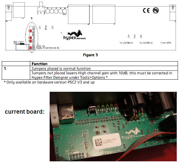

i have a 103 db tweeter hooked up to a mini dsp 8x8 and if i turn the volume down -24 in the software i can barely hear the hiss @ 5ft.
Again...the easiest solution is to reduce the gain in the HF channel. The so-called-noise-problem is due to the used DSP nothing else. Probably we can help by modding the HF channel.
Hi Jan-Peter,
The manual of the current PSC2-400 states that there are special jumpers that can be removed to remove 10dB to the HF channel.
Looking at the PSC2-400, those 4 jumpers appear to be small solder leads that need to be removed.
What is the preferred method for an inexperienced user to remove them without damaging anything?
