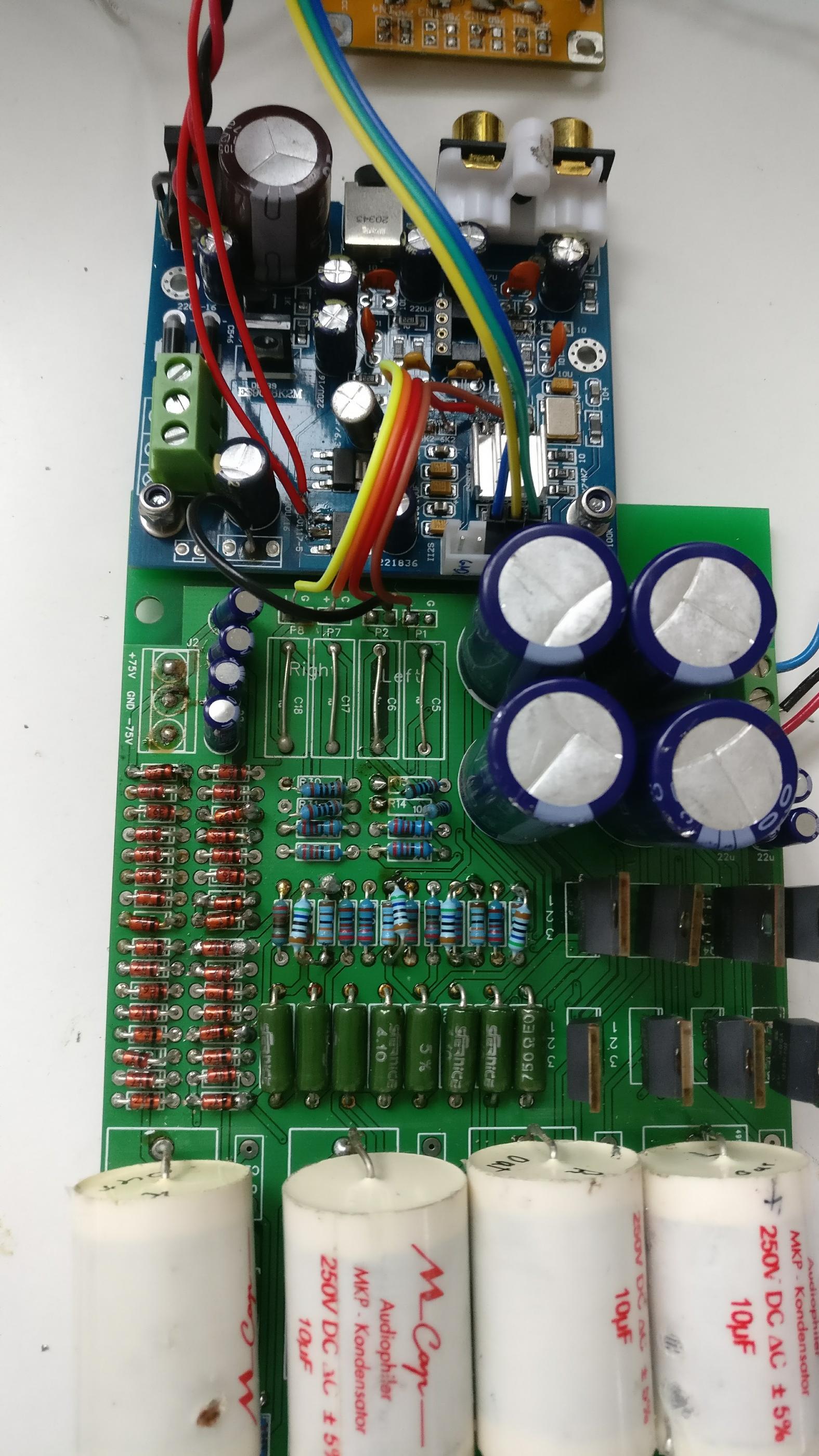

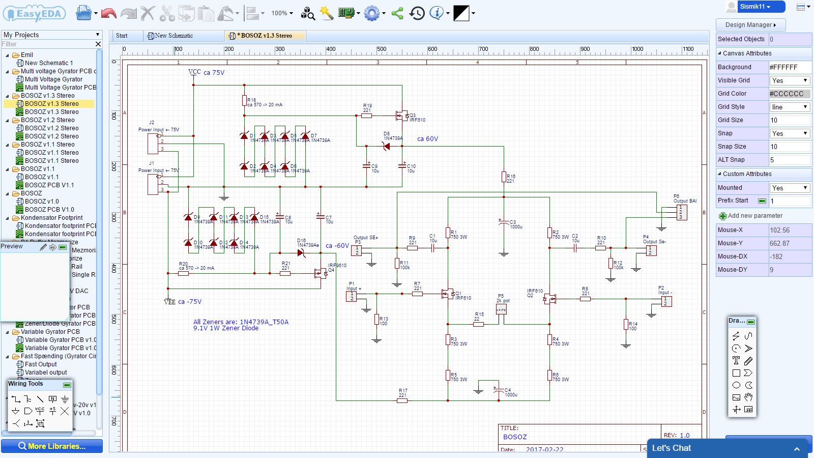

Thank you for you replies and sorry for the lack of info. Here are some pictures and a diagram.
@ Zen Mod

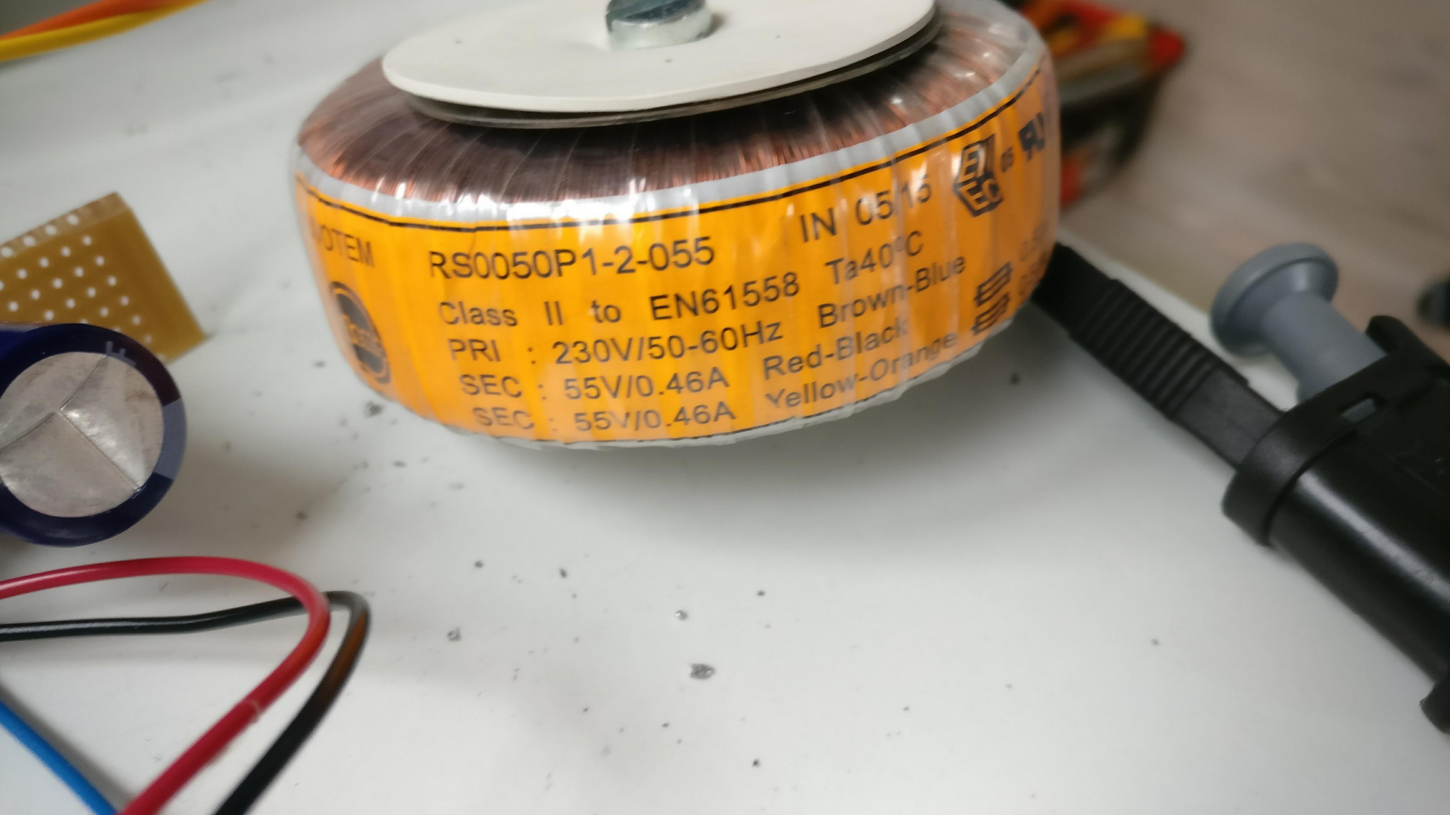

PSU is like the original only I use a 2x55V trafo
Common Ground on all channels. (I came across EasyEDA online circuit design, and I made some PCBs 🙂 )
Hiss is the same on all 4 single ended outputs (and 2 balanced). No difference.
@ Juma
You are right about input impedance. I use 100 ohms at the inputs. 😛
I can make it work I voltage mode, but I wanted to try current mode and I hoped this circuit could provide the gain I needed and be silent at the same time.
Some extra info.
The 1st time I tested the setup, I accidentally mixed up the positive and negative supply voltages. This of course resulted in some popping caps and blown zener diodes. I have replaced all blown caps, and all 8 transistors, plus the broken zener diodes.

first thing I'm going to object is 20mA through zenners ......no more than 5mA
next - C5,C6 ,C17,C18 - I can't see them on schematic, so dunno why shorties ?
next - messy zenners - is there any possibility that you fried any of them during soldering ?
I hope you replace all caps, not only blown caps.
If you count on PSRR you need good matching of IRFs and resistor. (left-right)
R16 and R17 should be 22.1ohm, on your schematic is 221ohm.
Potentiometer could be noisy, try fixed resistor.

1st: The missing C5,C6, C17 and C18. They were input caps for blocking DC. I realized I didn't need them (correct me if I'm wrong) and thus shorted them. That is why I left them out on the diagram.
2nd: The zeners. This might be the culprit. I initially had calculated with a current through the zeners of 3-4 mA. But for some reason the 9.1V zeners gave a voltage of over 10V yielding a total of 71V in stead of 63,7 V. Increasing the current seemed to fix this the problem, hence the 20mA.
Yes the zeners look messy. There are 2 reasons for this. The 1W zeners have fairly thick legs. I did not take this into account when designing the pcb, therefore the holes for the zeners are only just large enough for the thick legs of the zeners. This made the assembly a little difficult and resulted in messy looking zeners 🙁. On top of this I had to remove some of them after my initial accident, making it even worse 🙁 🙁. I think I will order some new ½W zeners.
@radule
R16 and 17 are 221 ohm and you are right that is an error. VERY well spotted. I will fix this.
I did not replace all caps. Only the ones that popped. I will fix this also.
I tried replacing the potmeter with fixed resistors. It did held a little, but nothing major.
Regarding matching. I was under the impression that it wasn't that important. Read from Pass Labs: "It is not essential to match the MOSFETs used in this project, but it doesn't hurt either. I have tested the circuit with matched and random parts with insignificant performance differences."

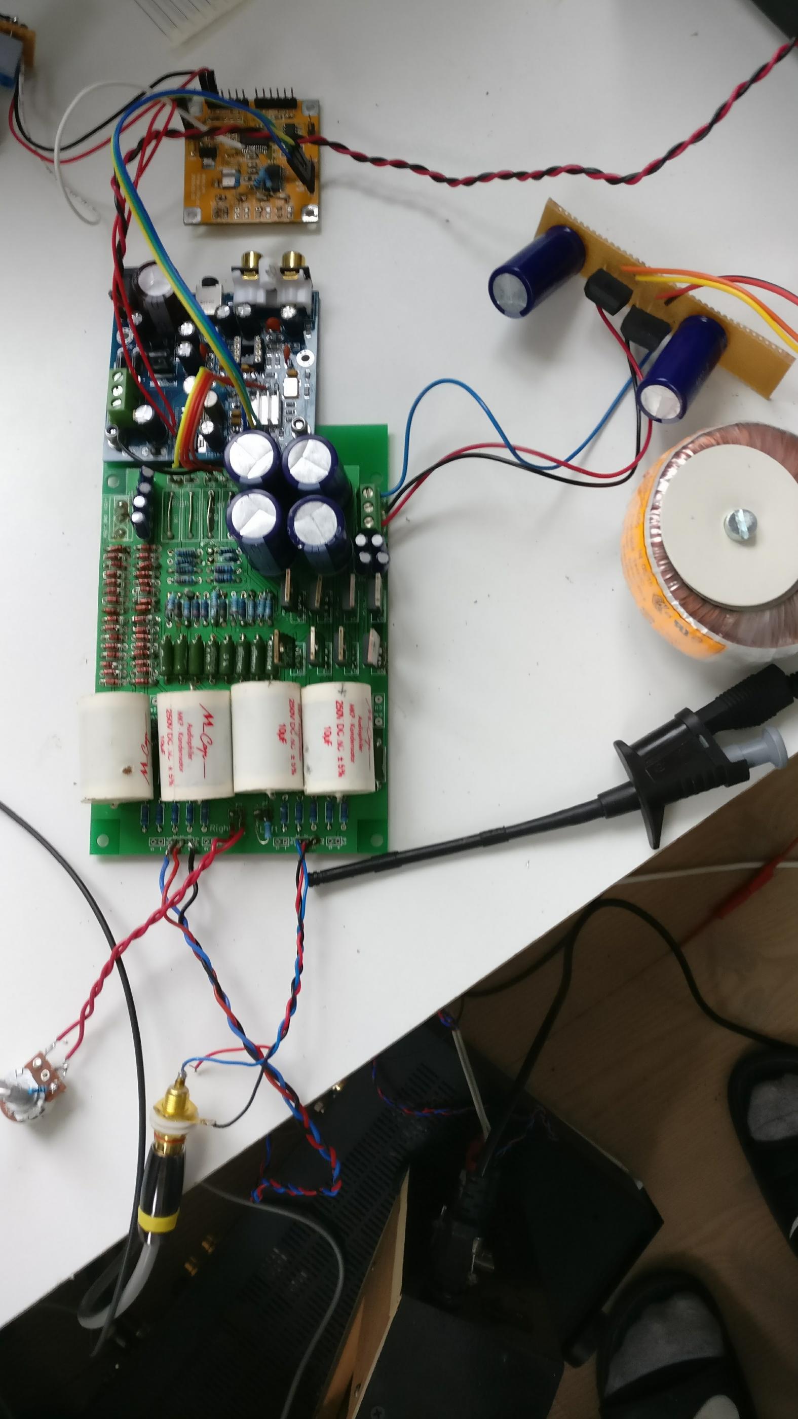

OK time for an update.

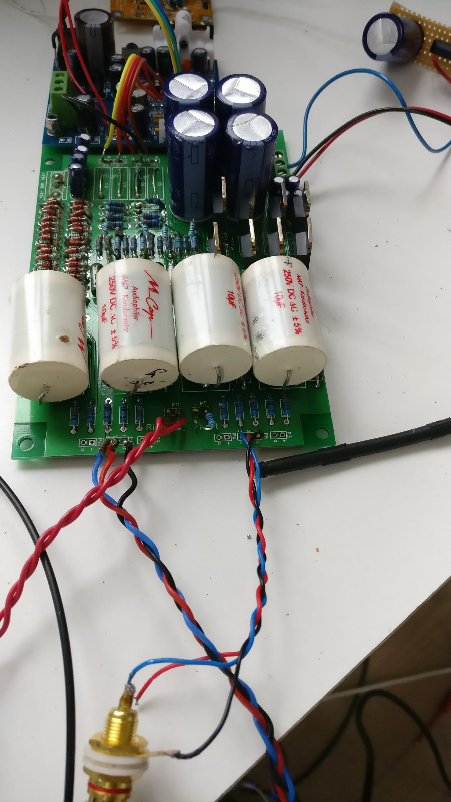

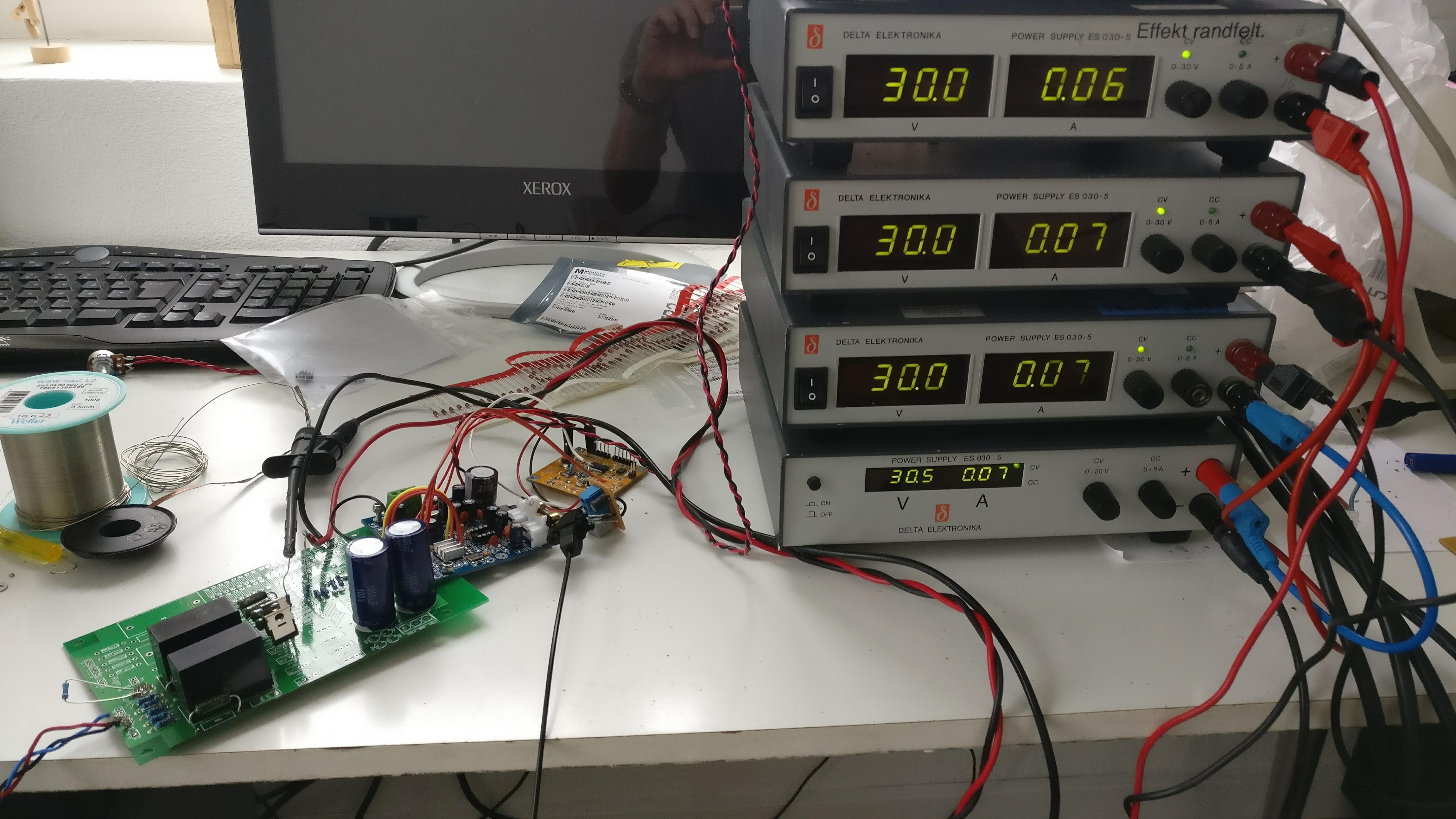

I made a setup of 4x 30V PSU’s to get +-60V. This way I could bypass the power section to eliminate any possible errors there (see pics). Result: No difference. Still an audible hiss.
I then decided to build a new stage. This time I didn’t built the power section to keep it simple. In this build I used new components, so everything should be working correctly (see pics). Result: No difference. Still an audible hiss that increases with the gain.

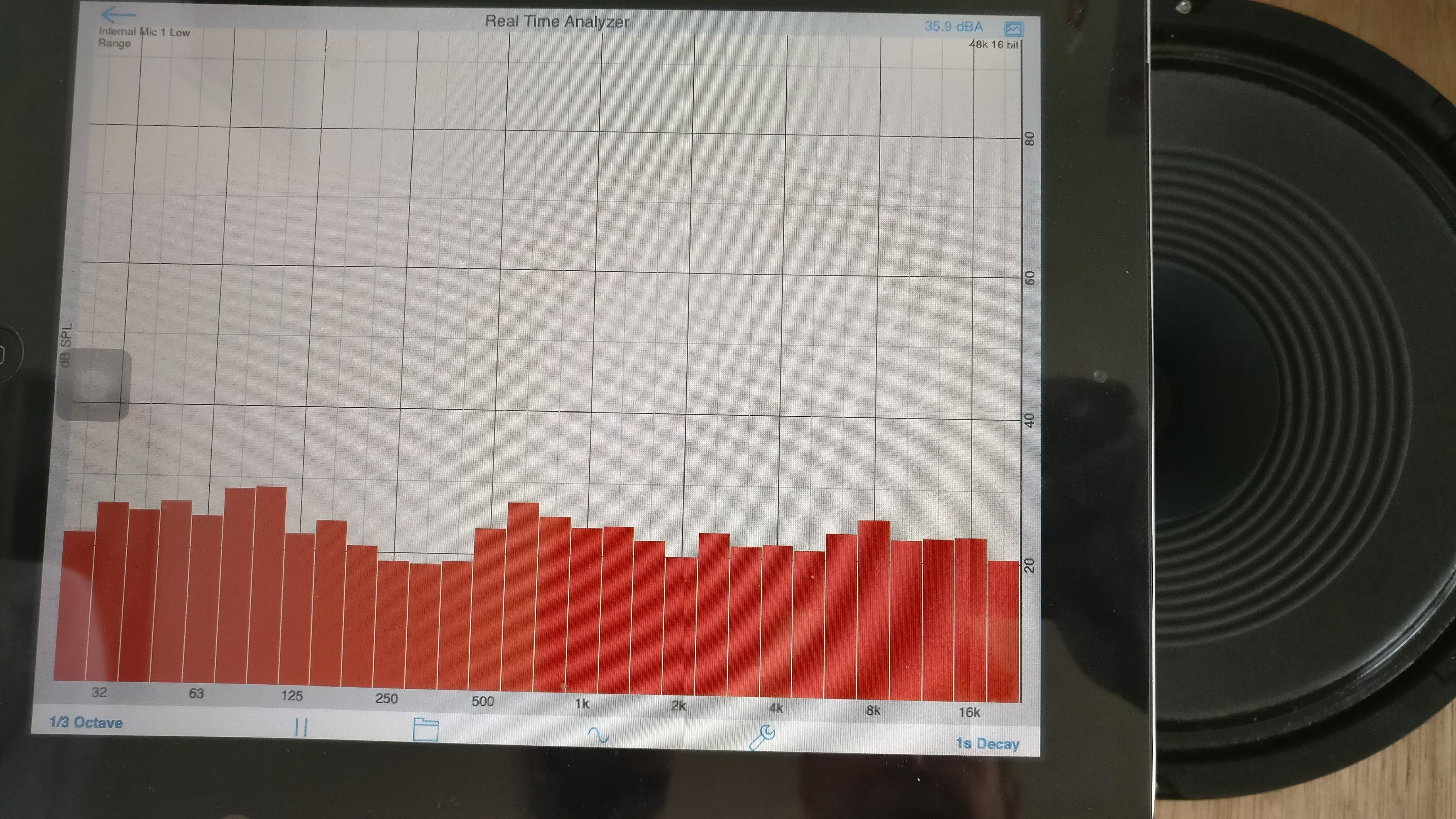

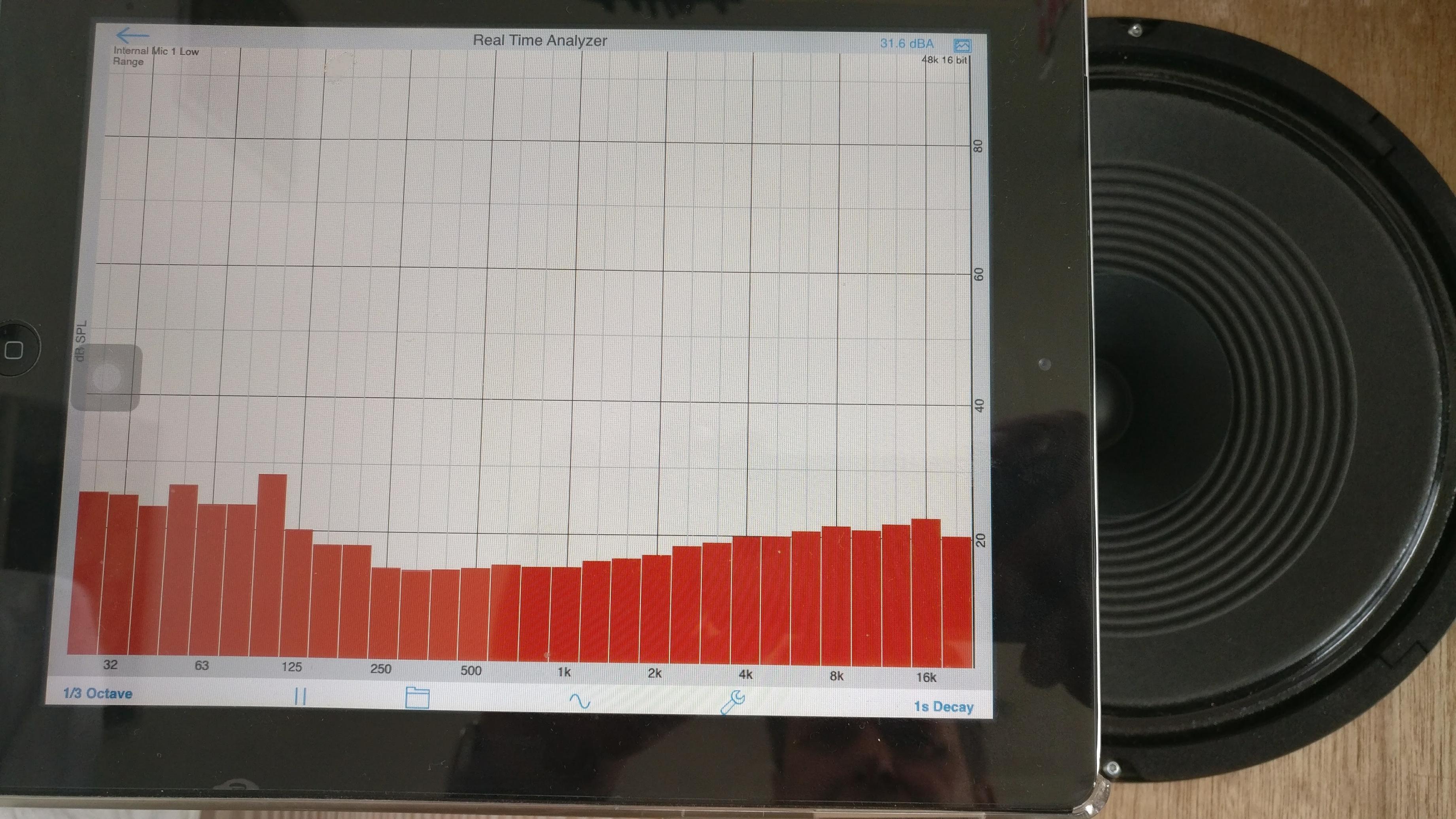

Working as an acoustical test engineer I know that communicating noise levels can be very difficult. But at 30 dB gain the hiss exceeds the noise from my OLD PC. I tried to measuring the noise levels using the very nice AudioToools App on my IPad (wish they would make it for android, but that’s another discussion). The first picture shows the levels when I run the SE output of the DAC board which has NO hiss. The second picture shows the levels of the Balanced Zen with gain set at 10 dB. Notice the difference from about 500 Hz to 2kHz.
Measuring setup: Icepower 1000asp amp (gain around 27 dB I think?). Beyma 10AG/N speaker standing on the floor. (sensitivity 97 dB, I know this is sensitive and I only used it to prove my point for the measurements. I was using an old book shelve speaker to do the initial testing). IPad at about 20 cm from speaker cone.
1st pic: SE output of DAC
2nd pic . BAl Zen at gain 10 dB
3rd pic: Board with 4 x PSU.
Measuring setup is described above 🙂
