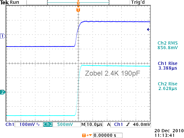

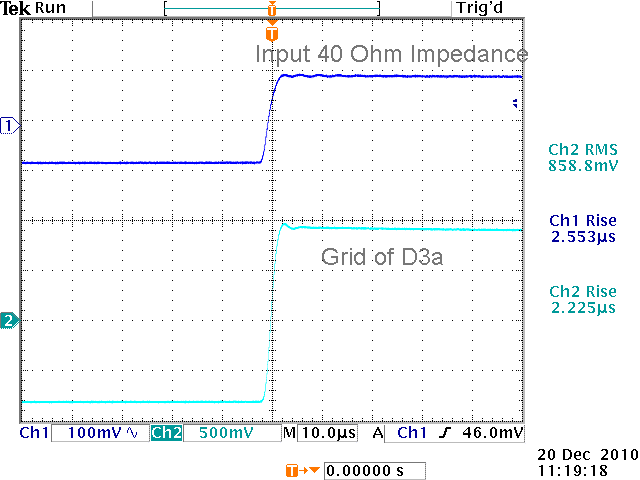

I was reading the Sowter 8055 datasheet -- it's been changed a bit to include some recommendations for a Zobel. The Denon cartridge I use has a 40 ohm impedance, so I added 20 ohms to the output of my generator (it has 20 ohms output impedance). I used a 740pF variable cab and 2.4K resistor (in parallel with the 6.8K) to look at the input at the grid of the D3a. The 190pF +2.4K reduces the bandwidth 0.4dB @22kHz.
here are some more charts -- i took a look at the frequency response with the zobel -- using a 40-740pF variable cap and 2.4k, and 3.18uS compensation:
