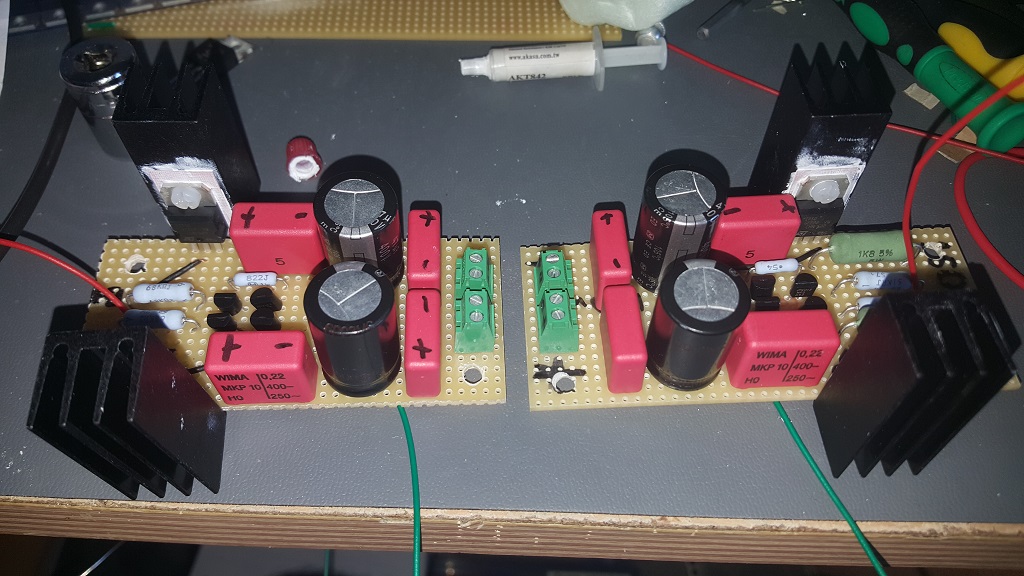

ht regs
Built my HT regs.
Was wondering if there was a way of testing them without resorting to putting the ht supply on them.
Did continuity check to make sure that input to ground isnt shorted and also ht in to reg out.
Hooked up to bench supply. The outputs match each other, eg, 14v in produces 13.42v at the output on the 160v regs and 13.40v on the 260v regs. both sets match each other perfectly.

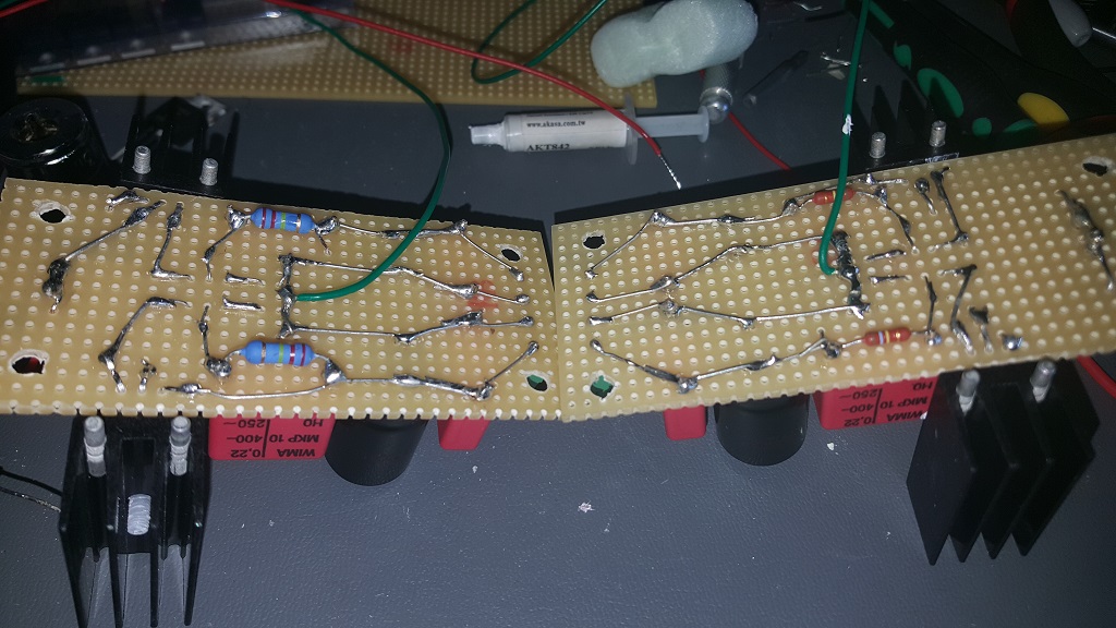

First time using perf board. Slightly time consuming but easier to figure out than strip board. Also suspect better for high voltage.
Is this the right idea?

In case anyone thinks ive gone mad, the films have + - marked on them as i was trying the osciloscope noise test when holding them to try and ascertain which way they're coiled. Probably stacked, but hey ho. The transient when i grabbed them did seem slower one way than the other regardless of how theyre actually made.
That's pretty much what my perf board projects look like. I can see you are a belt and suspenders man. I was told that I don't need heat sink grease if I am using a silicone pad.;-)
I have heard of some guys using a Variac to gently increase the input voltage so that they can check there are no surprises. If that's what you did with your bench supply, then it may be time to cross your fingers and go.
Jac
Jac
Yeah, couldnt get the nylon screws quite as tight as i would ideally like so i thought a scrape of grease would help fill the texture on the pads.
Still a little way off applying the ht. When my cases arrive Ill do that. Just wanted to scope out the situation.
