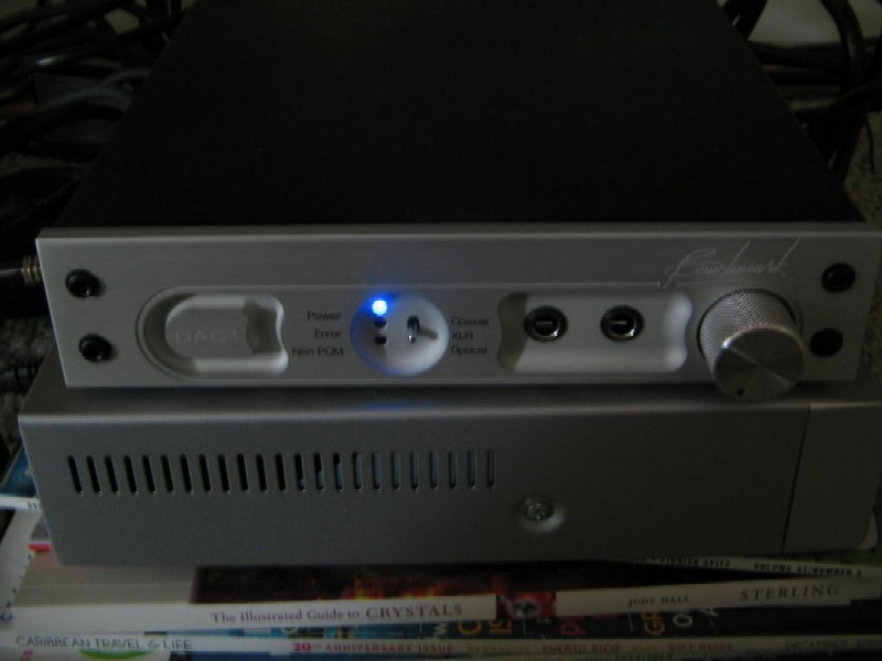

What about jitter correction features built in into popular D/A converters like CS42428?
Somewhere in this thread someone used the term "audible jitter", so if you can hear it, how does it sound? Worse separation? Phase errors? Even when playing normal CDs I can really tell exactly where each instrument stood during recording phase, there's pretty good stage and excellent separation. So - where's the jitter?
qus said:Somewhere in this thread someone used the term "audible jitter", so if you can hear it, how does it sound? Worse separation? Phase errors? Even when playing normal CDs I can really tell exactly where each instrument stood during recording phase, there's pretty good stage and excellent separation. So - where's the jitter?
Hearing the jitter or not depends on your Audio DAC. Using a resampler like DAC1 from Benchmark Media jitter will be completely discarded. This DAC also uses AD1896 like I did for resampling in the kit.
Operating a DAC that generates its masterclock from the input SPDIF signal may lead to audible jitter because the PLL regenerating the clock in general has much lower jitter suppression than the digital PLL inside the AD1896. But this very much depends on the design of the receiving PLL.
Not hearing the jitter of the Pioneer DV-575A did not mean it is not there! It only means that you have a DAC which succeeds in suppressing the jitter before it reaches your ears.
