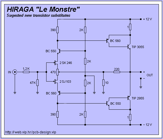

Hello,
I builted several Hiraga Monster amplifier with the transistors
shown below, and did not have any problems.
Do not mix original and suggested new transistors in amplifier.
Use only ALL original or ALL substitute parts, as otherwise the
amplifier might not be stable.
Best regards,
Kristijan Kljucaric

substitutes for Monstre: especially for sk/sj couple
More than 10 years back I built 5 times the original Monstre amplifier. At the time the transistors were obtainable though not easily. After I heard another Monstre a few months ago I decided that I wanted to built me another one from scratch, just for fun. But indeed: the transistors are a problem now. Therefore I just tried several alternatives and found no problems at all (but could hear differences in sound quality and character).
As the previous reply stated: using bc550/560, tip's etc is no problem, you will get a good working amplifier. I also tried bd139/140 and some other sa/sc pair and everything works okay. So I even mixed the original parts and their substitutes without problems.
The only challenge for the forum here is to find (just to have maximum flexibility and fun) European or American substitues for the SK/SJ pair (at this place I used the original sk170/sj74 couple) and I have not a clue what could be used in this place instead (not talking about sj72 and the like of course).
So start building it on a breadbord and for a very modest sum of money you get yourself a special amp and a lot of fun.
