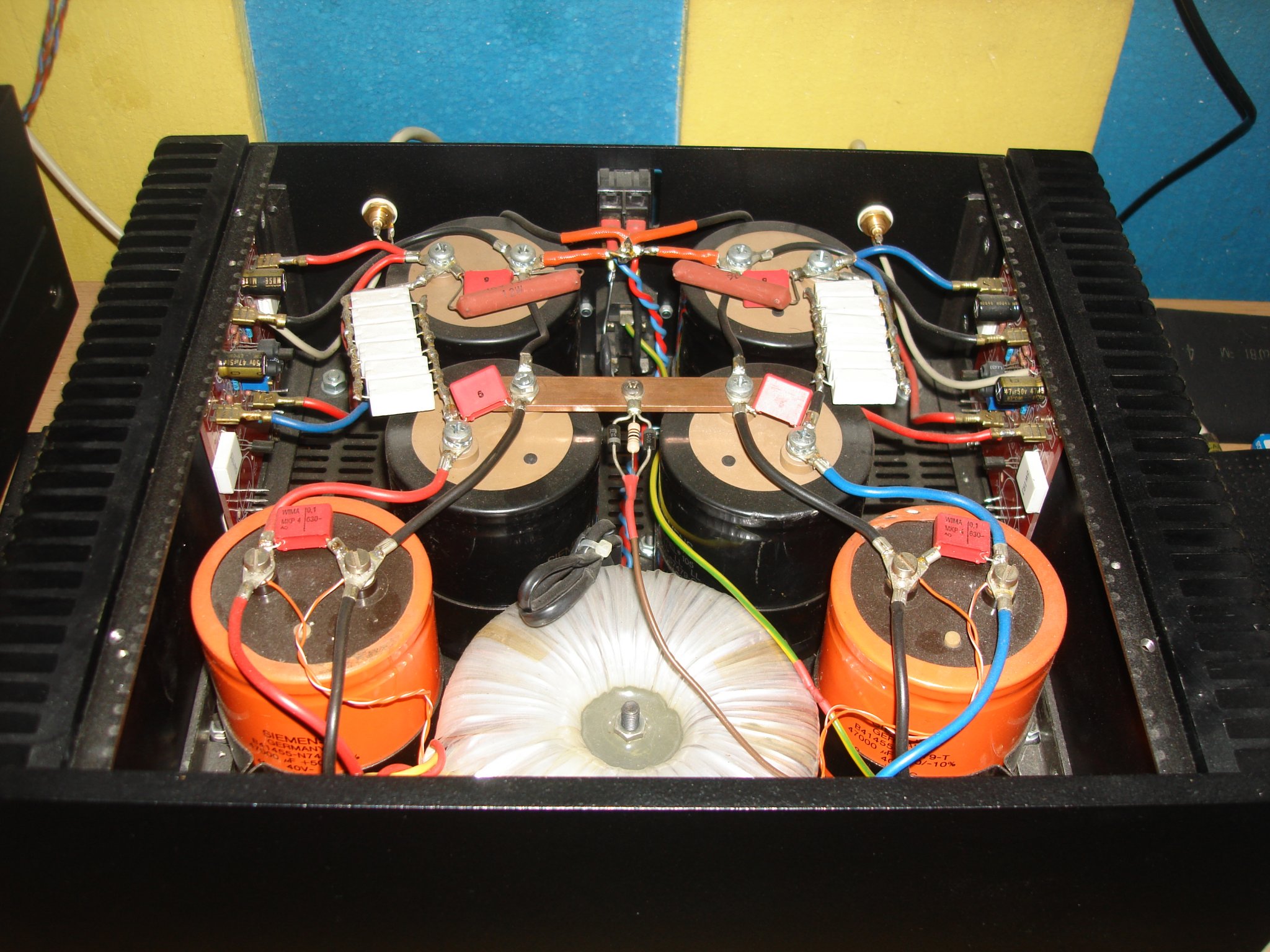

I make Hiraga Le Monstre 2x 8w with oversize capacitors, what you think?

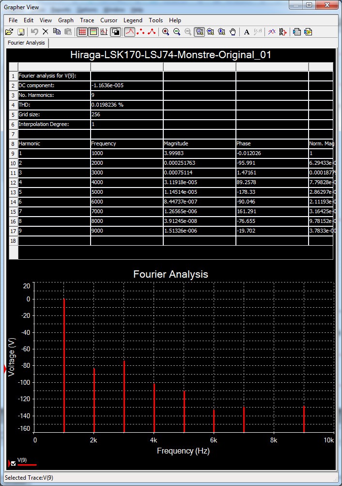

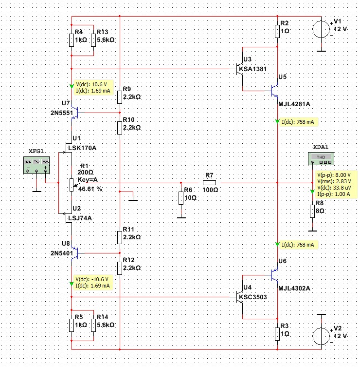

I have done a simulation of Le Monstre.
I had to use 200 Ohm pot instead of original 100 Ohm.
I also had to add R13 and R14 resistors, to get the desired bias in output.
My target was 0.75 Ampere bias. Gives max 1.5A x 8 Ohm = 12 Vpeak.

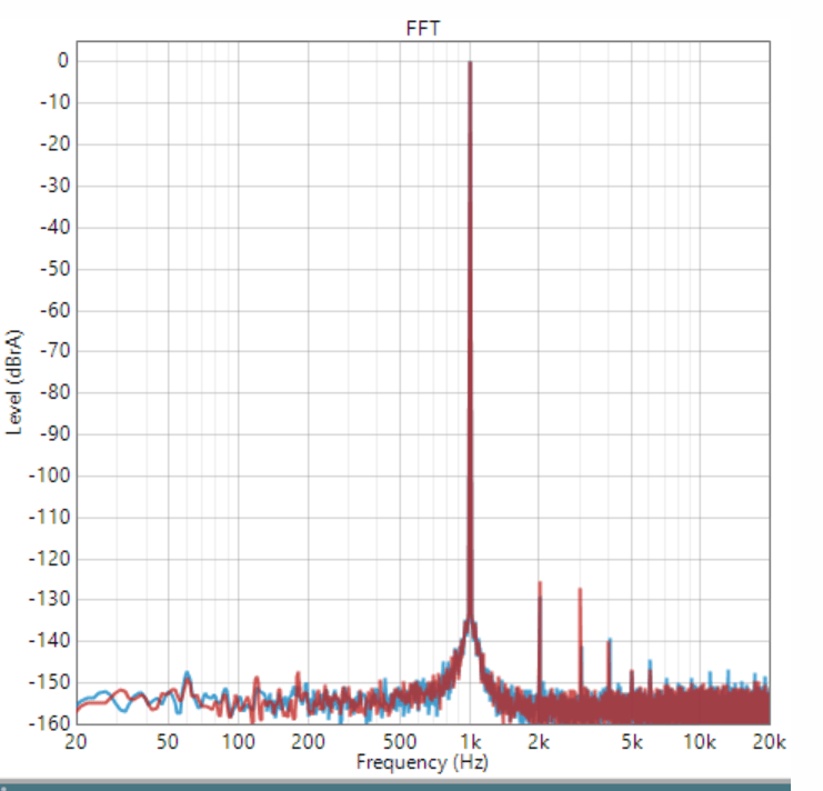

More distortion and higher orders than I expected.
Has anyone listened to Topping LA90 that measures like this? And this is at approx 50W. I´m at the stage to order one just to find out... In any case a remarkable piece of angineering, and this is AB. Truly just amazing...
