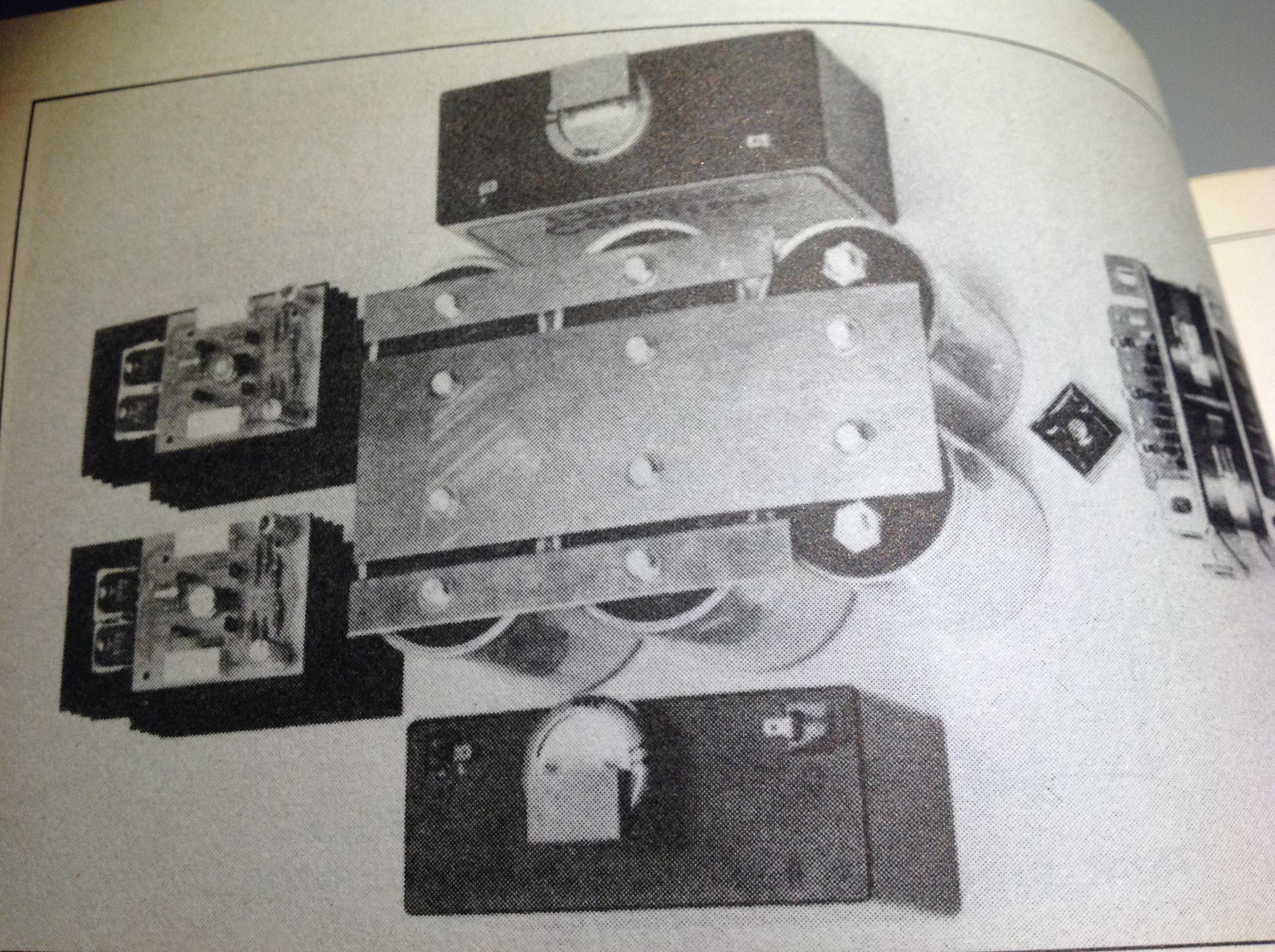

Batteries were specified by Hiraga to power at least one of his Class A amplifiers but maintaining deep-cycle batteries in a home is not only very expensive but also awkward, unrewarding and potentially dangerous. The partner acceptance factor is in the negative zone. I suggest a ventilated location outdoors or tap into an an existing solar power battery bank. Some folk believe that batteries ensure the ultimate in pure sound quality but I think it's more about simple, elemental principles and practice which make the "works" easy to appreciate.
The justification for battery supplies is that they avoid power supply noise which is considerable with simple class A designs lacking any PSRR, like le Monstre. If you want to experiment, it would be more practical to use a high current regulated power supply, such as specified for the a JLH class A amplifier, but likely beefed up for the higher current needed to power the chronically inefficient (meaning mighty hot) Hiraga and Pass designs.
This design is for dual, adjustable rails but using only the upper half of the circuit gives you a single, positive adjustable supply which all that's required for many simple designs. The Class-A Amplifier Site - Current Boosted Regulator
There are possibilities for using capacitance multipliers as filters instead of regulation and recent threads discuss this.
