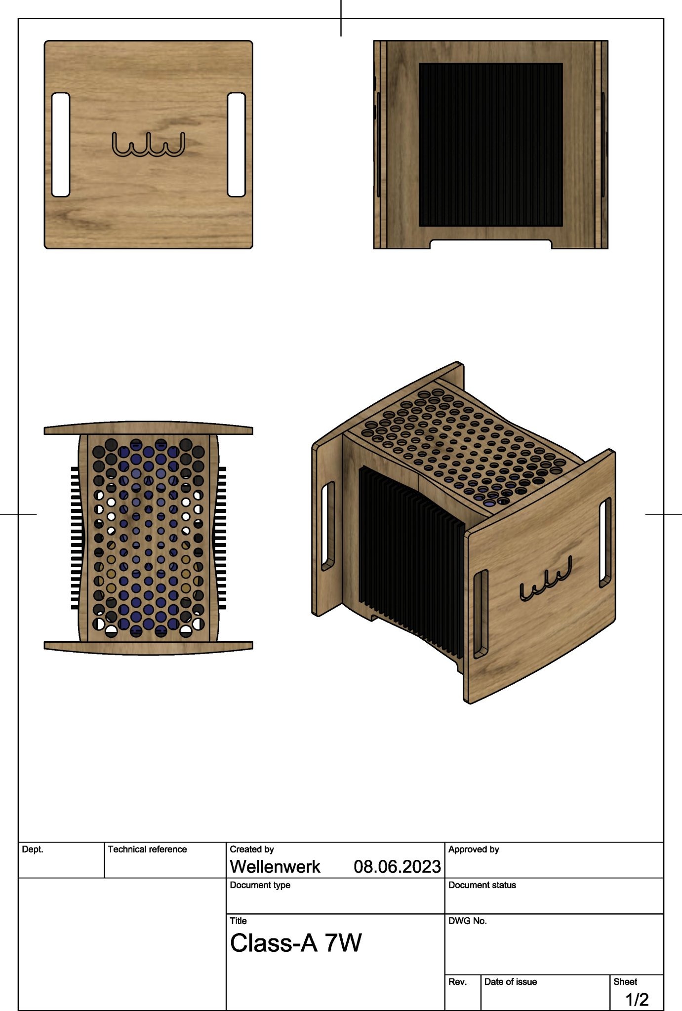

PS: This will be the new enclosure for the 7W Version. The amp i have built years ago but with limited resources and now i want to set it up nicely 🙂

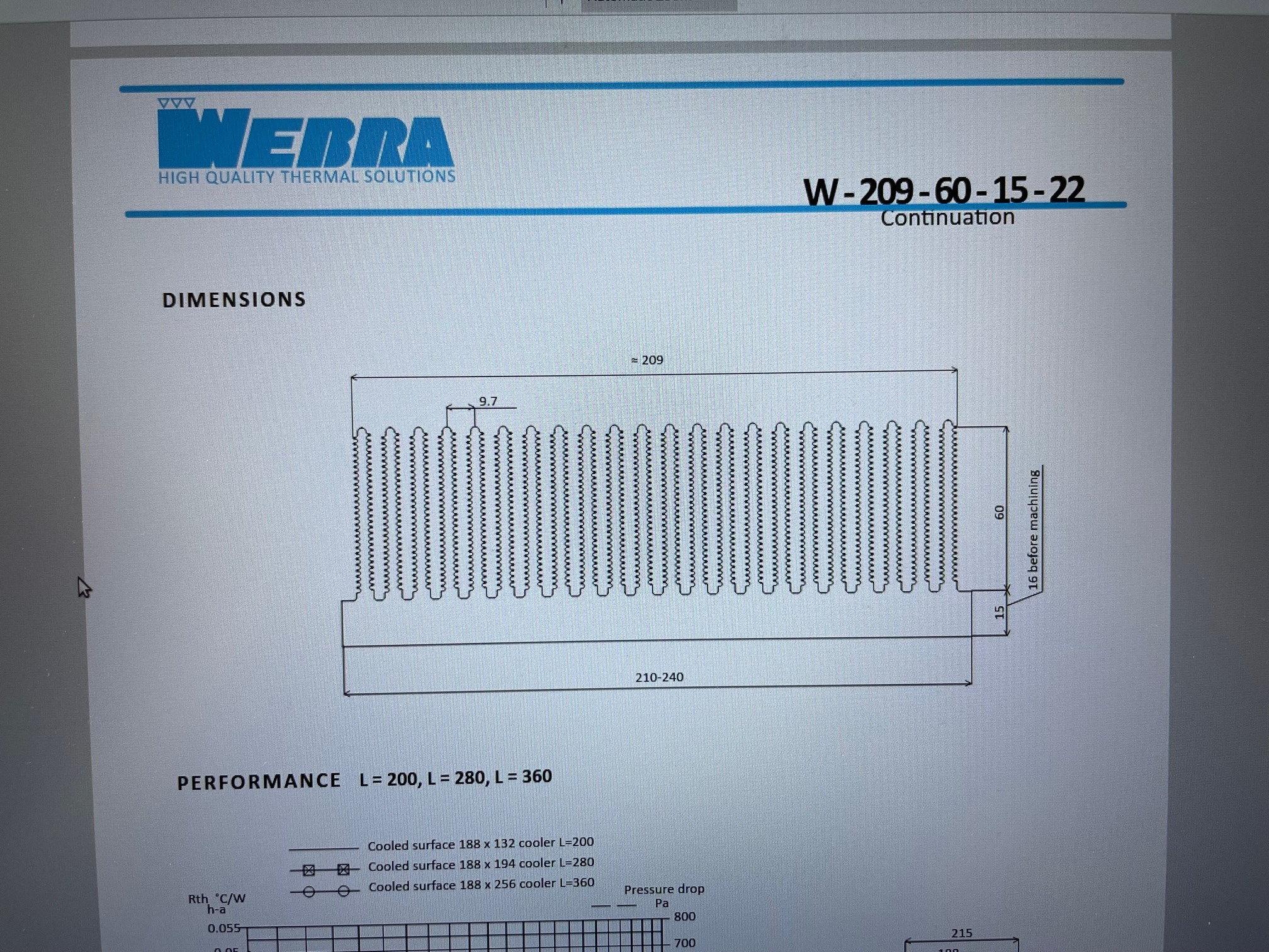

TobiK: I have heatsink from Webra in Sweden. W-209mm + H-75mm and L-200mm. C/W = 0.033.
Im not sure by the bias thing, measure 401mV over 0.33 so 1.2A. Still running cool, 20 degree down from oem 30W ( bias at around 1.4A ).
