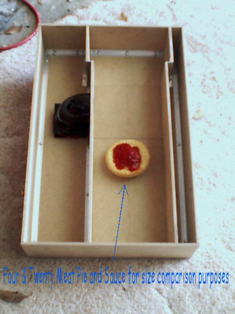

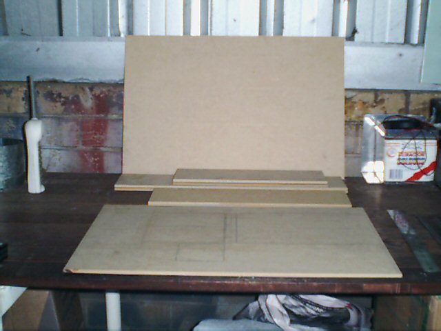

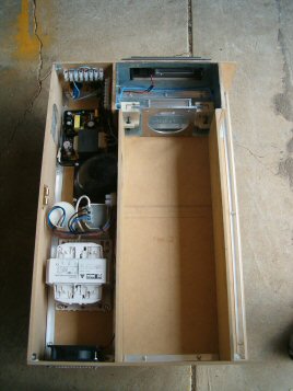

Heres where it all began...the mdf im using for the construction of the box cut to size by my local cabnet maker on his table saw
I have used 90 degree 10mm dia aluminium for all the corner joints, this helps keep the whole job square and strong, i have mitre cut all corners (bloody time consuming this is to say the least grrr) but it gives a proffesional finished look i guess 🙂
This picture shows the general layout i have come up with, I had originally planned on using a front surface mirror but opted not to get the mirror when i ordered the other optics from Ace in favour of getting one locally, since then i have discovered fs mirrors aren't available in Australia :-( so due to time constraints with delivery etc as Ace is in Spain i have opted to go ahead with the projector in a straight through configuration not before i might ad i had partially constructed a setup based on Ace's projector, will keep that in the cupboard along with the light box i constructed for it for future use on a mates projector and get a fs mirror down the track from "The Guru" hehe 😛

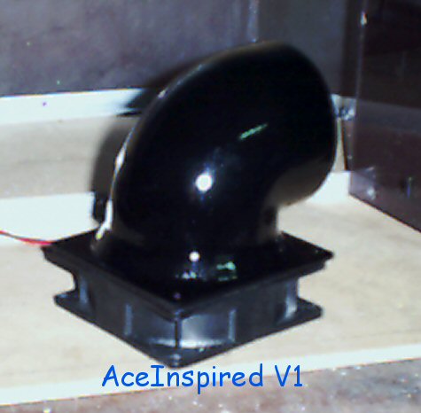

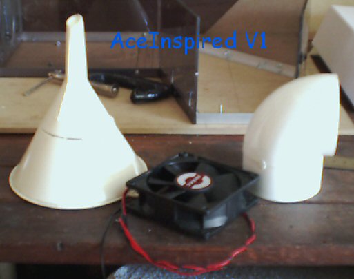

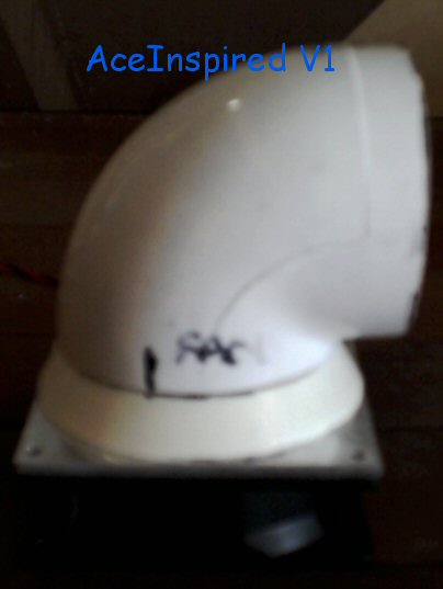

For cooling the LCD and supplying some cool air to the lamp i am using a 80mm antec fan, I fabricated a duct from the following 2mm ali with 80mm hole cut in it, a plastic funnel and a 60mm 90degree pvc elbow

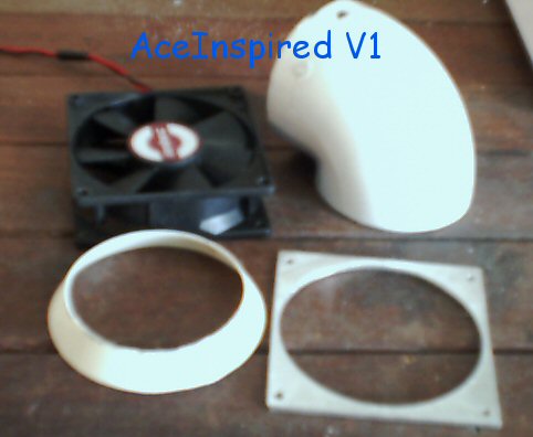

This is how i put it together and a few pics of the end result
And the final product with a couple coats of black epoxy paint 🙂 Some might ask why i didnt use a 80mm elbow to start with to do away with messing around with the "flange" arrangement, simple answer to that ... my local hardware didn't have any 80mm elbows so I had to improvise 😛 lol

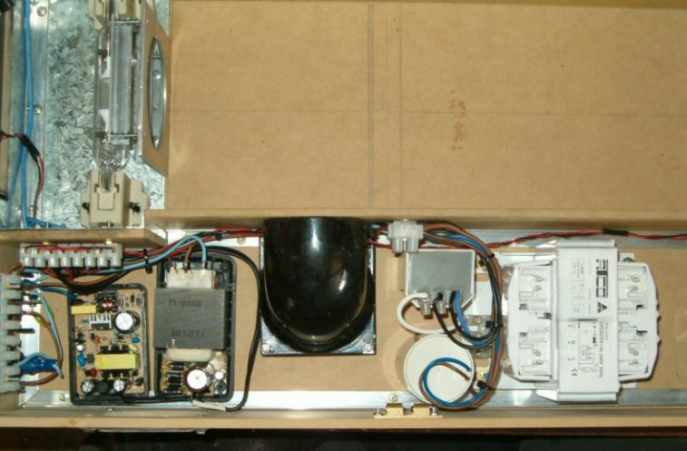

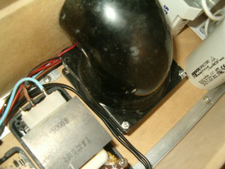

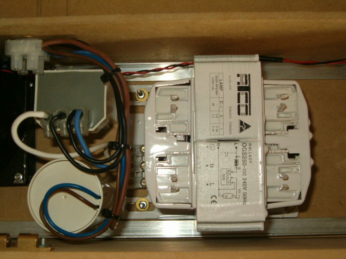

I have cut a 60mm hole 10mm before the LCD to vent air into the lcd chamber...i have also fitted a "V" shaped piece of metal in the opening of the 90degree elbow to direct airflow towards the LCD and towards the llamp...I forgot to take a picture of this however and I dont have my mates camera anymore. I have mounted the fan inbetween the AC adapter for the fans and the ignitor and capacitor...it looks a little like this...

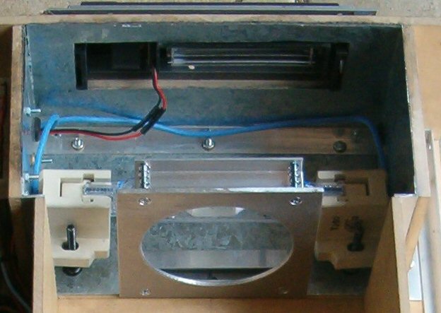

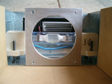

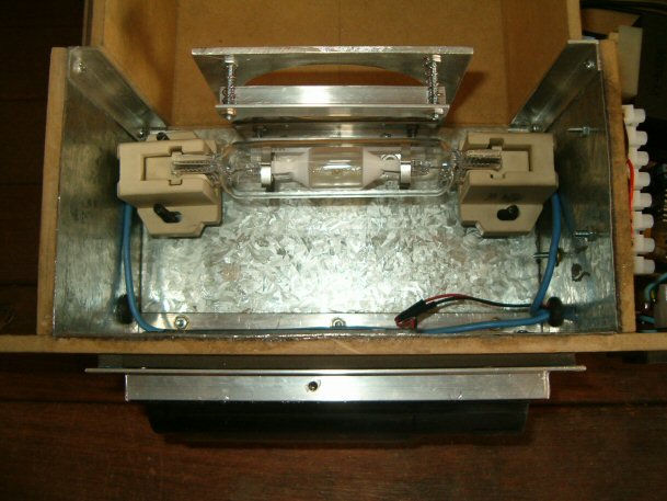

Here's a front top shot ... good shot of the fan and the holder i have fabricated out of 3mm aluminium to house/hold the 80mm condenser when it arrives. I have used 4 springs to provide tension to keep the condenser in place and allow for a 'lil' movement when she heats up...hopefully lol 🙂
Nothing has been fully tightned as yet, due to the fact i will be pulling it all apart in the next day or so to paint the inside of the box...the light box area will be hit with 750degree flat black stove paint ...the rest gets the treatment from black flat black epoxy.

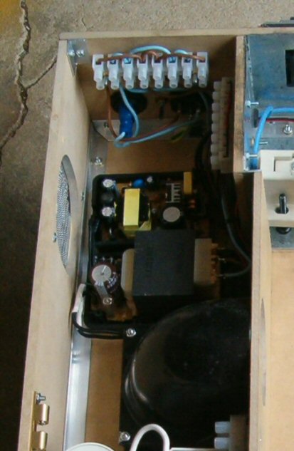

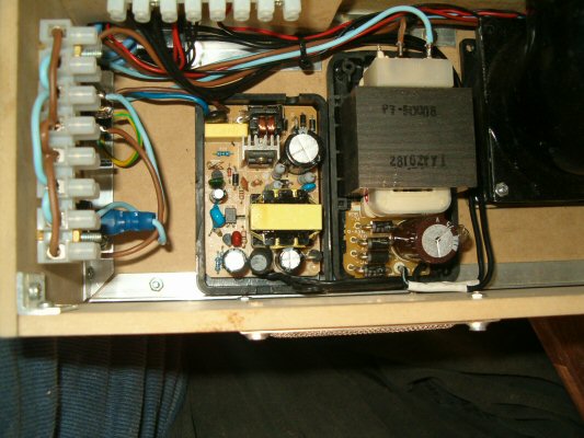

Here's a copule pics of the wiring side of things...AC adapters
Looking from the front...you can see vent to left and if you look closely also a brass latch i have picked up to secure the top of the box internally...the opposite side is hinged...pics comming lol I have another 80mm fan at the front of the electic compartment to vent cool air over the ballast and AC adapters

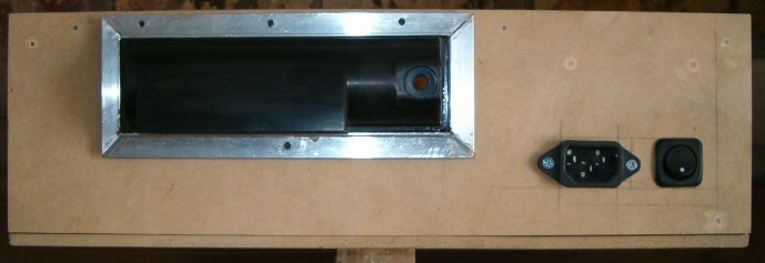

Anyways..to the outside of the box, starting from the rear
The mounting of the rear cylinder fan is at this point in time still a work in progress will knock that over today hole, filing and sanding on the cards for this still, I have fabricated the metal surround and epoxied it to the plastic fan casing, this inturn will be mounted in the position it is now with rubber double side adhesive tape type material, im not familar with the proper name of this stuff, i picked up a roll of it from local hardware for 5 bucks , its 10mm wide and 5mm thick resembles mouse pad material this will help prevent vibration and thus un-wanted noise. The fan itsself is 100cfm model as previously mentioned but makes only 23db...extremely quiet and rapt in its performance. ,
The computer power supply fitting can be seen in the pic along with the switch to power up the Lamp,fans and LCD

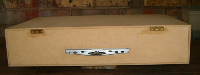

left side of the box is where i have mounted the Lilliput control panel section...I cut and dremelled it to the size i wanted...i then cut a hole in the mdf to mount it in...My attempt is to make this flush with the side of the box...much filing and sanding to get it fitting to my liking lol...
The hinges will not be visible (apart from the cylinder part of hinge) once the box is painted i have also recessed these into the mdf and they will be painted over...top is latched with brass latch seen in previious pics in this thread.
