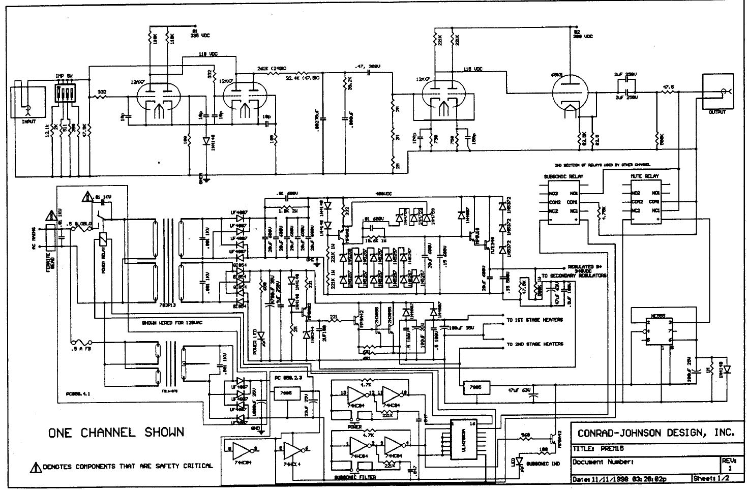

Hope someone can assist debugging this problem. I am getting very low frequency noise (pumping) on my conrad johnson Premier 15 tube phono preamp. The noise frequency is below 1Hz. My Fluke DMM sees it as DC as the frequency is too low for it to measure this as AC. Switching on the subsonic gets rid of the noise at the outputs and the preamp is completely silent however this leads me to believe there is some problem with the preamp. Without the subsonic filter the pumping can get as high as +/-1.5v which given the high gain of the preamp makes sense. I have tried replacing tubes, playing with grounding to no real effect.
Any ideas?

With a classical unregulated, filtered supply you can get subsonics due to mains voltage variations. 1.5 V is a lot, though.
The supply in the Premier 15 is regulated and I get these subsonic noise with no input connected on a test bench. Even if I short the inputs I am still having this problem. The input is MC through a transformer.

Can you measure the spectrum somehow? If you can determine a corner frequency and have the schematic, maybe you'll find a matching RC product somewhere.
For example, if the reference of the voltage regulator is filtered with a 160 ms time constant and that 1 Hz you mentioned is a corner frequency in the output noise spectrum, that would be a clue that it might be the reference.

Usually this means the coupling capacitor after the first stage is too large,
unless there's a bad (or too small) decoupling capacitor in the power supply.

The power supply is regulated and well filtered but you gave me an idea with the interstage coupling cap. The original cj design uses 0.47uf. I have a similar 0.15uf cap that I can try.

Regulators can oscillate at LF, since they are feedback amplifiers.
For some reason I find this interesting. Dunno. So far, most of the advice (which clearly isn't bad advice!) is to change out components along the audio chain that allow infrasonic signal to pass relatively uninhibited. Rayma asserts that the 150 nF cap may well help in replacing the 470 nF. It raises the pole¹ by 3× in the frequency domain.
It might be nice to see an actual circuit diagram if you can lay hands on it.

Thank you everyone for your help. Rayma's post gave me an idea to check the regulators. God knows why I did not do this earlier. conrad johnson uses a two stage descrete regulation scheme and the transistors at the output of the first regulation stage were fried which caused the output of the first regulation stage to be at 230v vs. 360v. As a result the second regulation stages which should output 300v and 330v respectively could not regulate the voltage and were inducing noise into the system.
I should make a mental note to always check the supply voltages first. I guess I saw 230v and did not realize it not the spec'd output voltage.
That's great, can you post the complete schematic?

Here is the schematic. Still working on resolving this. Ordered the transistors in the regulator. Hope once they are replaced the problem will be solved.
