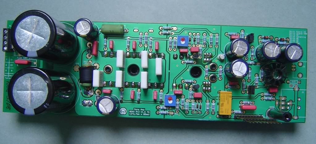

Highly recommended German Amplifier Schematic !
MB* 7008 amplifier module !
I received from Mr.David Louis (Audiogon)
High voltage Opamp and Darlington Transistor Output.

This schematic reminds me of a Berendsen mono amp that I had for service ones.
The Berendsen was balanced out but the schematic of one half of it looks very much like this schematic.
Do you have more information about this amp?

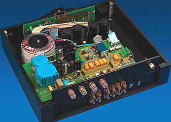

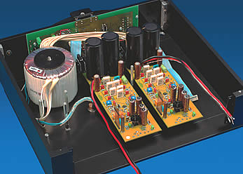

Information
This new masterpiece from MB* fulfils the wishes of all the music lovers who want a com-pact and elegant audio reproduction system without any compromise in sound quality.
The power section of the mb* 7008 is designed with a double-mono construction, using 2 separate power boards. For optimal operation, the heatsink is on the top - this design creates the shortest signal path and the most homogenous temperature field for lowest thermal distortion. You will be surprised by the control of the power amplifier stage and you will feel that you have virtually limitless amounts of power available. The second surprise will be the total lack of coloration of the unit - what's left is only the beauty of the music. This is one of the rare amplifier designs where a solid-state amplifier is able to reproduce extremely difficult instruments with pure fidelity, without introducing distortion.
120W Rated Power :
Output Voltage max 35 V peak
Output current max : 20 A peak
Input Impedance :
10 kW, RCA
10 kW, XLR
Input Sensitivity : 1,5V, 185 W, 4W
S/N ratio unweighted : 111 dB
S/N ratio A-weighted : 115 dB
Frequency Response :
Mono/Stereo DC - 130 kHz
Distortion : <0.006%, 4 W, 1 kHz, 50 W
Damping Factor : 300 (4W)
Power Consumption :
4 VA sleep mode
47 VA (Idle Mode)
450 VA (max.)

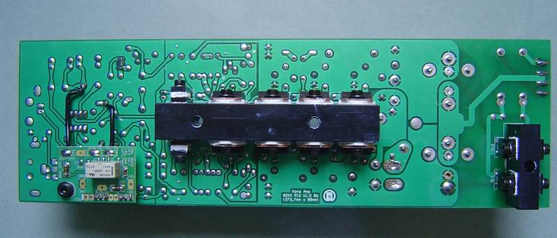

This is not a bad design. There is a lot going on that is worth a closer look: the opamp rails referenced to the output for example. That explains the choice of opamp and gives it a different twist.

It use old dirt cheap darlingtons BDV64/65.
A minimum would be to use superior Sanken devices, but i suppose
that the profit return ratio was the most studied equation when
designing this amp....

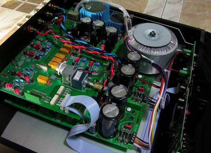

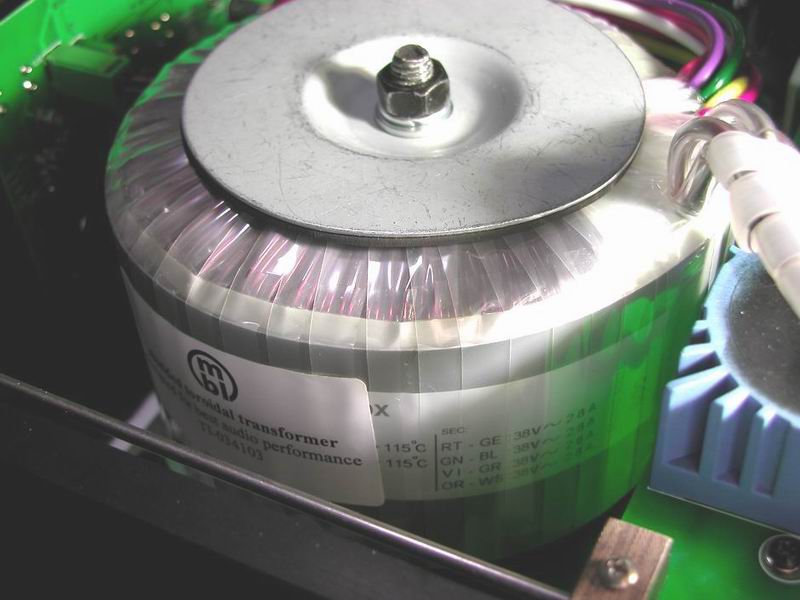

Very cheap !
If you did pay 5K$ for it, it would be a good bargain to not
see it coming:D back....

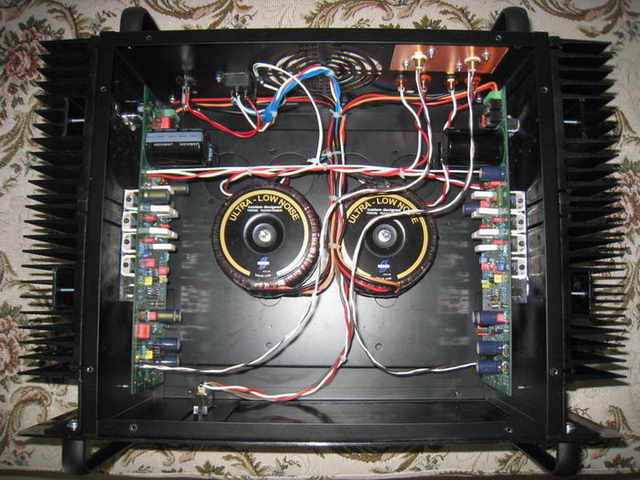

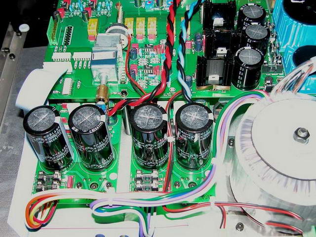

No, No, I paid only 600USD for 2 channel.
I bought only Power module, not fully product !
I put them in my chassis and I bought 2 transformers from my local shop.
Anadigit
