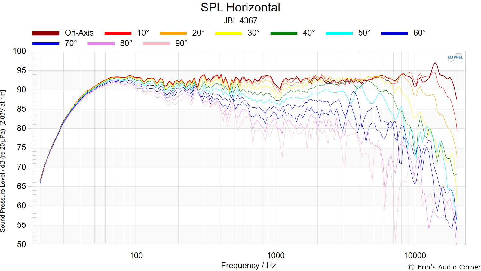

Erin speculated that the excellent sound of the 4367 may be due to the fact that the treble narrows at high frequency.
I've never heard the M2, so I can't speak to that. But I know the M2 and the 4367 both use the same compression driver... so both should narrow at high frequency.

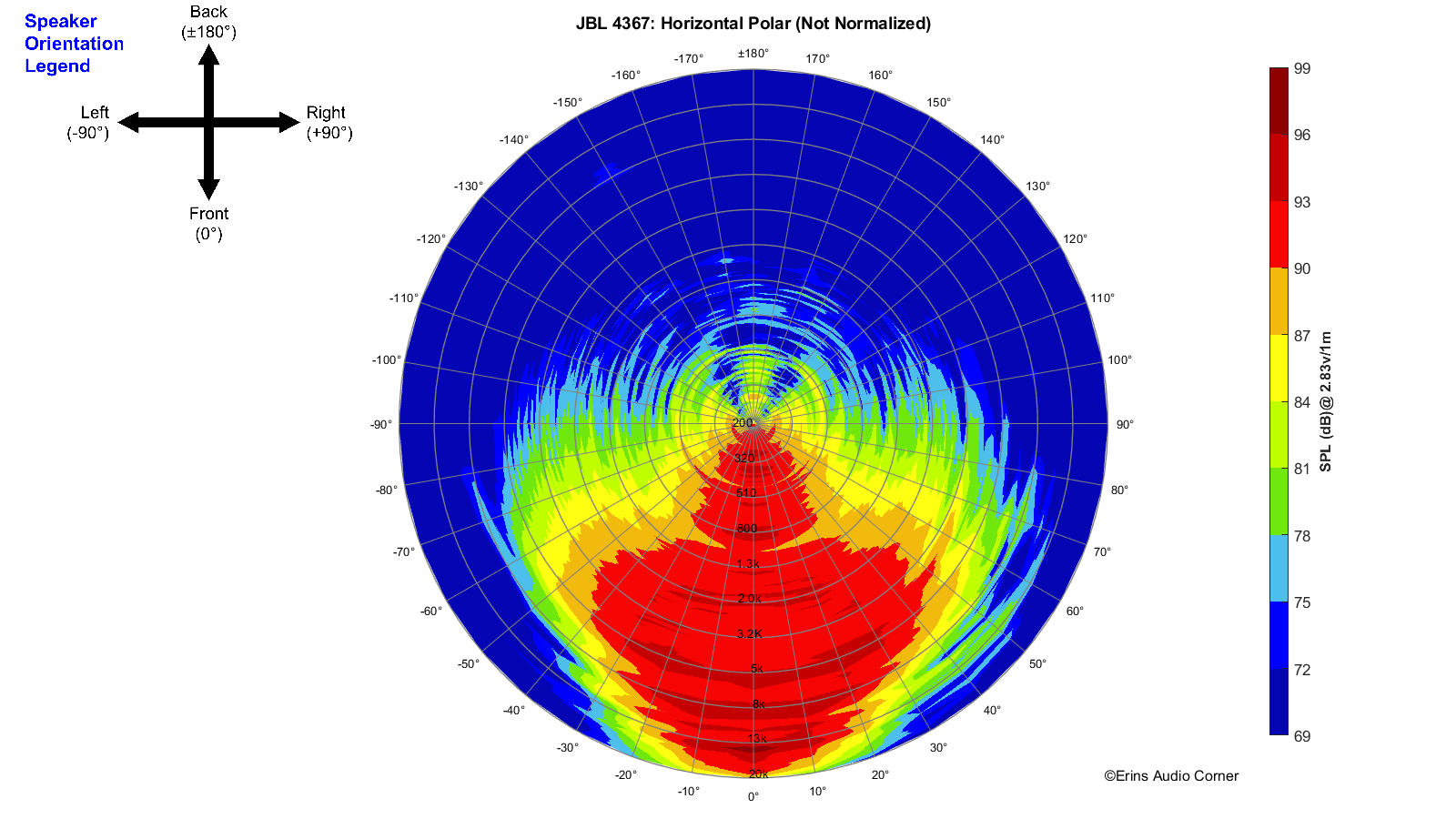

Attached are Erin's nifty "globe plots" of the JBL M2 and the JBL 4367, on the horizontal axis.
I've also included the Danley SH50; I'll explain why in a sec.
JBL M2 horizontal "globe plot"
JBL 4367 horizontal "globe plot"
Danley SH50 horizontal "globe plot"

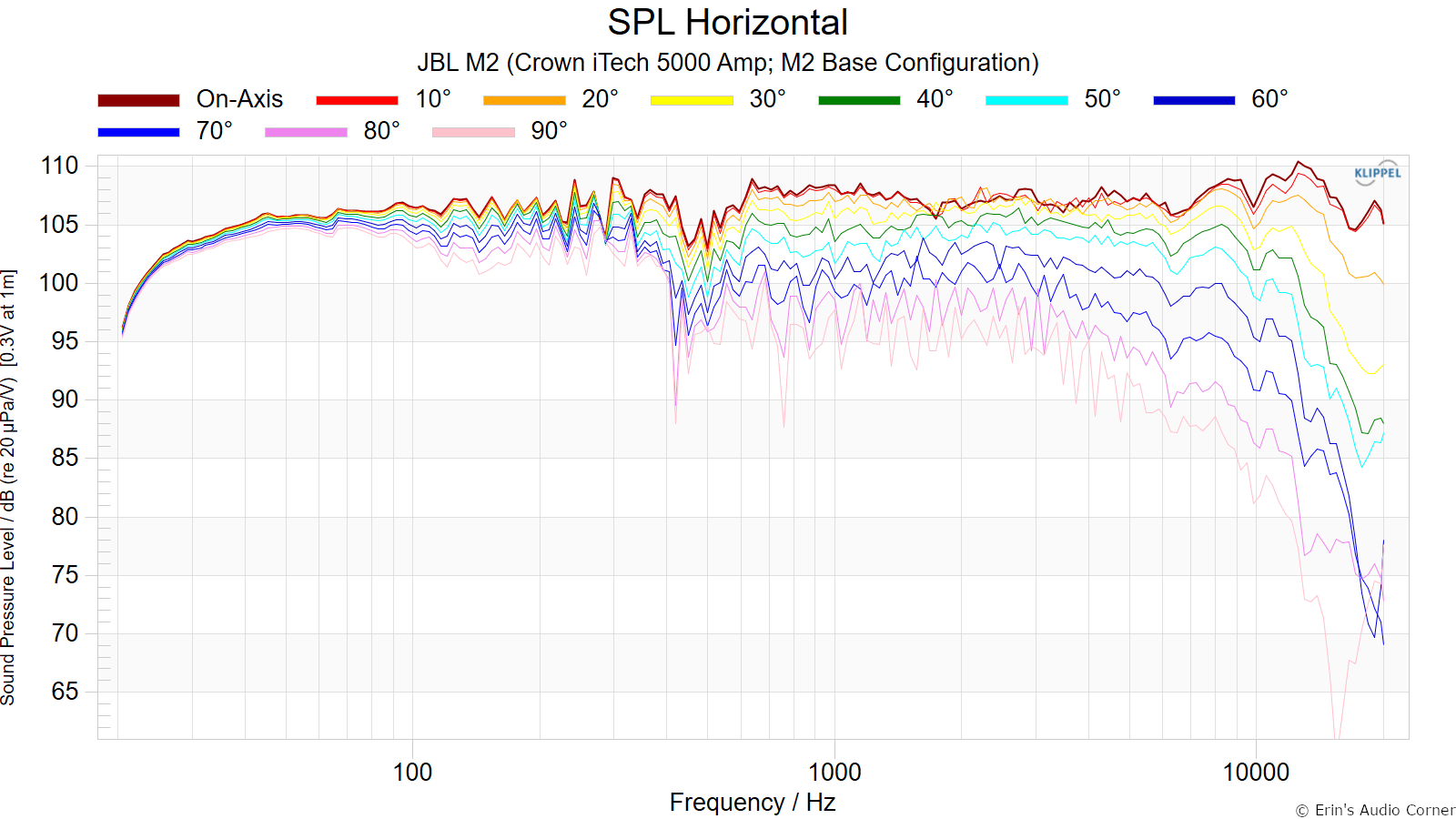

On the horizontal axis, you can definitely see that the beamwidth of the M2 is indeed wider above 10khz.
So it uses the same compression driver, but manages to achieve wider beamwidth, even with a 1.4" throat. (9643Hz is 1.4" wide.)
Geddes has hinted that there's ways of widening the beamwidth of a waveguide, even the frequencies that are shorter than the throat of the compression driver. So there's some magic going on here. A few hours of crunching numbers in ATH might answer this. I wonder if the weird 'knuckles' on the M2 contribute?

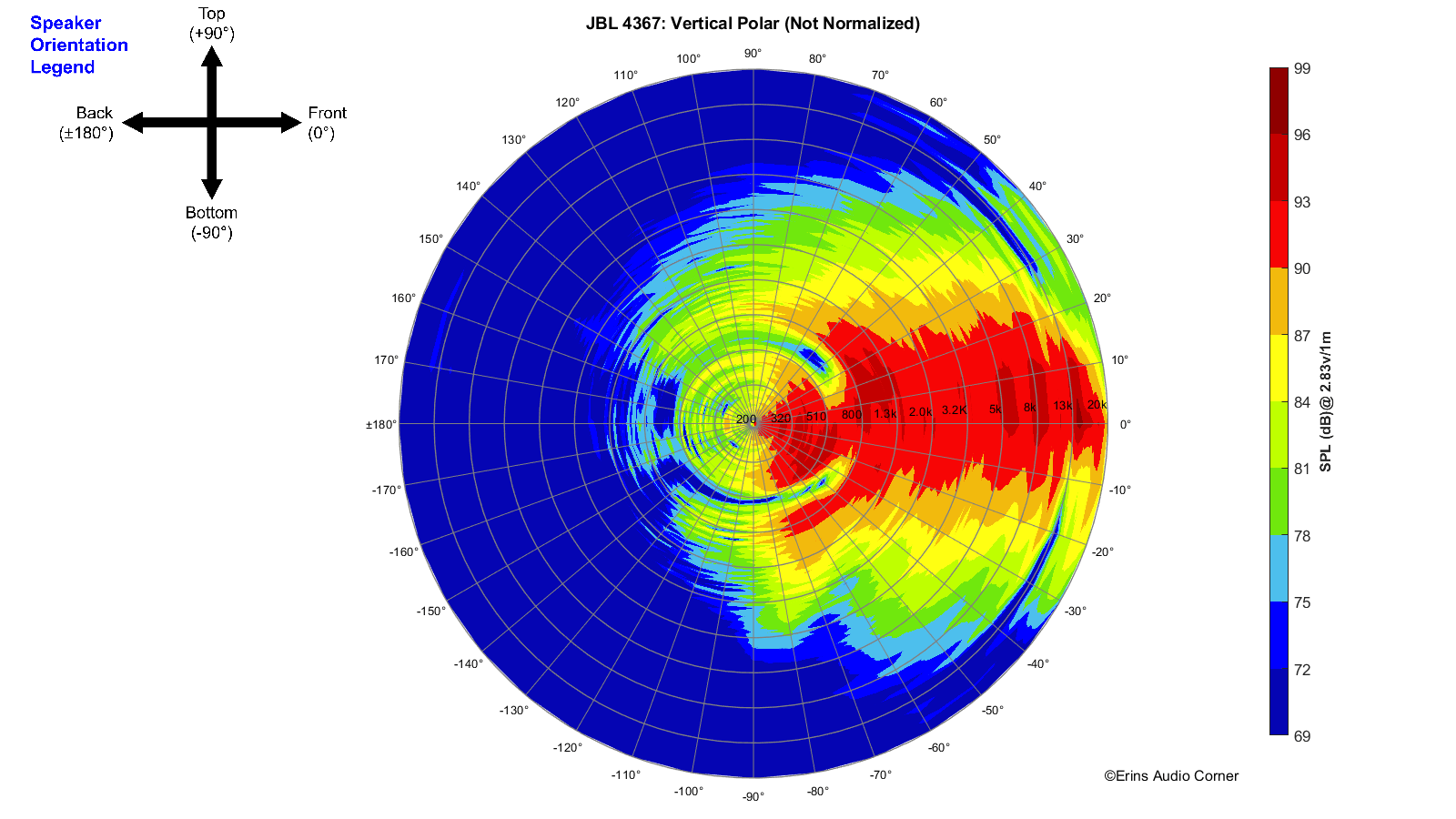

I can only speculate on why Erin liked the sound of the 4367 so much. When I heard it, I liked it a lot. Possibly in my top five or top ten of speakers.
My hunch is that vertical directivity might be the key here.
Whoever made the 4367 is a bit of a wizard, because they did a really great job of narrowing the vertical directivity across nearly the entire bandwidth of the speaker.
Obviously, we can do that with a waveguide. And JBL did. But pushing the beamwidth control all the way down to about 300Hz is impressive, when you consider that the 4367 waveguide is about ten inches tall, and it's beamwidth control should be collapsing around 1350Hz. Based on a lot of the stuff I've done experimentally, using Vituixcad in particular, I'll bet JBL juggled the following:
Vertical spacing of the woofer and tweeter, crossover slope of the drivers, depth of the waveguide, cabinet dimensions, etc.
In particular, the cabinet is 36" tall. 375Hz is 36" long. So I think a lot of the "magic" here is that the use of fairly large spacing, and a really huge midrange, allows them to control the directivity to a lower frequency. In some respects the JBL 708P is like a 1/16th scale version of the 4367. But due to it's much much smaller size, it's vertical beamwidth is wider, and the 708P loses pattern control more than an octave higher in frequency.
YMMV, but something that I noticed with the Gedlee Summas and with the Danley SH50 is that getting directivity control below 1khz goes a looooong way towards "getting the room out of the picture."
From a subjective perspective, it's a catch 22 in a lot of ways. If you have a speaker with narrow directivity, it has really pinpoint imaging. And if you can get that beamwidth control down to 500Hz or 700Hz, it's an unmistakable improvement over small speakers. (And the extra dynamics are a bonus.) But I find that it's ALSO nice to have some high frequency reflections off of the sidewalls, to add some "air" to the presentation. Perhaps this is why two way speakers with 7" woofers and 1" tweeters are such a staple; the beamwidth narrows in the upper midrange, reducing harmful reflections off the sidewalls, but the beamwidth is very wide above the xover point, because the wavelengths are larger than the tweeter.

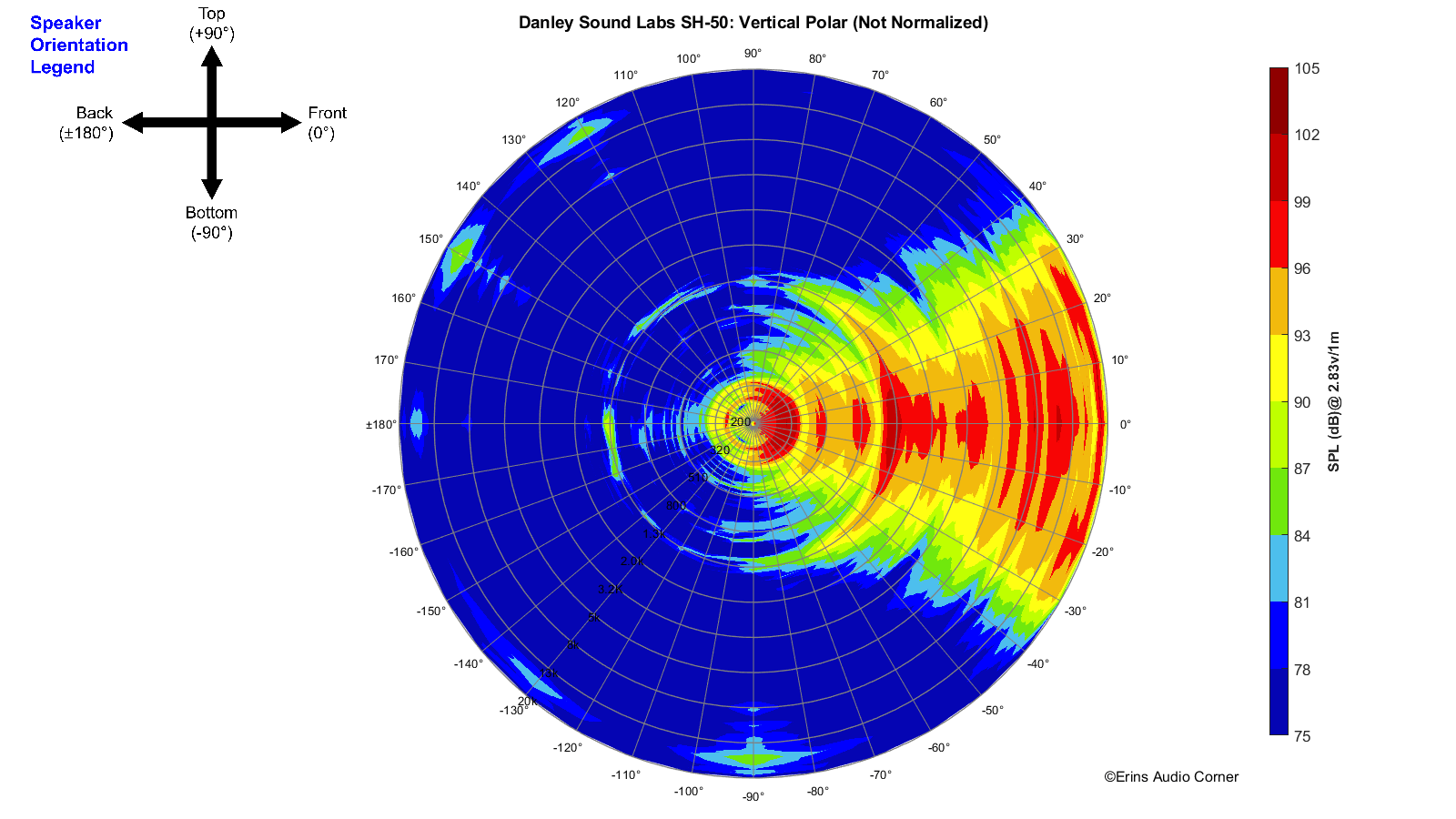

Here's the data, courtesy of erinsaudiocorner:

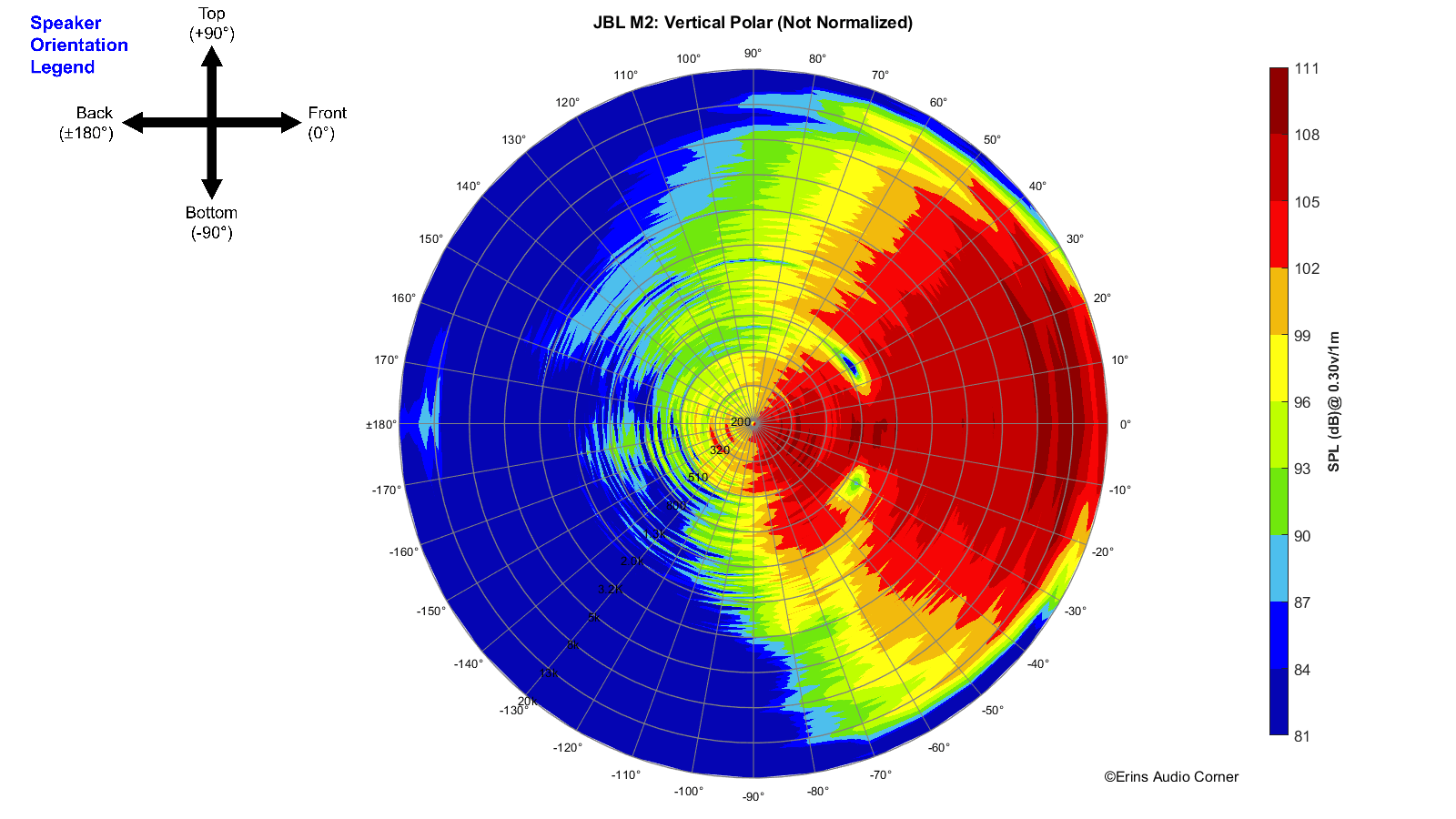

This is the vertical "globe map" of the JBL 4367. Note how the beamwidth is narrow, and maintains that pattern down low.
Danley SH50 is even narrower, and it's pattern is symmetrical on horizontal and vertical. (All the other speakers in this discussion are narrow vertically and wide horizontally, except for the JBL M2 which is wide on BOTH axes.)
Here's the JBL M2. Note that even though it's compression driver is identical, it's vertical beamwidth is significantly wider.
JBL 708P falls between the M2 and the 4367. But it throws a lot of radiation at the floor and ceiling in the range of 280Hz - 1khz because the woofer, cabinet and waveguide are smaller. Even with identical drivers, I think you may be able to improve on the 708P by using a larger cabinet and tweaking the spacing and crossover.

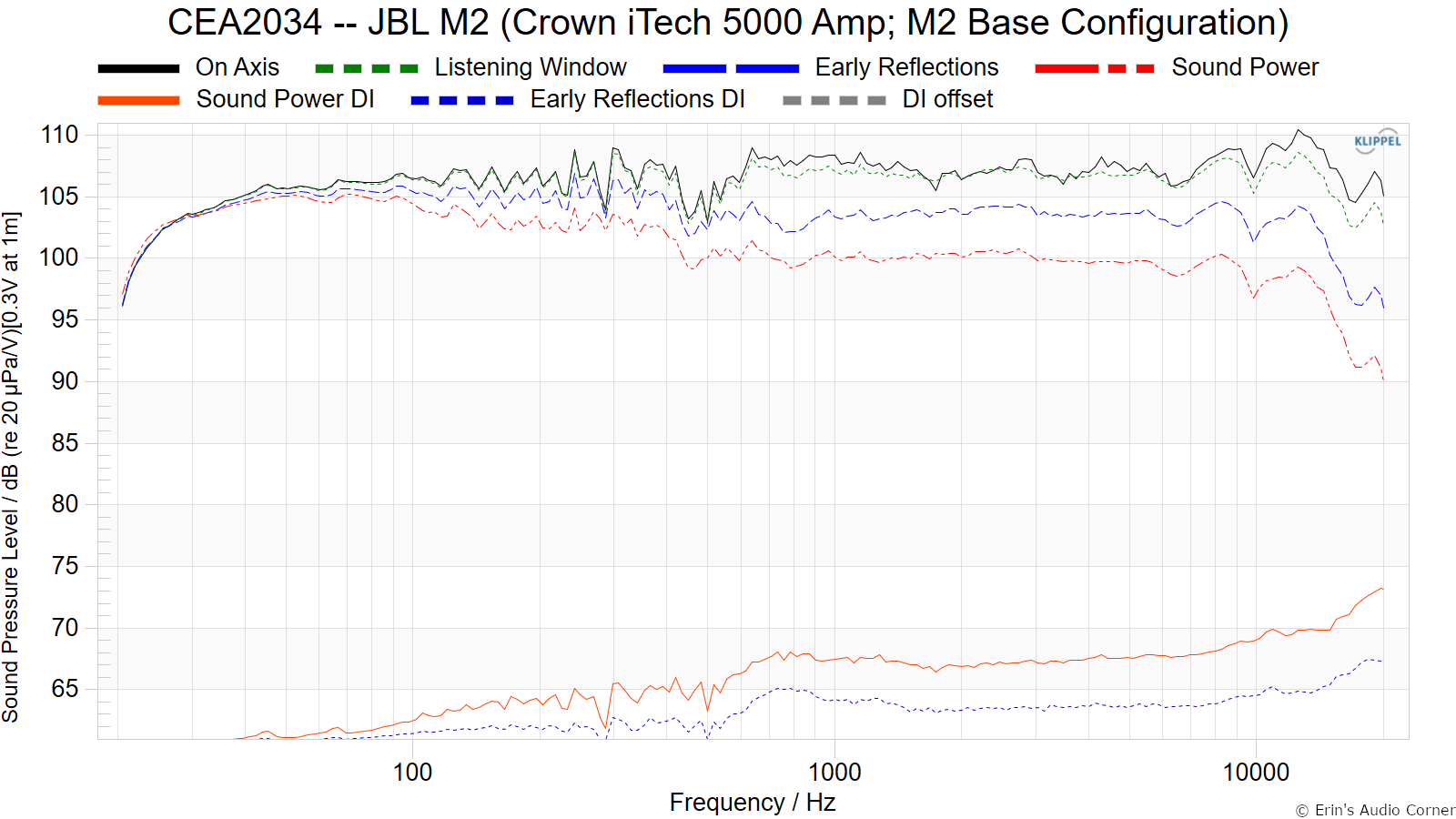

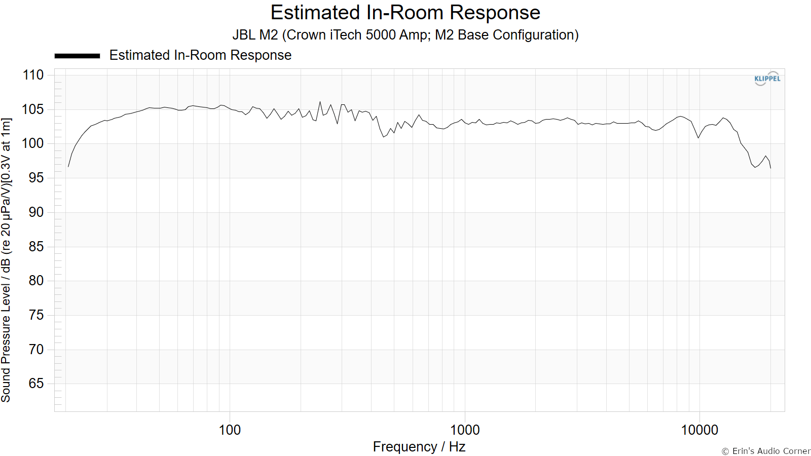

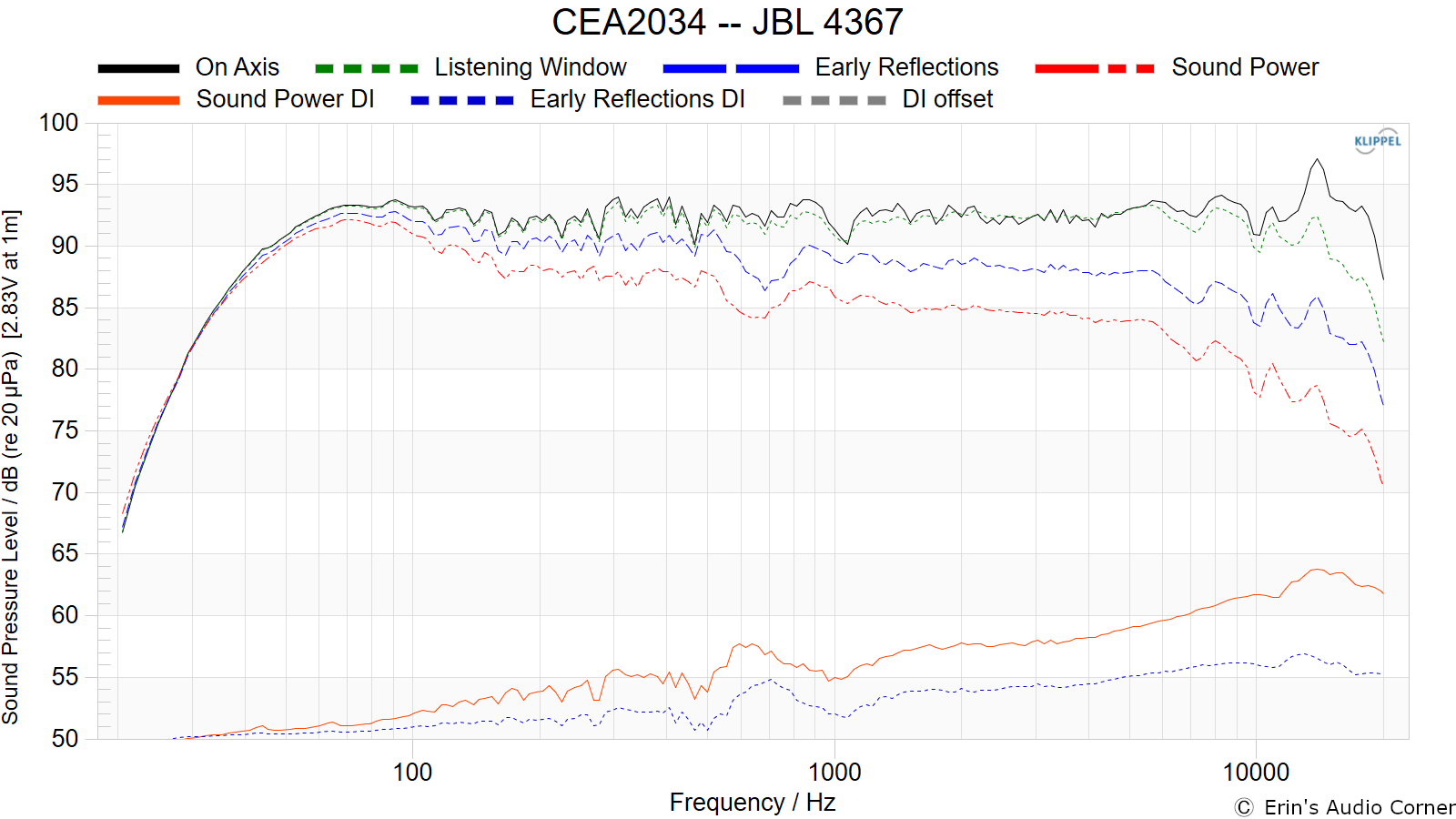

I think I discussed it in the video but if we are comparing directly to the M2 the one thing I noted about the M2 (in the 'stock' configuration) was that the treble was too much. If you look at the estimated in-room response(s) of the two, you can see what I mean.
So, there are two things:
1) The 4367 EIR response trends downward >6kHz. The M2 is flat (until about 15kHz or so).
2) The 4367 has a slightly increasing DI while the M2 has a flat DI.
The combination of #1 & #2 are - based on my experience thus far - the reason why I would likely prefer the 4367, at least wrt mid/high frequency, over the M2. I've said this a number of times elsewhere but it continues to hold true: a constant DI with a flat (or even boosted) on-axis response yields a boosted HF in the EIR which always comes off as "bright" to me.
It's also worth noting that the M2 has a shelf in the midbass/midrange transition where the mid/highs are about 1dB above the bass region.
I'd love to have the ability to ABX the two but that will likely never happen. Based on my experience, I think I'd have to choose the 4367 if I were buying for myself. My buddy who demoed both and purchased the M2 thinks the 4367 sounded horrible. So, there you have... two perfectly different opinions. Of course, speakers aren't chosen based solely on one bandpass region over another. There are multiple factors. One pro for the M2 is simply that it's physically larger and doesn't need a weird stand to get the tweeter (or the line just below that) at ear-height, such as the 4367 does.
I think you might be being fooled by the 0 to 3dB area on the normalized plot and how even it is. When you look at the DI and the vertical line charts it is clear that vertical directivity is being lost quickly from 2K to 1K and below where it is being blended with the woofer.
