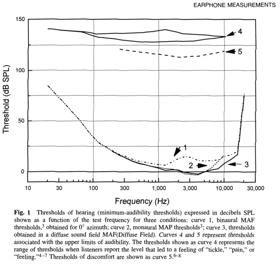

The attached picture shows the human hearing threshold in SPL (sound pressure level).
Beyond 0 dB SPL the average human does not recognize a test tone. Above 120 dB SPL you feel discomfort.
This has nothing to do with bits or noise but with the limits of the ear.
The optical equivalent is total darkness and looking in the bright sun.
So the dynamic range of human ear is 120 dB SPL. In practise it is more like 90 dB SPL as the normal background noise in a quiet room is about 30 dB SPL.
To cover the whole human hearing range a sound reproduction system should have a lager dynamic range.

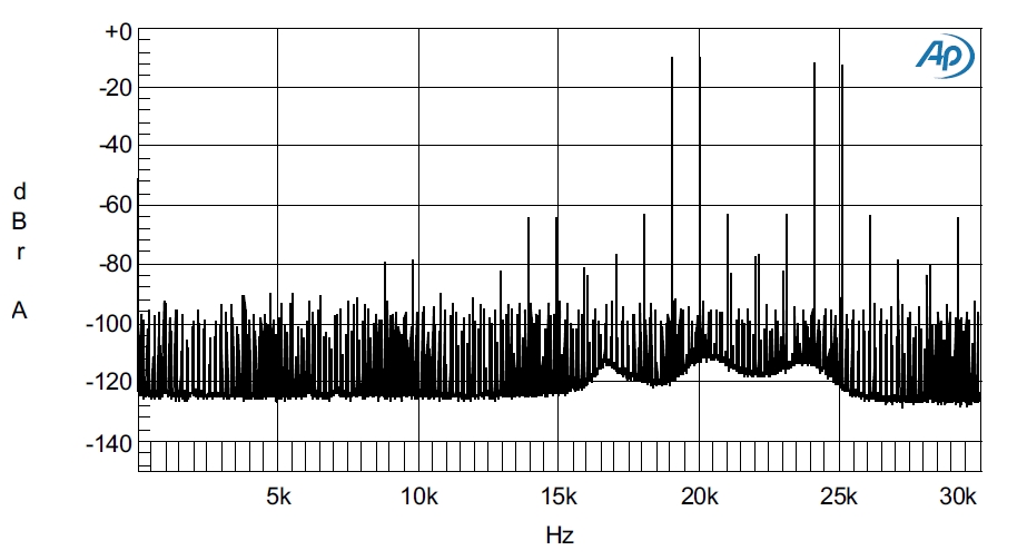

jan.didden said:
Yes, it's a DAC without the filter.
My question was about the anti-aliasing filter before the ADC in whatever produced that graph. There is enough confusion in this thread already!
Images resulting from a poor or missing reconstruction filter are ultrasonic, starting from sampling freq/2. Your graph shows these, but also lots of low frequency crud too. The eye is naturally drawn to the LF stuff but this is irrelevant to the discussion and may confuse others.
I did not produce this myself but as I understand it, a 19+20kHz sine was sampled with 44.1kHz and the resulting digital stream input to a DAC with and without reconstruction filter.
I have no info on the exact setup on the ADC side.
Jan
OK. My guess is that an anti-aliasing filter was omitted, so the ultrasonic images from the missing reconstruction filter then produced aliases with the sampling rate of whatever produced the graph. Given the LF mess, I assume the second sampling was not at 44.1kHz or a multiple - perhaps 48kHz?
