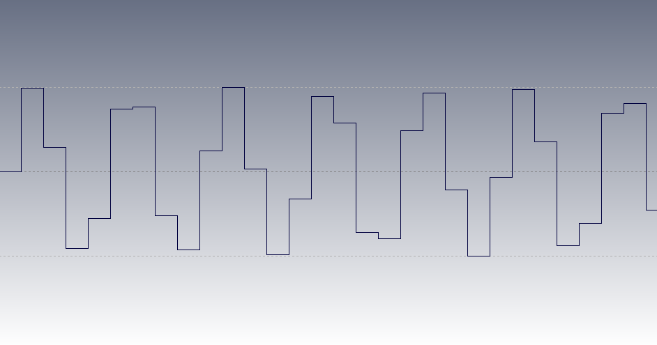

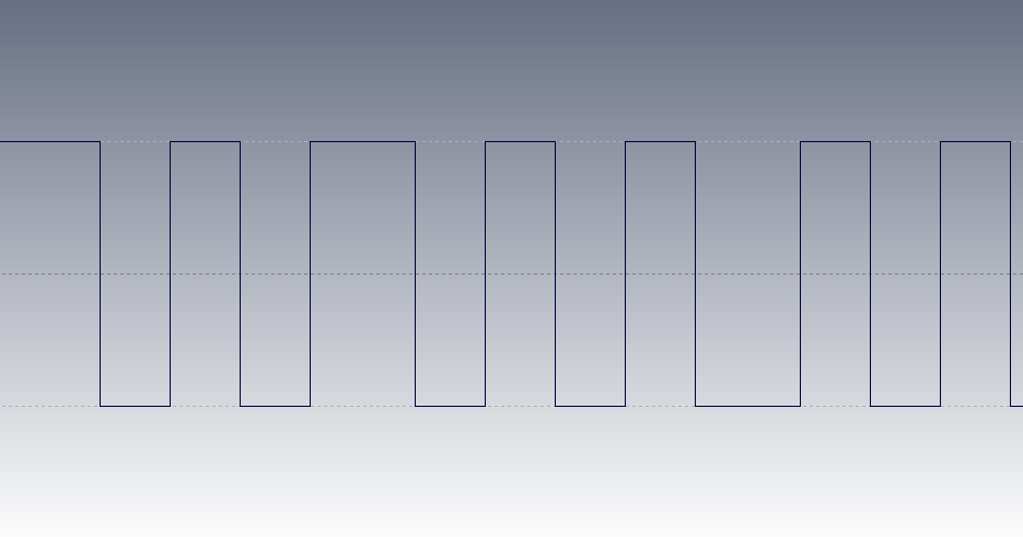

A 44.1 kHz file can not have frequencies above 44.1 kHz.
Let's say it does, just delete them then, wow, is it so difficult!

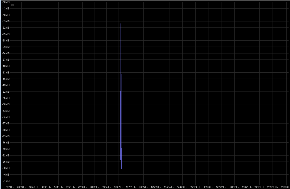

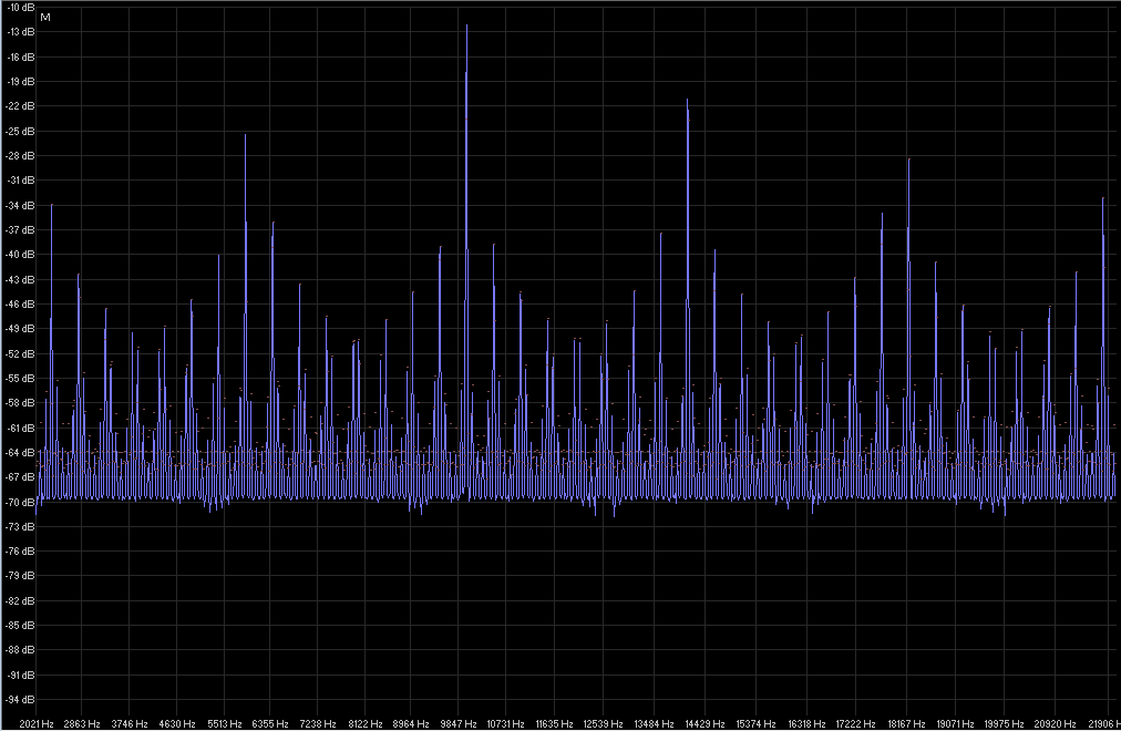

It does inside the digital system.
First, the sampling process creates square waves of 44,1kHz, with harmonics at 132.2kHz and so on These frequencies should be removed by a reconstruction filter, to prevent intermodulation artefacts in the audio band.
Second, if the sound ITSELF has frequencies above fs/2, for example by adding non linear distortion in the digital domain, then these frequencies will alias back into the audio. These aliasing products can not be filtered out by the reconstruction filter.
Iaw: If there are no frequencies above fs/2 in the signal present, then there is only 1 way to connect the sample values together. If there are frequencies above fs/2 in the signal present, then there is more than 1 way to connect the sample values and extra frequencies are generated: Aliasing.
To make this clear, I've made 2 soundfiles with my DAW. One 10kHz sine and one 10kHz square. If everything is fine then these files should sound the same. The first harmonic of the 10kHz square is at 30kHz and no human can hear that. (I hope we can all agree on that.) But as you can hear, the files sound very different and of cause the spectra looks very different to.
To hear the soundfiles change zip to wav.
