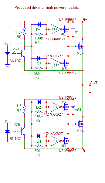

should I rephrase " high side driver circuit using discrete components to drive the gate of the switching device beyond the rails?"
well something like that anyways...
Sorry, try copying and then pasting the link into the browser window.
The circuit is a such as you seek, and it can charge and discharge high capacitance gates, or I should say, it is designed that way. I have not actually built and tested it.
1st diagram
Ok, I went and got them, Here is the proposed high power version. Substitute V1 with a bootstrap diode and capacitor in the normal way.
