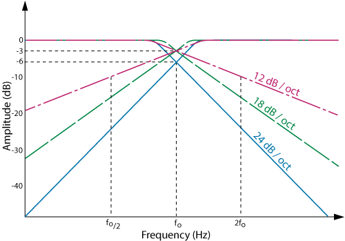

When first-order filter cannot thoroughly eliminate the unwanted frequencies, outside passband, we need second-order to do instead. And the second-order seems to be popular choice found in many crossover designs because it may be sufficient for this task. However, it’s obvious that many hi-end or expensive speakers tend to employ higher orders, such as fourth-order, in these days. What are the requirements for using higher-order crossovers when second-order is sufficient to eliminate the out-of-passband frequencies? When to know the second-order is no longer sufficient and the speakers need higher-order crossovers? Any signs or symptoms?
If out of band suppression goals are met, and good ripple-free summation takes place throughout the xover region down to say -24dB per side, I'd say no need for higher order.....al least on-axis.
If off-axis shows too much lobing due to excessive separation distances between drivers, higher order can help reduce the frequency range that lobes
Personally, I draw the line at 4th order for IIR; I think any order above that needs to be FIR lin-phase. (and even 4th order benefits)

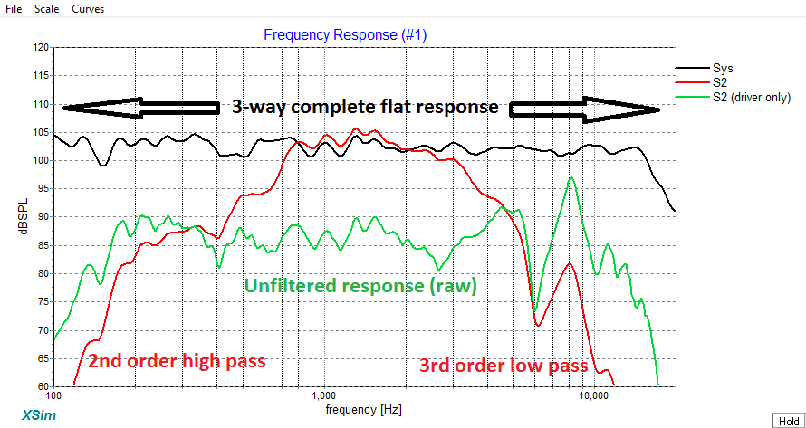

See this example of my lastest 3-way speaker built some weeks ago.
I had to use a mid-range with a horrible breakup above 4-5kHz.
So I selected a 3rd order for the low pass to cut aggressivelly above around 3kHz.
Regarding the low frequencies, the mid-range had a better behavior, so a 2nd high pass was enough.
Each situation will require a specific slope.
