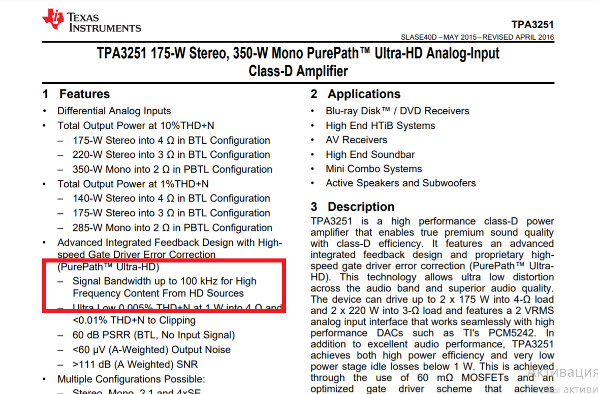

[*]I did not find any ICs on the vendors' shelves that allow output frequencies of up to 130kHz (instead of the typical 20kHz in audio); so we probably have to tackle a discrete design. Is there anything available for our purpose that I did not spot?
See this)))

Sorry, what do you mean by GaN?
Unfortunately limited to 100kHz, but 130kHz needed. Also 1W in idle already, so most probably not the power efficient device we look for.

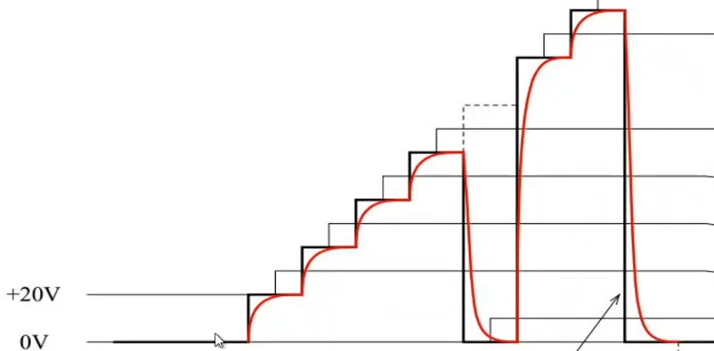

The voltage levels are discrete. The input is generated by a DAC, whose signal needs to be amplified. It looks like this:
The red line is the old design that needs to be improved. Rise times are about 1.5µs, which was improved now with the class-A/B opamp to less than 0.5µs. The steps typically go up, bot not always with identical deltas. It can also go down to a different level than zero Volt after the top value was reached.
Sorry, for screwing up the graphics, it looked good in the preview. 🙂
I hope it is now attached correctly.
