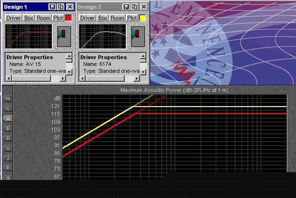

Here we have the AV 15, and the 6174. The
AV 15 is 4 ohms, and the 6174 is 8 ohms.
Both are getting 500 watts. Both are
scaled under "High Fidelity" recomendation.
Since, I'm not talking box size here, why should
I take the AV 15, over the 6174?

It doesn't matter, the rules are the same. A PA sub for example would most likely trade off extension for efficiency. But if the PA sub does need to reproduce more sub bass, we'd need to apply relatively more power down low, which is where more Xmax/driver (or simply more drivers) comes in handy. There's always a trade off in each application and the rules are the same.
The chart is not wrong, but its curves are just estimates. And given the two yellow curves, it would seem BB is taking an even shorter shortcut by evaluating power-excursion limited graphs from an equation or two -- not from its actual models. LEAP 5 or SoundEasy are much better at estimating large signal behaviour.
Best thing to do is take measurements
Those simulations are actually from constant-voltage calculations -- not from constant-power calculations. So at the points were the steady-state impedance of the woofer is at, say, 4 ohms, you do see the output (at those frequencies) given, say, 500W. But at a different frequency where the impedance is not 4 ohms, the applied power is not 500W. At low frequencies in particular, the driver will exceed its motor/suspension excursion limits well before the applied power reaches 500W. A constant-power graph is different from a constant-voltage graph.

f4ier,
I know their estimates, but the 6174 is still leading the
AV 15
Raw Driver 1 watt measurement
6174 = 93.88 dB, 1.489%
AV 15 = 88.45 dB, 0.421%
500 watts 8 ohms 6174 = 121 dB 32 Hz
500 watts 4 ohms AV 15 = 114 dB 32Hz
7 dB is a big ratio, among the two woofers
wouldn't you say.
