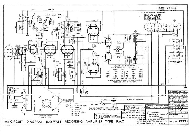

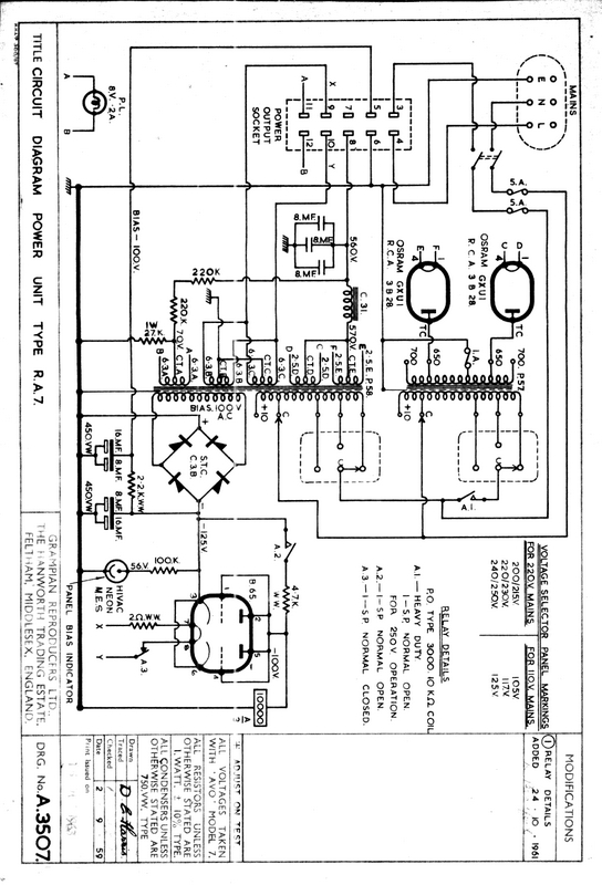

I have found if you want 100watts + The amps use 811a's where used for recording cutting.. Russian or USA made 811a last a very long time. The output transformer is 1.5 K or 2200 P-P Any 100 watt amp is costly to make. Using kt88/6550 you need to replace tubes very often,. the Russian 811a can last 20 years if you look after the tubes Circuit won't load will try later
811 a circuit
you need to leave out the parts for record.
I use a solid state Power supply
